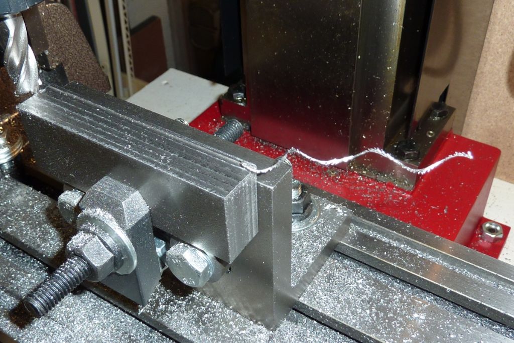

04/06/2013 00:15:43
Posted by Chris Heapy on 03/06/2013 23:38:37:
Another way - possibly better than using the vice - would be to mount that piece of steel lengthways along the bed, standing on a packing piece and use a clamp at each end, then use the endmill flutes to cut both sides of the workpiece without having to re-mount it. The result will be as accurately parallel as your machine is capable of milling.
For the 'flip', just mill the piece as usual held in the vice, then rotate it 180deg (like a propellor blade in front of you ). Any inaccuracy would be equalised and the result (should) be a parallel bar.
I like the idea of mounting it on the bed. It seems so obvious when someone points it out to you. There are just so many ways of doing the same thing. As I said to Andrew I'll have to leave it until the weekend now. sad
I understood what you meant by the 180 flip but couldn't get why it would equalise out any inaccuracy. Say for example (with exaggeration) the right side of the vice base was 0.1" higher and you were machining a piece 1" high then after the first side was machined, the piece would be 0.1" larger at the left end. Then when the piece was flipped in the vice, wouldn't the right end start off 0.2" higher than the left. If this was now machined until flat, wouldn't the piece still have a 0.1" taper left to right? The penny will probably drop soon.
Gary
03/06/2013 23:47:20
Andrew, I think you're right about the swarf. It was on the last cut and as the total width of the two parallels was ~19mm and I was taking cuts of 3mm the last one was ~1mm. The end mill was a no-name one from RDG and as Dormer 12mm end mills seem to be about £30 it would probably fall within the definition of 'cheap'. I might have a go at checking the tram at weekend.
Gary
03/06/2013 22:11:29
Thanks for the input Chris & Neil.
I did cut it dry Chris, as I said above I've not got round to buying any soluble yet. I'll try some more test cuts when I've got some and see what I learn. Also, your eyes don't deceive you, the finish isn't good. Material was bought as EN1A.
Can't get my head round your "flip it 180 deg" idea at the moment. It seems to me that it will still taper. I'll think about it a bit more.
I think I just need more experience with different bits of steel. One of the chaps in the engineering workshop at my place of work told me a while back that bought in materials had become a lot more variable in recent years.
Gary
03/06/2013 19:06:16
Posted by JasonB on 03/06/2013 18:51:56:
Assuming you took your first 3mm cut off the front (towards you) side of the work what direction was the work traveling in?
Oh it also tells me you need a vice.
Edited By JasonB on 03/06/2013 18:52:14
Work was travelling right to left (conventional milling). I've been very careful to avoid climb milling until I know better what I'm doing.
I have a vice, it is further along the table. I was using Harold Hall's technique for making a parallel by using two cylinders bolted to the angle plate. Then take a light cut off the top of both cylinders and mount the workpiece on top. I think it is supposed to ensure that the two sides are parallel to a much better accuracy than just mounting in the vice.
Gary
03/06/2013 18:48:12
To throw a further query into the mix, one cut resulted in this:-
I'm sure this will tell most of you quite a lot, but it didn't tell me much apart from something might be wrong.
Gary

03/06/2013 08:45:05
Hi,
I've been making a basic pair of parallels in a size that my cheapo set didn't contain (1.25" ). I used a piece of 3" x 3/8" flat steel. When I sawed the bar down the middle I left rather too much to mill off each piece (approx. 0.22" ). I have finished them now but was wondering if you would have used a different method for removing the surplus on the mill as I'm just learning milling. I have an X3 mill and took repeated cuts with a 12mm end mill of 3 mm wide x 0.5 mm deep at 500 rpm with no coolant and hand feed of about 100 mm/min. Yes, that is a lot of winding back and forth and I realise that I should have cut more off with the saw but would I have been better off using different cutting depth, width, feed or rpm? I've read as many threads as I can find on the subject and also Tubal Cain's 'Model Engineer's Handbook' and Harold Hall's milling books. I know people say the mill will let you know when you are pushing it too far but this is difficult for a beginner to judge.
Thanks for any suggestions.
Gary
