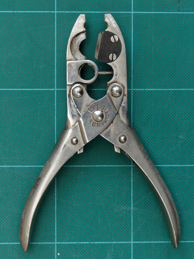

Thread: What Are These Parallel Pliers?
12/08/2018 13:52:14
Posted by Arthur Sixsmith on 12/08/2018 13:31:00:
They are round leather belt pliers I have two sizers of these in my tool box. I was a industrial sewing mechanic all my working life. Arthur
Thanks Arthur, so my inspired guesswork was right. I do have two singer machines driven by round leather belts, though smaller in cross section.
And also thank Michael, yes I know they are Falsing, I just can't type blush
The handles are pretty much identical to the various Maun pliers I own, so I wonder if there was a tie-up historically between the two companies.
Edited By peak4 on 12/08/2018 13:53:08
12/08/2018 13:23:32
Too late to edit the thread now, but I did wonder their use for cutting HT leads and fitting some sort of early end caps.
Bill
12/08/2018 12:51:40
Another "Please ID this" thread.
I've just picked up a pair of unusual parallel pliers, with handles in the style of our own Maun Industries ones, but with jaws I've never seen before.
I'm guessing they are to cut and pierce some non-metallic tube or belt.
The hole through the cutter, and punch section is about 1cm, or probably 3/8" clearance since they are American.
Parallel Pliers-1
Parallel Pliers-2
They are made by Fassing Products Co. of New York
Parallel Pliers-3
I'm wondering if they could be for cutting round leather belting, such as that used on old sewing machines, and piercing the ends for the joining clip.
I can't find much reference on the net.
Thanks
Bill
