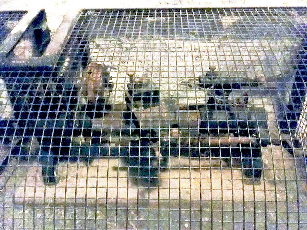

16/10/2017 18:39:15
re-jigged the lighting...might help identify it?
