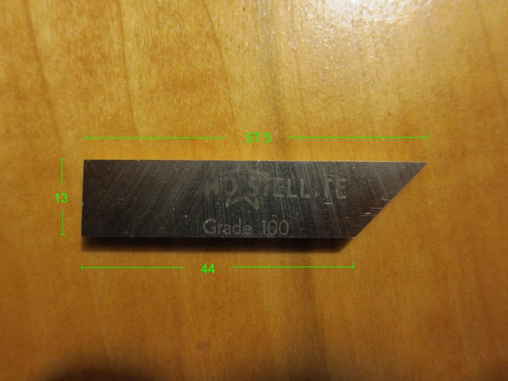

22/04/2014 21:16:07
Hi everybody,
it's seems to me that Neil's guess is pretty close ( I was "looking" at the bit in the wrong way, because of the markings, as my pic shows...), only argument against it is that those scribers often have a swan-neck form, but some seen on the web are like this one.
Clive, I thought of it too, but there are no relief angles ground on the bit (perhaps they are not needed for wood?) and there's no positive way to reliably retain it, in case it was rotating at high speed, as is usual for wood.

21/04/2014 10:55:15
Excuse me, Clive and Thor, I just forgot smiley...
5 millimeters thick
Massimo

21/04/2014 09:33:44
Hello everybody,
a few days ago, I purchased from eBay a bit of Deloro Stellite (grade 100) with the intent to use it on my lathe.
Just out of curiosity, I'm wondering if some member of the forum can identify its original purpose, as I'm not sure it was intended as a lathe toolbit.
Cheers,
Massimo
