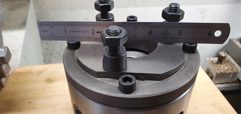

17/06/2020 14:48:54
I need to make a 5" diameter backplate like that in the photo (but without the protruding cap head screws) but cannot decide what material to buy. Despite the inevitable mess I'm leaning toward cast iron in case the milled recesses around the rim would affect the stability of mild steel, but have no idea if grey or ductile cast iron would be best.
Thanks for any advice
