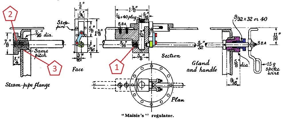

Is the thing at the bottom left of the photo below a part of the regulator of the first type (smokebox mounted)?
The steel shaft looks like "regulator shaft" however the rest is mystery for me... It just doesn't much with the arrangemens i've seen on the internet.
Anyone have these ME volumes 107 and 108 for reference?

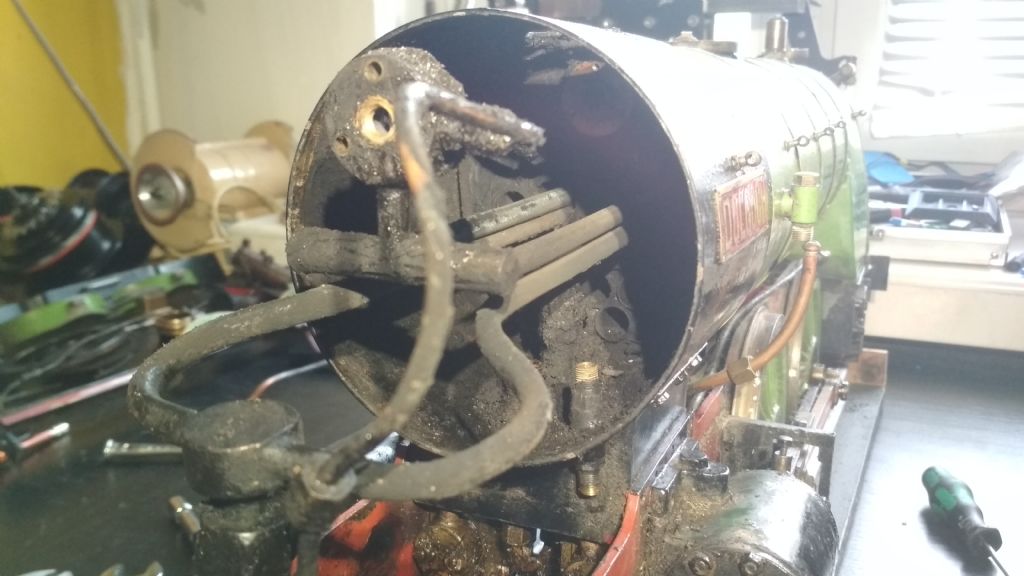

Dear Engineers,
by scrollin through the web i've found partly build Britannia locomotive, 3.5" gauge, that was described in Model Engineer magazine. I believe in volumes 104 to 109. I've seen a few different builds of 3.5" Britannia locos and couple of things catched my attention: the boiler, regulator valve, superheater. The one i'm talkig about is here:
And it doesn't have holes on the top for the water feed valve like in this example the holes are marked 1 & 2 below:
And it doesn't have the element protruding from the boiler (RH side) - number 3 above. This element looks like a support/pivot for the linkage of the steam regulator valve located in the "cube" in front of the smokebox - number 4. Not mentioning about superheater (for sets of superheating pipes).
However in the loco in question (first two photos) the boiler is different, not many bushings for valves, etc. in the cabin. And boiler back head arrangement:
I found another example of Britannia in 3.5" gauge and here:
In the above example the superheater is simpler and there is no regulator valve in the smokebox. Boiler arrangement in the cabin is even more different. I'm confused. Were there different options described in Model Engineer magazine?
Another question: the offered boiler is naked: no fire door mounting holes, no regulator handle support holes and as per description it was proffesionally made, tested and have all the papers (though outdated). Does it mean it has to be drilled to mount all the necessary stuff? What about the certificate then? Is it normal practice that the boiler ws tested, certified and the some new holes are made? Much confused:/
Please share you thoughs on that. Is it worth to thing about that project?

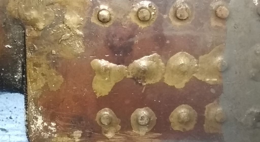

Back to the boiler: it is all silver soldered. Stays are also silver soldered. The photos are taken before i finished cleaning.boiler_stays_outside.jpgboiler_stays_inside.jpg

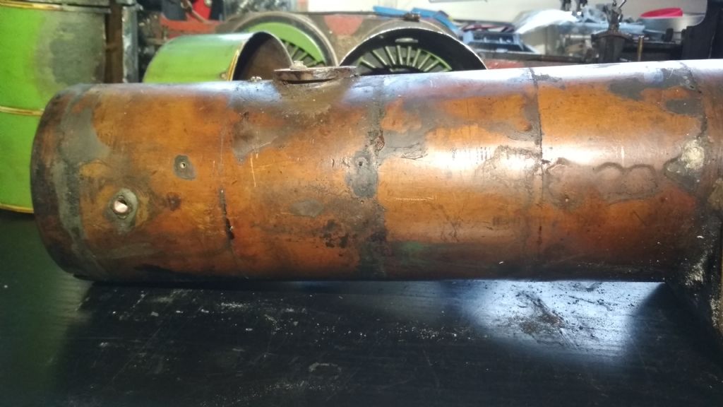

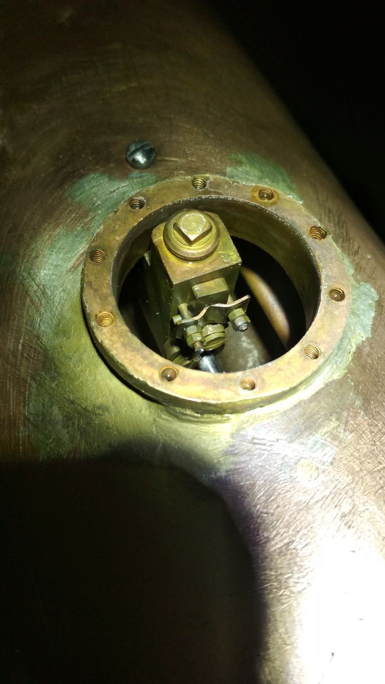

Hi,

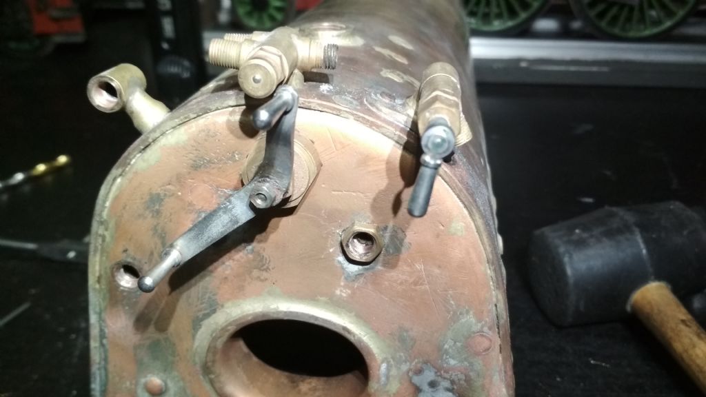

i'm struggling trying to figure out how regulator valve assembly is made and how to take it apart. I'ts kind of slide gate valve as i can see in the steam dome. But i do not know how to diassemble it. There is some backlash in the linkage which connects long stainless steel rod going from the handle in the cabin with sliding element that open steam channel. Pls, see the photos - regulator closed:
Regulator opened:
It looks clean as it is after soda blasting. However i'd love to have better response on regulator by eliminating the play in the linking elements.
From the smokebox it looks like this:
I'm affraid steam outlet is fixed to the boiler body for good:/ These three small threaded holes are for superheater assembly:
And this is how it looks like from the cabin side:
Unfortunatelly i have no book and it is hard to guess. I don't want to use too much force.
Can anyone chack in the book what is the design arrangment? The basic question: is the regulator designed to be repairable?

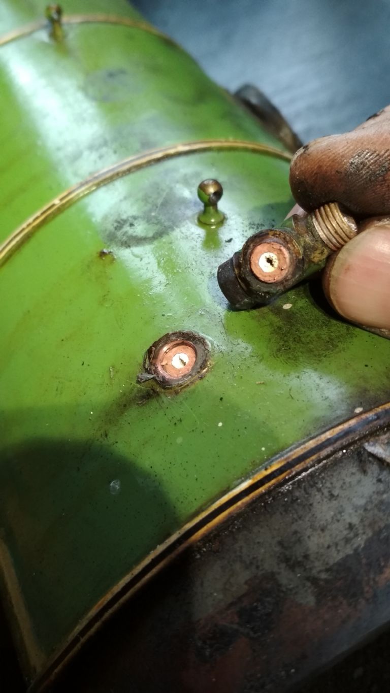

And some broken fitting - boiler water feed check valve:
BIG QUESTION: how to remove scaling from the inside of the boiler? It is not bad, but i'd like to descale it / remove "limestone". I know the broken feed valve is showing a lot of scale but i've check inside with boroscope and looks good. I have a problem with regulator but i need to start new thread as it is quite different story.

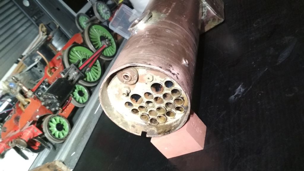

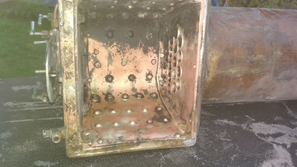

Guys,
by telling "it was soflt soldered" i was reffering to the WRAPPING only not the boiler itself Boiler is silver soldered for 100%.

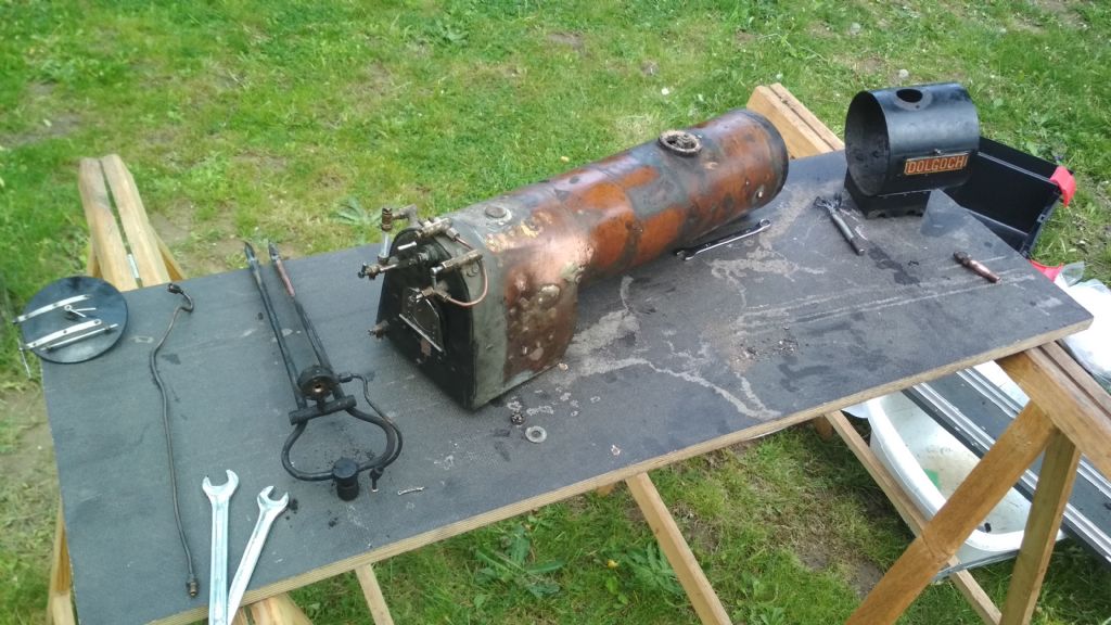

Here's the boiler AFTER i removed the wrapping brass sheets. The below photo was taken during the cleaning. You can see, at the lower right corner of the firebox crown fundation (is it good naming?) - it is soft solder. It looks like someone was repairing that? On the forum i heard that was/is the normal practise. Is it?
Here is the boiler after i cleaned it:
For cleaning i used soda blasting technique - never heard someone using it for boiler cleaning but it is completely harmless for boiler elements and solders. I had weak compressor available and the cheapest "sandblasting kit" so it took a while to clean it and the cleaning process for sure can be stronger when using better gear, however i'm pretty happy with the result. What you think? The good thing about soda is it is not aggresive, user friendly (eventually you can brush your teeth or bake a cake with it) and after cleaning just put boiler in water to dissolve any soda leftovers.
Another view - preparation for cleaning:

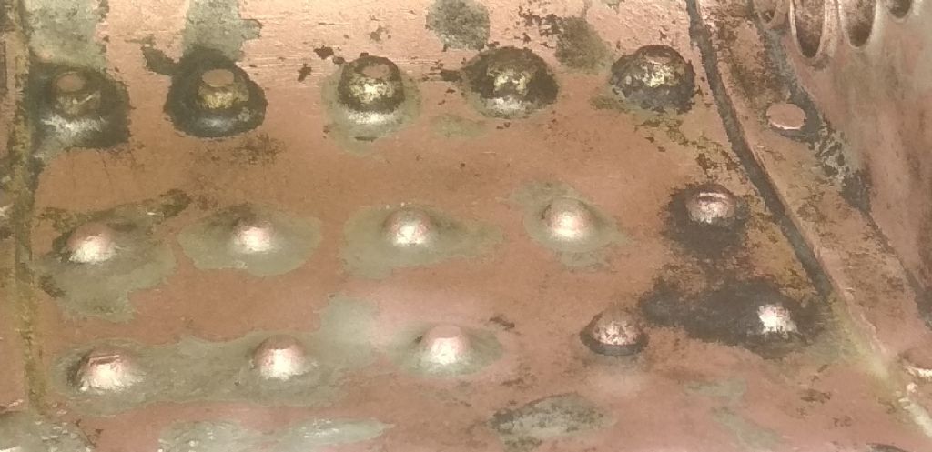

Inside of the firebox - do you thing these whiteish thing on the stays are the signs of leak?
Smokebox side after cleaning:
Thank you for explaination guys. If i manage to find 1mm thick insulation material i think i'll try to use it as i need to make new wrapping anyway. Smokebox is ordinary mild steel. Maybe i'll make slightly bigger one to accomodate O.D. increase of the boiler?

in order to take the boiler for cleaning and inspection i hade to take all the wrapping off the boiler shell. It turned out it was soft soldered (grrr!), including the bands "holding" wrapping brass sheets sections. To desolder them i had to head them up to the temperature at which paint came off... Not only that: firebox section was badly bent and damaged during this job.
This is my first loco and i don't have experience with sheet metal work. Could you advice me how to make a new wrapping? rounded sections are fairly easy - i'll make cardboard patterns to make all the necessary holes (for water check valves, chminey, steam dome, etc.) however the firebox section is a nightmare.
Another thing is i found the builder didn't "lined" the boiler. I don't know if it is a good word for that? I'm reffering to that thin insulation layer wrapped around the boiler shell, under the final metal sheet wrapping. I know it is to reduce energy losses and i'd like to use it when making new wrapping. However that insulation has thickness... Could you point me to the source where i can see what material is usuallt used for that? And what thickness should i use. What worries me is the fact that smokebox O.D. is now equal with original wrapping (brass sheet ca 0.5mm thick). If i add, say 1.0mm thick layer it will increase overall O.D. of the boiler by 2.0mm and it will not be equal to the smokebox O.D. anymore.
What you think about that?
