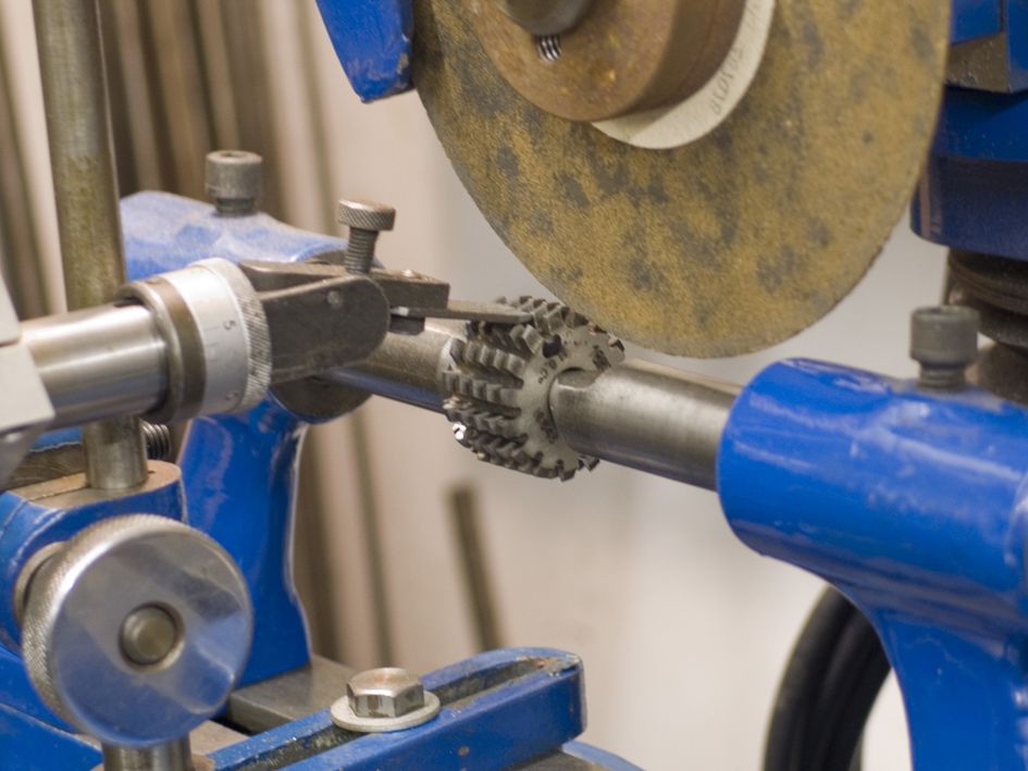

Thread: Union T&C grinder Wiring
15/12/2017 23:56:13

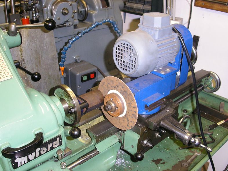

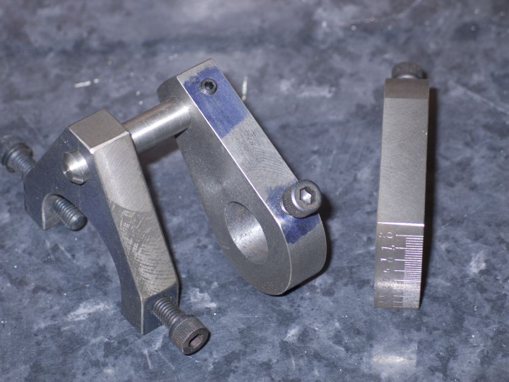

I made my own angle setting gauge for the Union grinder, I can let you have the drawing if you feel inclined to have a go at making it.

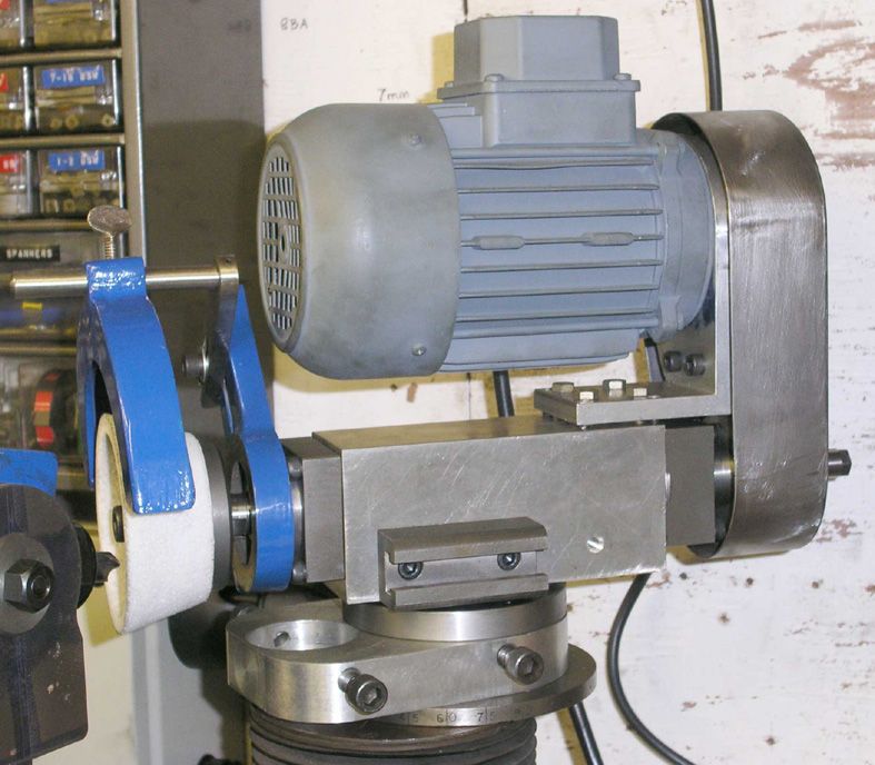

I found the original motor to be unsuitable for my use due to its speed limitations, so I designed my own grinding head for it. This unit will also fit onto the Myford super 7 lathe and can be used for cylindrical grinding as well.

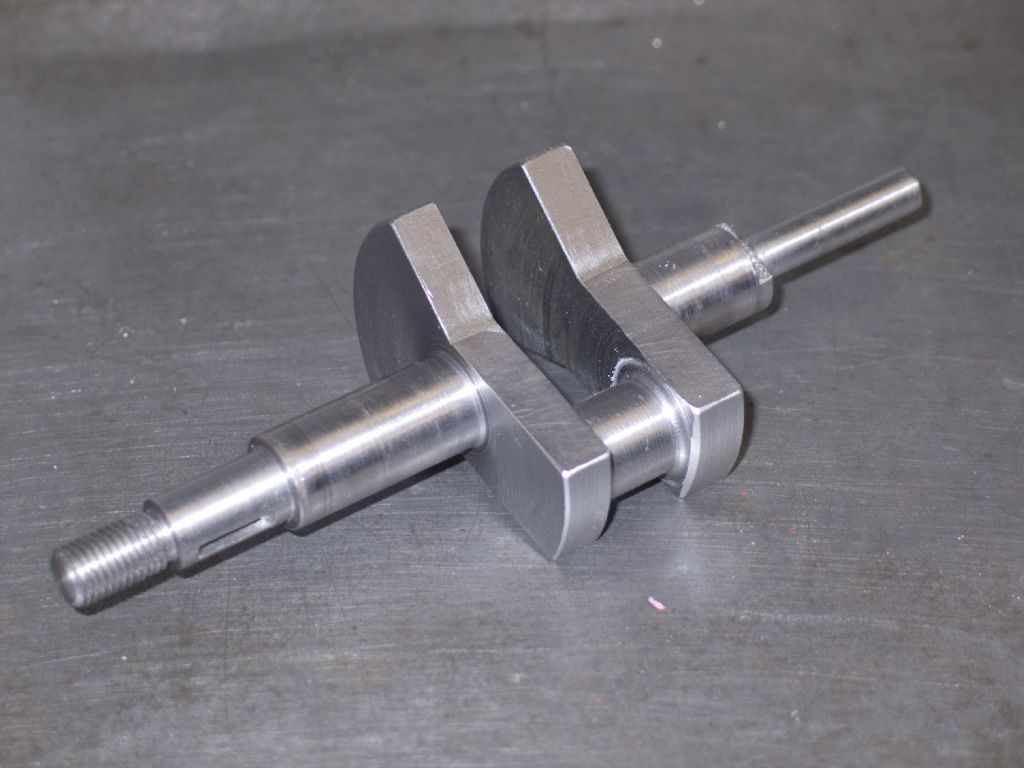

Here it is grinding the big end journal on a model engine crankshaft.

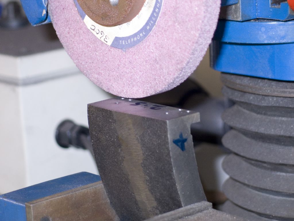

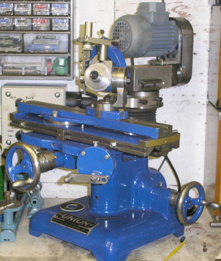

The Union gets used for all sorts of jobs, once you get it up and running you will think of plenty of new uses for it.
Gear Hob sharpening.
Four Facet drill grinding
Surface grinding
Phil
