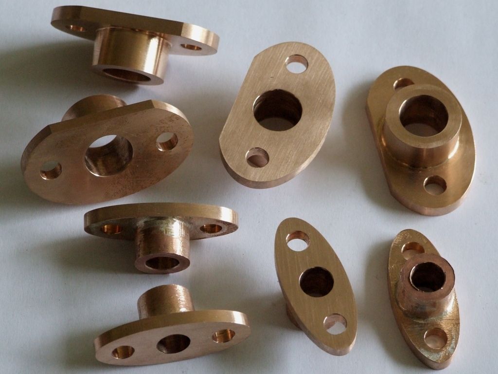

I've got as far as I can with the piston and valve rod glands for my traction engines:
The piston rod glands (top) are finished. But the valve rod glands (bottom) are still rough on the inner faces. I haven't machined the cylinder yet so I don't know exactly what diameter the mating recesses will be. So finishing will have to wait a while. Here are the piston rod glands in situ, with a small clearance on the slidebars as per full size and exactly as the CAD model shows:
