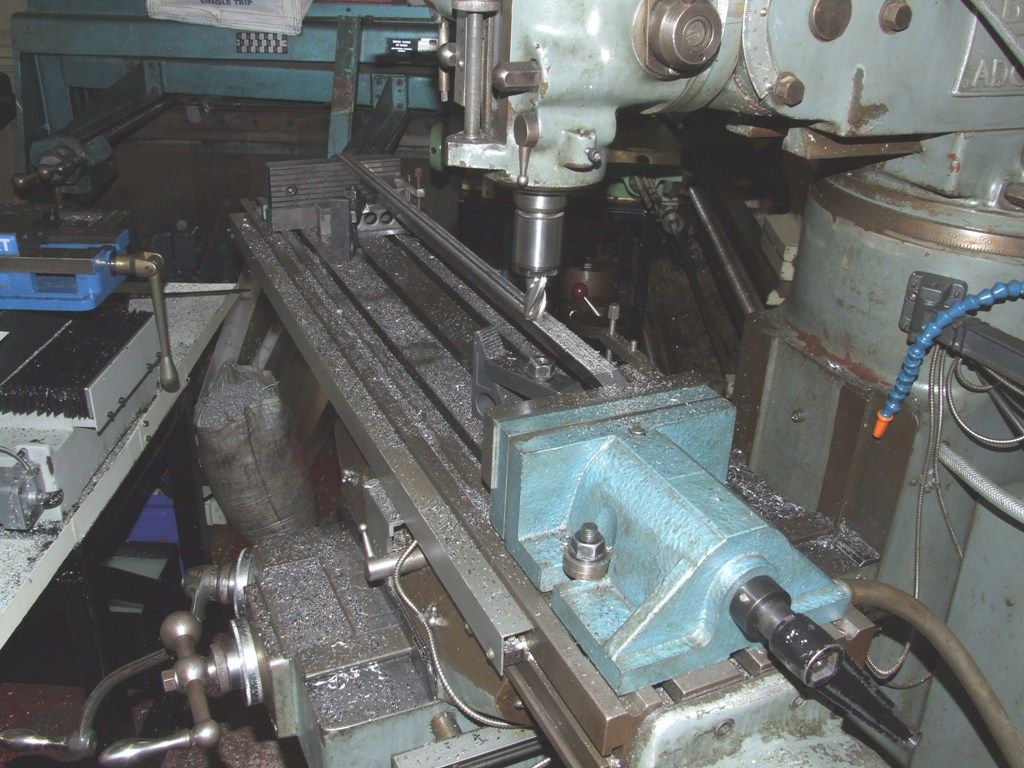

Not me. On the Bridgeport and CNC mill I mostly use the Tormach TTS system. My two main holders are 6mm and 10mm side lock, used with carbide cutters with no flat. They're simple and have a short overhang so one can run the cutters hard, note the blue swarf:
