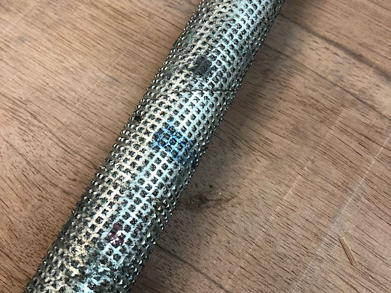

13/05/2020 15:06:33
Here’s a pic of the roll in question
it doesn’t need to be wound round a straight stip of it would suffice 504f8a58-64de-40b8-9d66-4feb683f0658.jpeg

Thread: Cheese grater strip/band
12/05/2020 19:37:36
Brian
the prongs are too long for this application
ill try and get a photo of one tommorow off the press.
the zester type of strip is thin stainless with a grid of square punching from behind making little pyramids of sharp points which grab the roll
12/05/2020 16:59:55
Not sure how to word this
i have 10 shafts 20mm dia and 1200 long made of alloy and they had a strip of like cheese grater/lemon zester type material wound round the shaft in a spiral.
this is the take up shaft on a printing press for a wash up roll which is like very strong kitchen roll..the operator winds the material round the shaft and the rough surface grabs the material and allows it to be rolled up on the discard roller.
the zester type stuff had fallen off them all
ive knurled a few of them to see if that works..with some success
but the operators want it like original.... really grabby..
where could i get such strip material ?
Edited By Ian Parkin on 12/05/2020 17:00:27
