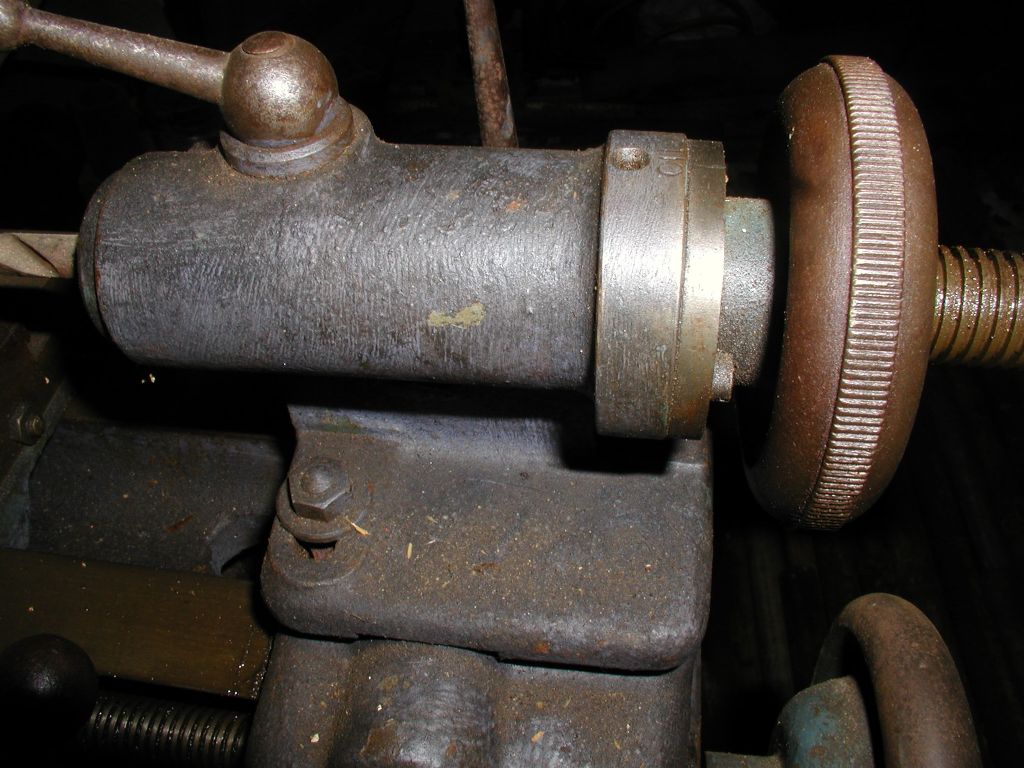

16/01/2011 14:48:33
Hi,
      well just to get you more confused, top pic Myford, Bottom pic Drummond.
The manufacturers plates are below each.
Sorry for pic quality, but they are under raps at the moment and a bit hard to get to.
Regards Nick.
P.S. The Drummond one is the same type as Nobby's one.
Edited By Nicholas Farr on 16/01/2011 15:01:55
