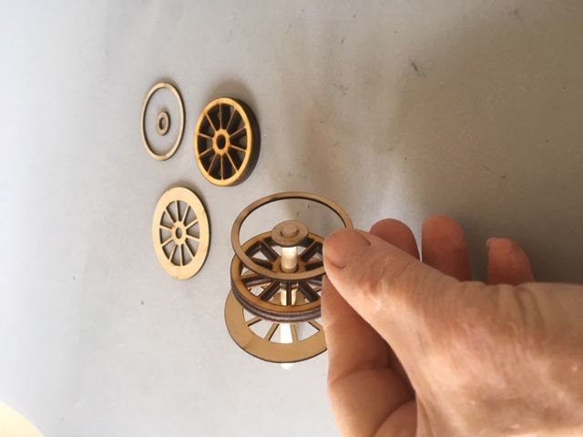

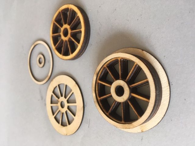

As with the previous tender wheels , we are making the laminates up on one of the axles , taking care to minimise the glue and get none on the surfaces that show . Notice that these wheels have an additional front hub disc compared to the tender wheels .

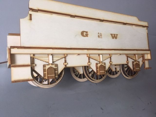

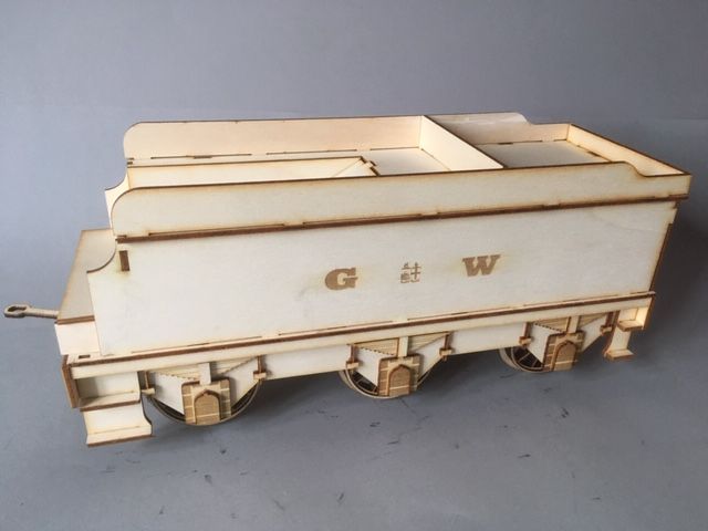

Lower shot of the axle box detail . Quite effective and appears " busy" enough to look believable .
GW is pre etched on the Tender sides , although this could be deleted or changed .
27/04/2020 17:15:55
Tender finished apart from a few small details like the water tank dome and coupling hook .

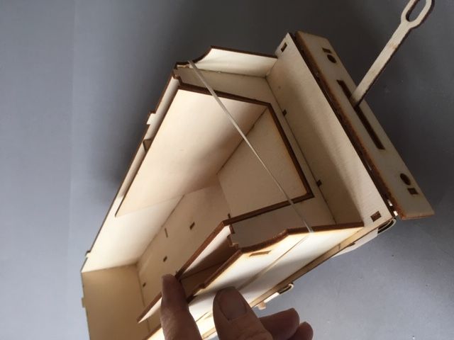

Creating the footplate that is the forward most part of the tender and showing the sides of the tender being glued in place .

Anyway , you get the idea , The two upright frames support the coal hopper on the inner surfaces and the tender sides on the outer . Again , the tabs make this section obvious . You will see in a bit , that the outside of the tender has been etched with "GW" to add a little more interest , I haven't tried staining any of the prototypes because I liked them in the raw state , but I would be interested to see what somebody with experience in that area could do.

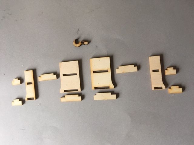

Here are the nice little details for each axle box . The laser cuts the parts first , then re visits to do the etching . Keeping as much of the model in wood enhances the final appeal .

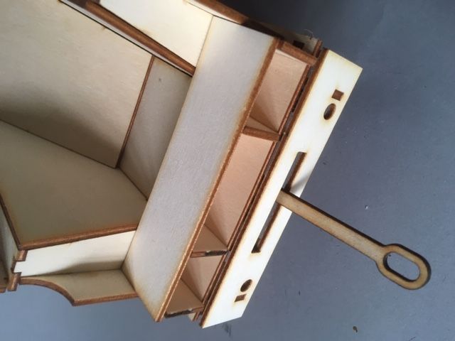

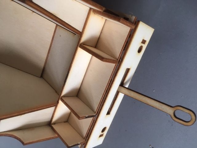

img_2178.jpgThe wheels have been mounted on their axles and each axle sprung into place between the outer frames. The hook for the loco coupling has also been glued into its precut slot . End plates have also been glued on , these also have tabs to avoid confusion . There will be more detail added in the following pictures . This will be a kit that you can build straight from the box , or embellish it to take it to a more advanced level . The aim from my point of view is make the experience smooth and flowing , so that it can be enjoying rather than frustrating .

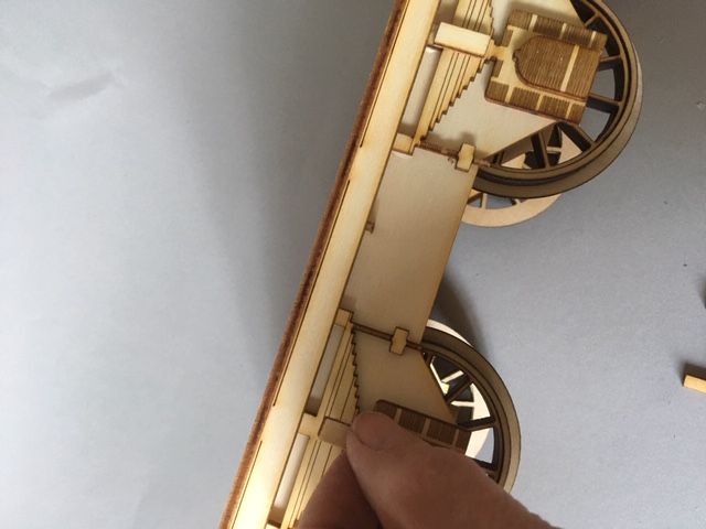

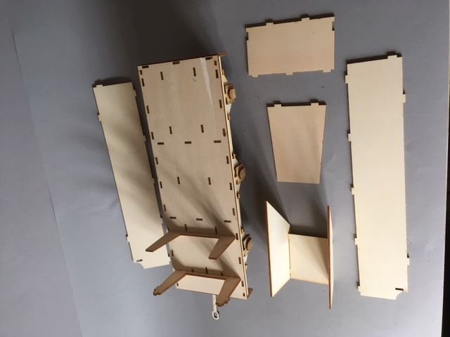

img_2177.jpgWhat we are looking at is the underside of the base plate The long frames support the axles and the cross frames keep everything aligned . You can see how the two outer valance strips just slot in here . The outer frames have holes for the end of the axles but the outer frames have enough "flex " in them , even when glued , to allow you to spring them apart and pull out each wheel pair and its axle.

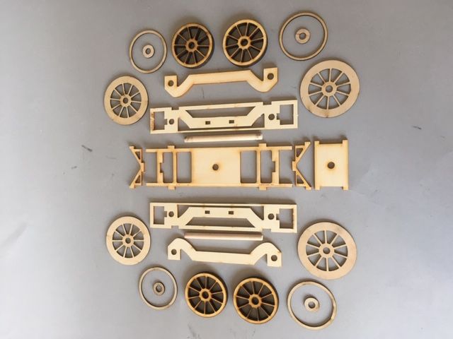

So here is the tender base and axles frames . The valence is on the outer most . On the right end is the hook and coupling .

Thanks Harry , I will attempt to do the whole build in a few days on and off. Ive decided to make all of the kits with no backing on the parts . What I mean is , they will not have to be released from a large sheet of material so that the build goes more smoothly without having to tidy up each piece and spoil the flow.
The parts will be sub divided but ready to go in different labelled bags . img_2176.jpg

img_2175.jpgThis is how the wheels assemble , I actually used one of the axles temporarily to align all the holes while I glued the layers together , Start with the flange at the back and work forward using tiny dots of glue that wont ooz out every where . For the best effect choose the most laser burnt sides to present to your audience .
