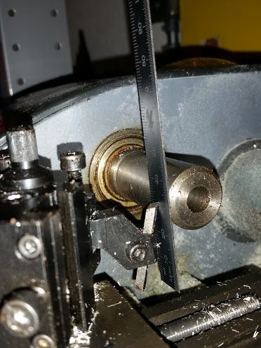

06/12/2018 22:28:02
There are a few ways that a lathe tool can be set to centre height.
One way is to face the end of a piece of metal held in the chuck. If a pip remains, the tool is not at centre height. Retract the tool, turn off the lathe, adjust the tool either up or down by about half the pip diameter and try again until no pip remains.
Alternatively you could use a steel rule trapped between the tip of the tool and the workpiece. With the lathe off, hold the rule vertically against the workpiece, gently (so as not to damage the rule) feed the tool in trapping the rule between the tip of the tool and the workpiece. If the rule leans towards the back of the lathe, then the tool is too high, if it tilts forward then the tool is too low, the rule will be vertical when the tool is at centre height .
You could also consider making a centre height gauge. Not only would you end up with a useful tool, but could also be a worthwhile learning experience. Geo Thomas described such a gauge in the "The Model Engineers Workshop Manual" a book well worth seeking out. Hemingway also do the gauge as a kit seen here
Clive
