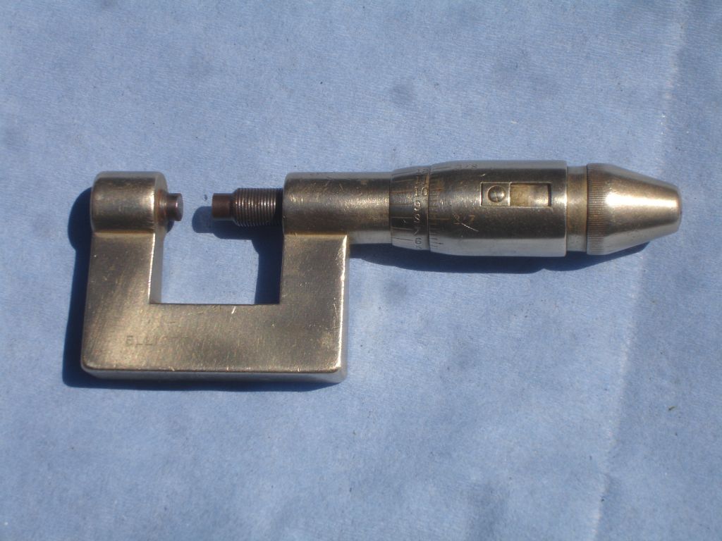

Thread: Unknown Micrometer make
04/05/2021 11:08:33
Neil, I have a mike with a rectangular frame which is an "Elliot" make, but the barrel is different. dsc03646.jpg
