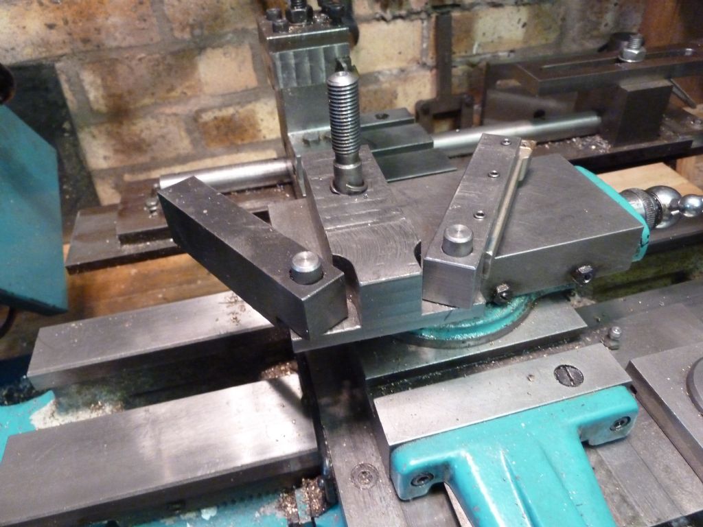

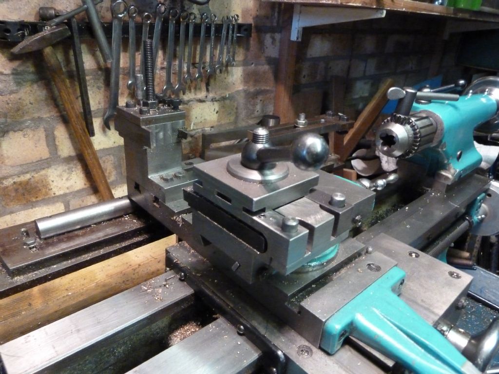

p1040176.jpgThis is my toolholder based on the Pratt-Burnerd design p1040179.jpg

Hi Chris ,A dowel pin in the side of the tool post with a locating hole in the tool cartridge would solve the repeatability and the location issue.I have a dixon type tool post and I find that my design is quicker and uncluttered on the top and this type of holder is more ridgid.

28/08/2019 19:46:25
The advantage is that the tool cartridge is tight onto the topslide and gives ridgidity.I made a toolholder which is in my album which is based on the Pratt burnerd holder.Mine, one has to pack the tool in it's holder to centre height but once done your there and unlike this design the holder can be removed and replaced as before and cannot move in the toolpost.I like the toolpost Chris.
