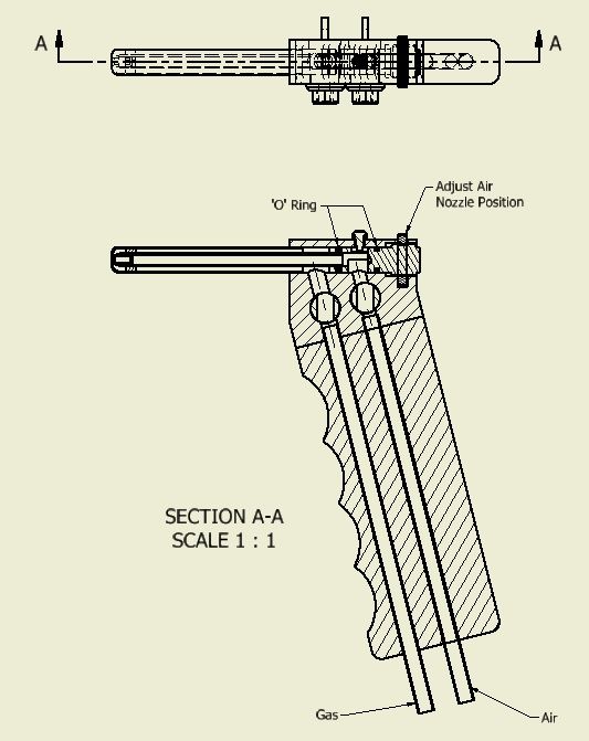

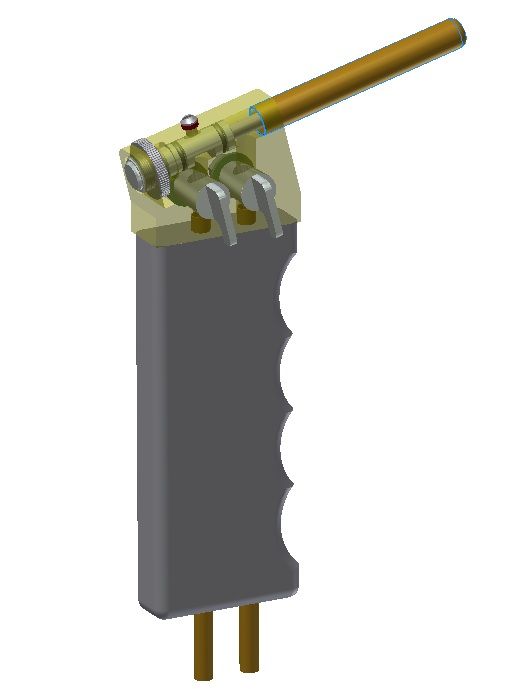

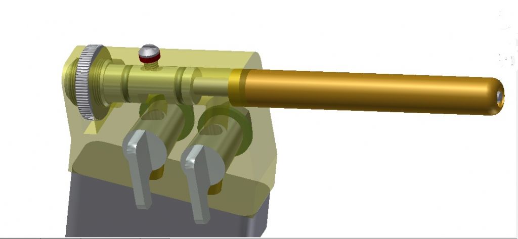

07/10/2012 16:46:09
Michael, thanks for that resistance soldering link, looks a very useful and precise soldering technique.
For fine precision silver soldering I will try the suggestions above but I though I would play around a little with a propane / air design based on the info provided by Neil. This is what I came up with, any comment good or otherwise appreciated. Not all details worked out yet, just playing around with ideas.
Provisional Drg
3D view 1
3D veiw 2
