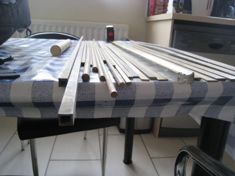

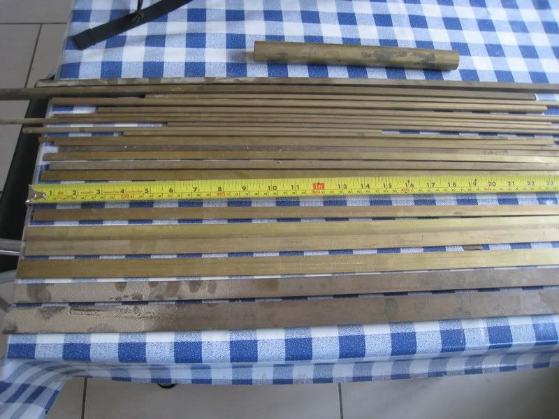

Great thanks I think I've found it. Just need an idea of price. Its a mixed bag of brass stock, all small stuff ranging from 4mm to about 25mm wide flat stock, 5mm or there abouts round stock. All these are 2 feet plus long. Theres also a piece of solid round bar about 1 inch by 10 inches long. Any idea roughly what I should be asking for it? It's not really woodworking materials so I'm a bit lost.
Thanks in advance
