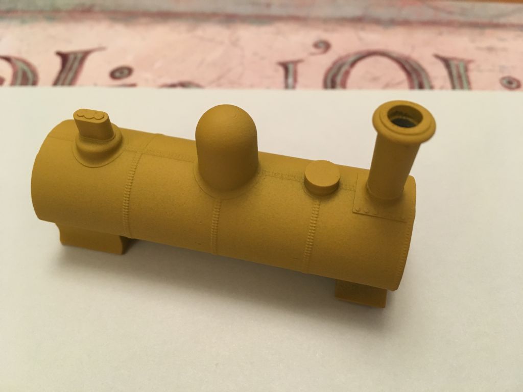

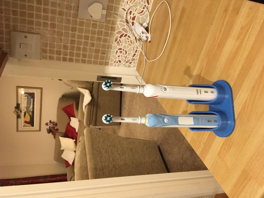

Some finished parts which are not tooling, although I do use my printers for tooling.
Toothbrush holder, not reprinted in white and at 0.1 mm layer
Boiler for LNWR crane tank in 4mm scale
Replacement nose for rocket on Grandsons toy
Bin liner containers for my sons 4mm scale layout
Various tests for 5" gauge loco lamps (my own design)
