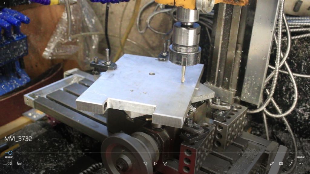

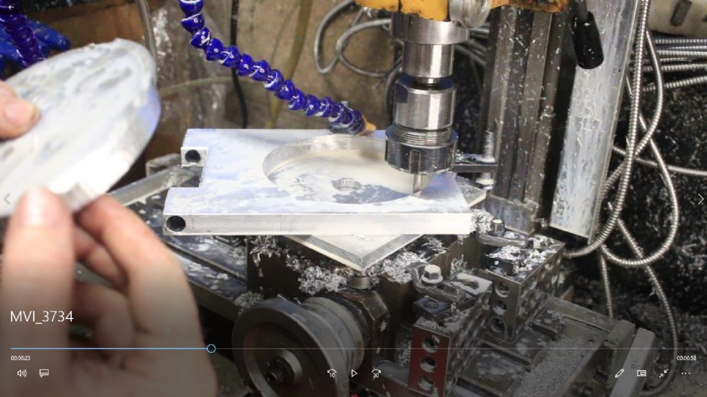

For the last few weeks I've been making a telescope wedge for my Celestron telescope. I've been filming the endeavour for Youtube in both Welsh and English. I've never made such a lengthy series of videos and tend to write things up on my Wordpress site.
Anyway, here are a few photos from the build. I hope it works when we get a clear sky.
I couldn't work out how to rotate some of the pictures sorry!
20230623_210047.jpg20230705_182505.jpg20230703_174102.jpg20230705_185438.jpg20230711_162111.jpg20230711_174531.jpg20230712_172639.jpg20230712_181838.jpg20230713_202927.jpg20230713_202921.jpg20230713_202917.jpg20230713_203241.jpg20230713_203423.jpg20230713_203055.jpg
