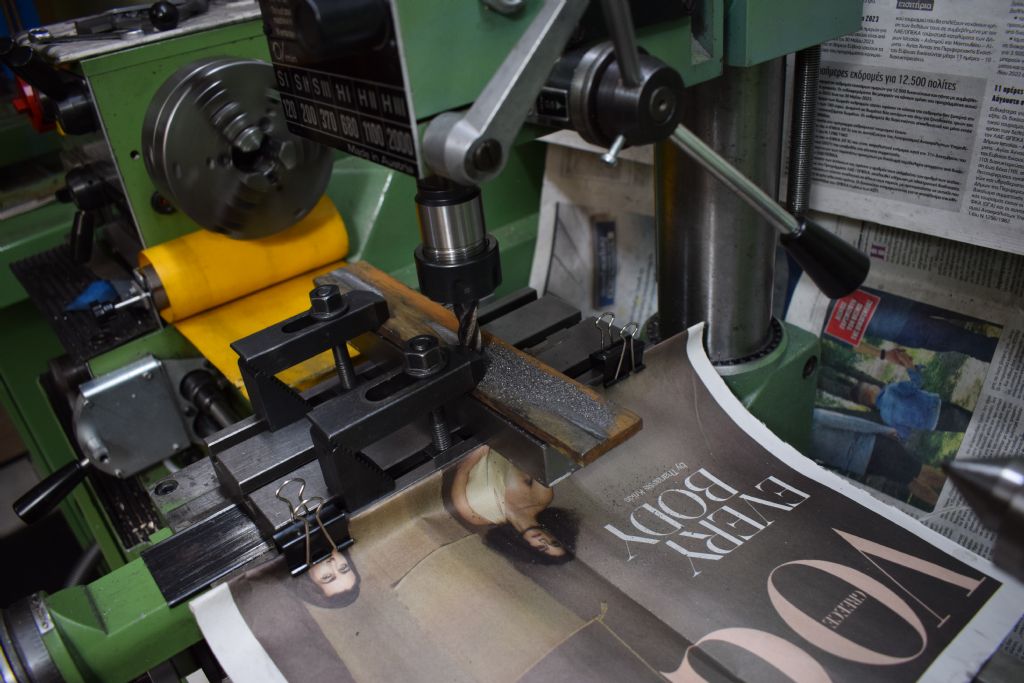

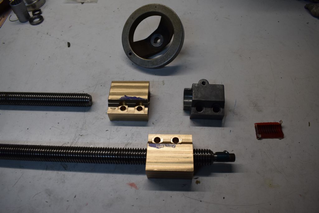

I am restoring an Emco FB2.
I have machined new nuts for the screws from phosporous brass
and now i am machining new gibs from cast iron (pics attached)
I would like to ask, can any help with the best choice of steel for the lead screws? Something that can give good machinability as also a good wear resistance? Somewhere i read that the 1144 carbon steel is a good choice.
Can anyone help?
Thanks in advance
