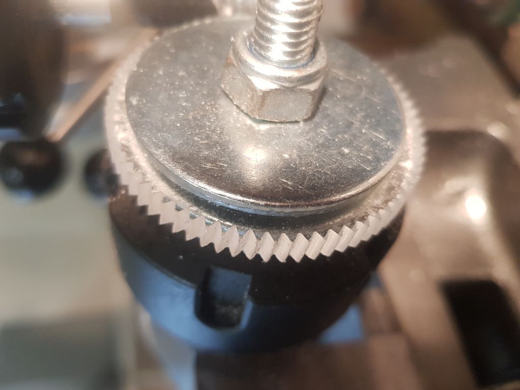

When I woke up from my pantograph AO drawing board this am, I was seized with a new direction . Why not try
straight slits down a bolt thread. My angle grinder disc is 1mm thick, so I made 5 axial slits coinciding with the hex head - in a heartbeat. If the gear blank is say minimum 3mm - mine was 6mm, then the cutter shouldnt come un meshed.
So this is the result
This is during the rolling and polishing process
This was just a quick try with my grinder, slitting along 6 edges to match the Hex head, done by hand so a bit naff, could do better
Not a chip in sight all round and SHOCK 74 teeth (not 73 predicted) -well it wouldnt suit a clock maker
Im not skilled in taking close ups. the gear is mucky from the brasso fluid which I applied to polish it up to please the Grommets
As you seen its a presentable form, even with rounded tips and roots?
I polished it up by using a plain bolt without cutting edges and some Brasso. I think the applied rolling pressure helped (after all they make quality precision threads by rolling process)
So even if it fails on soft metal, it can produce respectable plastic gears quickly and cheaply without complicated attachments, universal dividing head and loads of patience etc
I have some AL and brass blanks on order
Maybe look up some larger thread - 2" bsw 4.5 tpidevil that should knock the stuffing out of sofa dwellers

13/09/2021 19:27:23
Well well Mel the Magnificent confounds his armchair grumps, Stand back from successangel
I was backward in forthcoming as I didnt have any suitable blanks and ordered from EB
the pix are turned cw cos i forgot to landscape my phone - as you do
These are simple acrylic discs 6mm x 45mm gives circum = 141mm
i got 71 teeth
the bolt was 1/2" unc give 13 tpi - 1.954mm pitch so should give 72 teeth
so you get 1 less
Also note that my teeth are slightly slanted as I didnt bother with the helix angle just now
Note the crude bolt with the slits cut at 45deg, 6 in all to match the bolt head which i sliced off later. As a cutter it worked really well for what it was. I was very surprised. Even under a loup the teeth were respectable
I will have to try it in Aluminium and Brass before the naysayers go ape and spit the dummy
I will also try factoring the OD 71/72 x 45 = 44.37mm
Maybe try a slant of the blank to make a helix
I also located a pair of RH - LH threads might go for a herribone

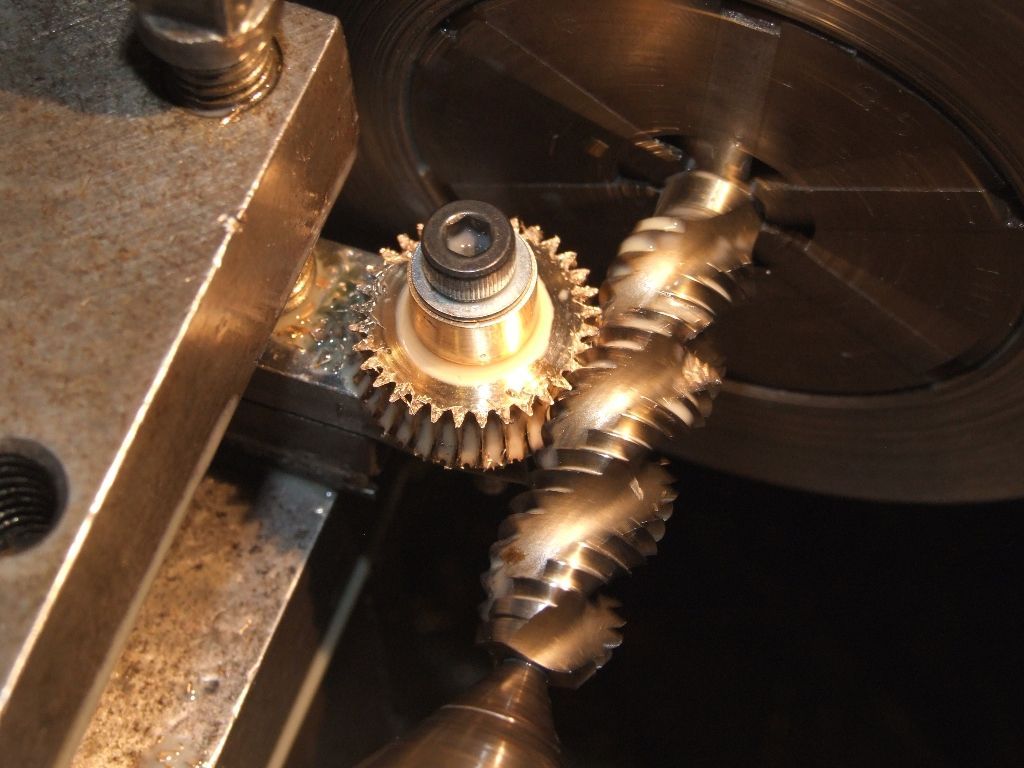

13/09/2021 11:27:33
Well if you havent got a proper hobber you can always go for a dividing plate and cut the individual teeth , its what proper modellers do innit, probably take all morning.
Ive watched that vid several times (is this like machinists prawn?angry 2)
would like to see another go with something to blow away the swarf so we can get close to the dirt - fascinating.
Others wading in this mucky subject have reported that they seem to get less teeth than was calculated given OD x tpi
So yours in 3.14" x 19 (1/4bsf) = 60 teeth
how many teeth did you actually get JB?
12/09/2021 22:01:21
Fantastico JB whats not to like?
so make another gear and see how they run together
you can smooth them out by running them through a shallow bath of fine abrasive powder of some sort
Its exactly what I intended to do
Obtw
the ultimate insult to the purists is to use my sliced bolt method, ie take a CS HT bolt , hold it in a vice and use an angle grinder with 2mm blade to make 30 deg slices longitudinally across the thread, rotate at 90 deg and repeat
then you have an approx to a spiral flute cutter
That was to be my last ditch attempt cos spiral flute taps are not easy to come by and are v expensive if large say 1"
So it may not be a nasty knurl at all, just a rough fix for those without expensive complex gear hobbers who need to knock up some gears for lightweight use.
