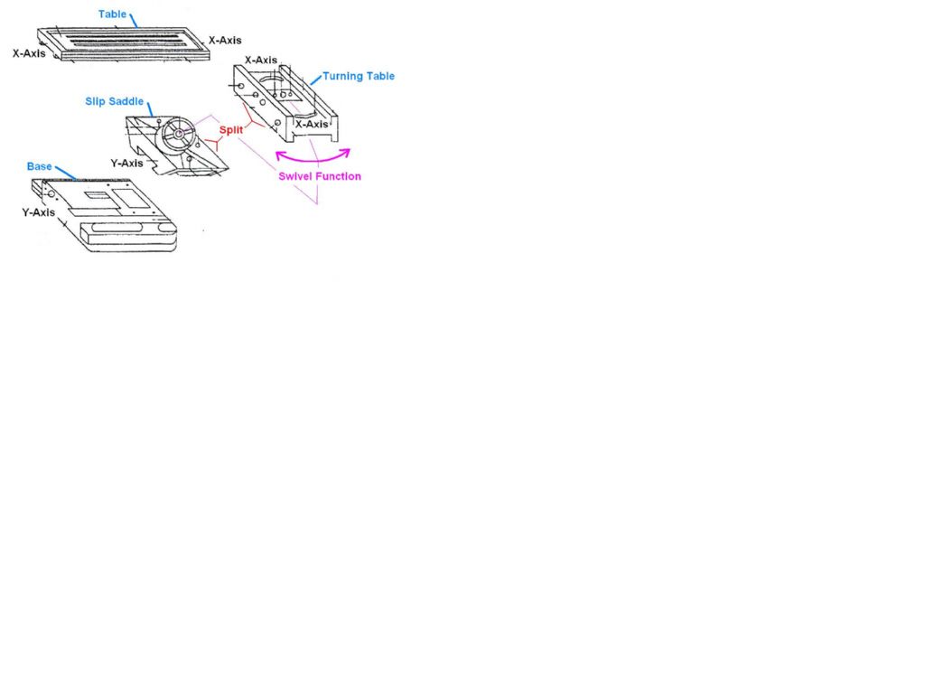

From the manual, poor quality, I illustrae the swivel parts involved:

19/01/2022 19:55:40
Correction :
illustration for ZX-45 (ZAY7045M)-Swivel bed Mill
>The "M" indicates the swivel option in the model type.
Note:The X-AXIS swivel around zero degrees mark at split.
To dial in your vice fixed jaw square, ...you must 1st line up this X-Axis square to Y-axis, if not 100%, its difficult to get vice set 100% square. I have made 2x adjusting blocks(Bolt-On) with screw adjusters to easily square this bed (X) without tapping with a mallet, it can be easily removed if in way of swivel.

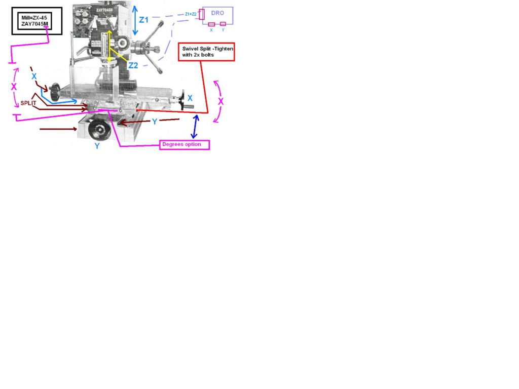

Disclaimer:I got a bit confused if I google the axis explanations, so correct me if I am wrong.
-I assume the X-axis is the one with the 1-Handwheel and you crank it towards or away from you.
-I assume the Y-Axis is travelling left to right in front of you with the two handwheels, one on each side.
-I assume your Head with gearbox going up and down is your Z1-Axis, and your quil up and down your Z2 axis.
- Will post a picture from the manual and mark the parts we talking about.........
Sorry if I used incorrect wording:
1-You have the lower cabinet on which it mounts.
2-Then you bave the power base which bolts to the cabinet.
3-The X-Axis are from the lower base top.
4-Then you have a center piece which make the swivel possible. This centre piece has a lower part which form the X-axis and its front handle. The top part houses the Y-axis lower part and you lock it down with two large bolts, one on each side.
5-The Y-Axis part of the table mounts and slides on this, controlled with the two handles, one on each side.
6-The Y-Axis is the one that swivel 45 degrees through 0-Degrees to 45 the other direction.
7-If I want to dial in my vice, I must 1st dial in the Y-Axis swivelled to 0 degrees. I have verified and fine adjusted it using a precission square running the X-Axis forward and backward in relation to spindle. If this is not exactly zero, I found I cannot dial in my vice 100%. I think this may be interesting, seeing if you dont have a swivel bed Y-Axis you rely on its manufactured accuracy, which if slightly out, is a difficult job to get right, so I assume in such a case you can spend hours and just get your vice 97% say accurate as example.
-So I assume if you have a mill without the swivel bed, and you get your vice dialed in 100% you have an accurate mill in that regard.
Added pictured explanation of how it swivel:
The Mill I bought was named=ZX45 as plate shows on face of it.
However the manual I received with it say its ZAY7045M, where M=Indicate the swivel function option.
It is sort of heave, If I hoist it without cabinet, my new 2-Ton engine hoise dont move by pushing it, I had to lever it with a jack handle along the floor. I am not sure exactly what it weighs, seeing themanual in places not accurate, like it has a MT3 spindle, no, it has an MT4 spindle. It looks similar to some heavier duty drill presses.
It has a 10A motor 220V. It seems not sloppy in the axises.

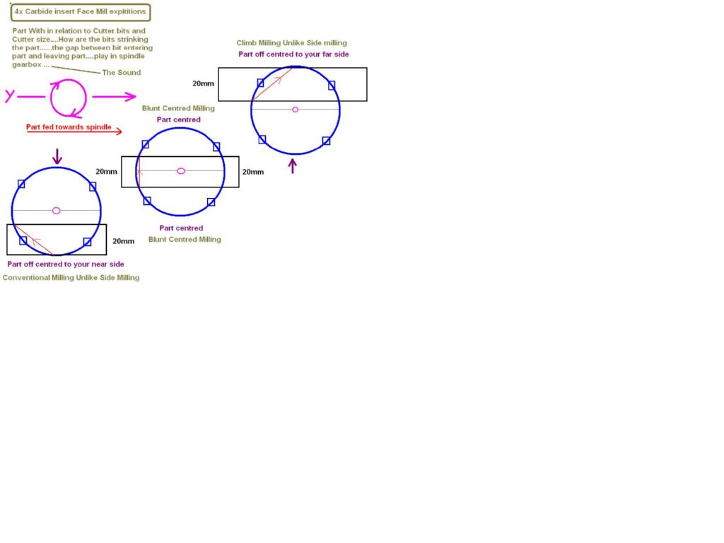

Ok, I could not stop thinking about this and after some time my mind came to a resting point somewhere.
I made a simple sketch in paint and uploaded it, illustrating my current view on this triggered by what other mentioned....
Today I am going to bolt the 2x parts together seeing they have holes, and mill both small ends together clamped in vice.
Some questions going through my mind:
0-Spindle Speed=+/-500rpm......The time a cutter tooth spends on the part.
1-Face Mill size=80mm
2-Face mill teeth=4....wide spacings..
3-The part with=20mm......
4a-The -amount of teeth- versus the part with and the -gaps or not- in play.....
4b-The mill has a gearbox or not....
5-The spindle Rotation=Clockwise.
6a-The part offset towards me...Angle into work and out...Grader
6b-The part centred to spindle centre.=Blunt cutting...Bull Doser
6c-The part offset away from me...Angle into work and out...Grader
It seems one can have "Conventional Milling" ....."Blunt Milling"..... and "Climb Milling" like but not similar to other side milling practices.

Howard, interesting remark, I was not sure about climb milling with the facemill, if I put it on centre, ok the time of the cut is shorter, the angle is more headon, the sound if I can describe it was blunt and it sound like its putting play on mill gears in gearbox or bring out the play and it looks like it pushes the cut like a bulldoser, compared to a grader with blade sideways scraping the road, ..while off centre it's more silent and free cutting sounds good, however I could not see a diffrence in quality of either cuts apart from the angles finished.

Ok, so I offset it quite a bit towards me(Y+...-? from the centre, and the sound if much different softer, and I get the feeling I can feed it faster if I want to.
I don't have DRO, so I interswopped them in vice(twice) till both down to 17.5mm.
The finish is good and evenI would say, very happy with that.
Will inspect the cutter tips tomorrow.
So thanks for information given, this was an interesting experience about cutting sound.
