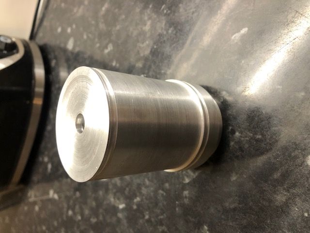

Another reasonably slow week for machining parts. It was the water jackets turn to be turned. An awkward lump to hold, given by its pure size. It seems like a trick was missed by Reeves / Westbury in the design here as this casting just stretches over the very common centre height of 3.5” meaning it cannot be held in my myford. Due to this I had to borrow my dads EMCO Compact 8, a much daintier lathe, but with a greater centre height of 4 inches. The clearance on this casting between itself and the bed was roughly about 0.5mm! this brought many issues with it, including being very watchful of the carriage placement and also having to have a monstrously long boring bar. The total length of the boring bar came in at 8 inches! To take into account the 3inches of depth and the 3 inches of air between the carriage and the casting. A real pig! The casting itself was overly large I thought, meaning nearly 3/8” needed to be taken off the bottom face and a 1/4” off the top. Given how well aligned the casting was, all this meant was copious amounts of winding in and out on the topslide.
I’ve included some pictures and brief build comments below.
Initial boring of the casting,
clearance between casting and lathe bed. Very tight!
finished facing bottom and boring recess for liner
test fitted liner to jacket.
top face cleaned up
4BA C/Sunk drilled through from jacket into the liner
Edited By JasonB on 26/01/2021 12:59:43

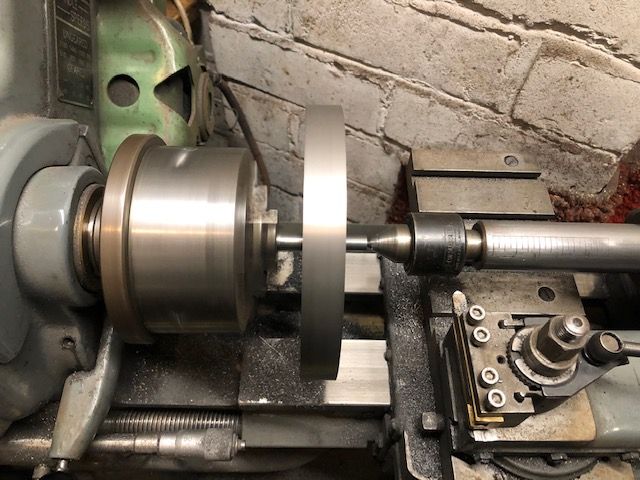

The past week, has been a slow one in terms of engineering, with work demands being higher than normal. I still managed to get some bits completed, but not as many as i would've liked.
Annoyingly the water jacket casting will not fit in the myford, due to the 3.5" swing. I may choose to modify this slightly to make it fit. It seems a slight oversight that it wont fit, given that the majority of home engineers lathes are 3.5" swing. But we shall not be beaten!
A few pictures of progress in the last week are included below.
Flywheel truing on a tapered mandrel
Machining the crank side flywheel
Water Jacket Liner
Picture of the finished liner below
