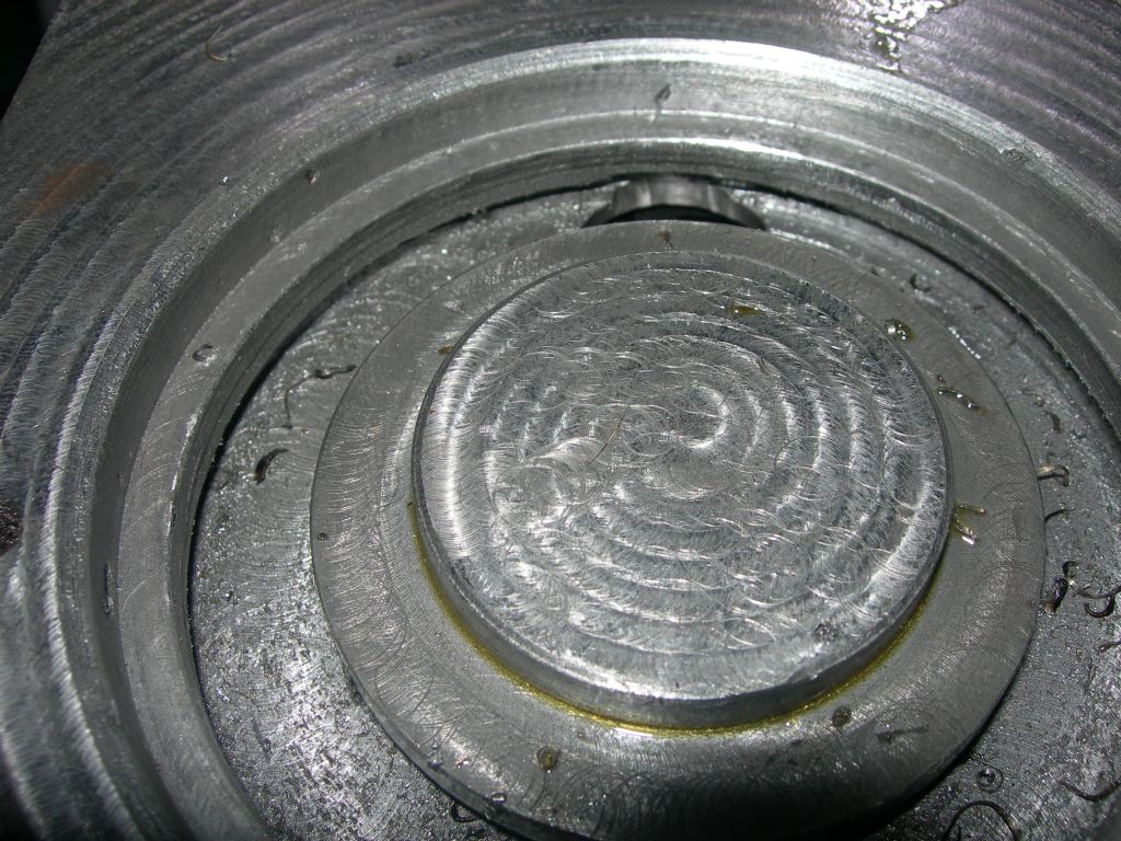

21/05/2022 20:27:21
I created and album so here is a picture of 4 bolt tool-post mount (4 bolts to bolt to carriage t-slots)Lathe parts
The large hole was for the t-slot cutter and to get t-head bolts in

19/05/2022 19:31:23
I have never cut any -T-slots before as I never needed to. I bought a cheap T-slot cutter which disintegrated on first use. (don't think it had correct heat treatment?)
As mill was set up and I didn't want to move anything started looking through old issues od MEW and came across a T-slot cutter build in issue 17, June/July 1993.
I didn't need end threaded as my Clarkeson Autolock holder is on mill 'at home' (been living in Florida since 1999) so it was quite quick to drill some holes in a grade 8 bolt then turn diameter to fit collet chuck. Broken HSS 3/16"centre drill for a cutter and back in business.
I'm actually pretty amazed at how well it worked and now have a new tool-post base in steel for lathe (the original cast iron piece is pretty flimsy and flexible, seen various plans for upgrade over the years)
I'll get a picture or two if anyone is interested.
