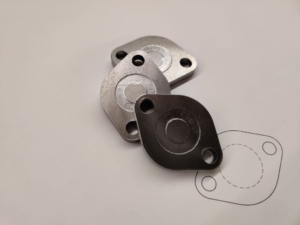

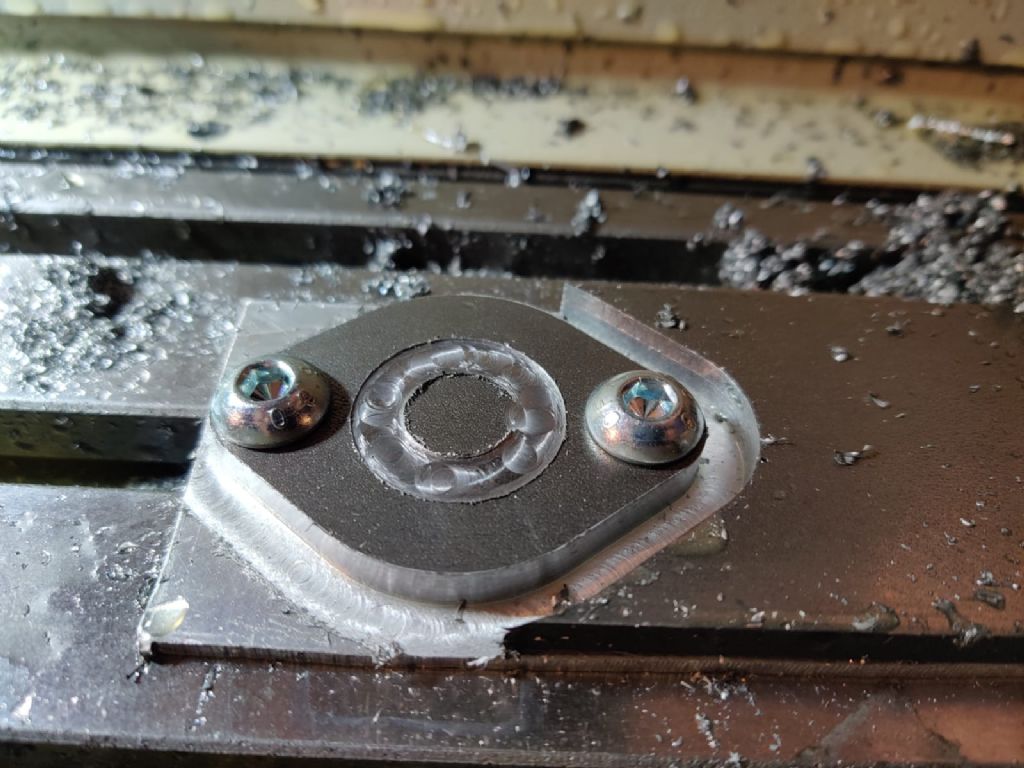

22/05/2021 16:16:44
I've tried tabs, but got some nasty vibrations with my non-centre cutting endmills. I don't think it's ramping into those tabs, for some reason. I tried triangular ones.
Edited By Nicola Casali on 22/05/2021 16:17:48
22/05/2021 15:59:09
Sorry, I was referring to https://youtu.be/HWVk5nqtSXc
I just realised I used F360 for the flanges. I may have attempted Aspire first. The stock is 6.35mm. I was using a 1mm stepdown with a 4 flute endmill. I'll try your suggestions, as I need to make 3 more. Great!
Edited By Nicola Casali on 22/05/2021 16:00:45

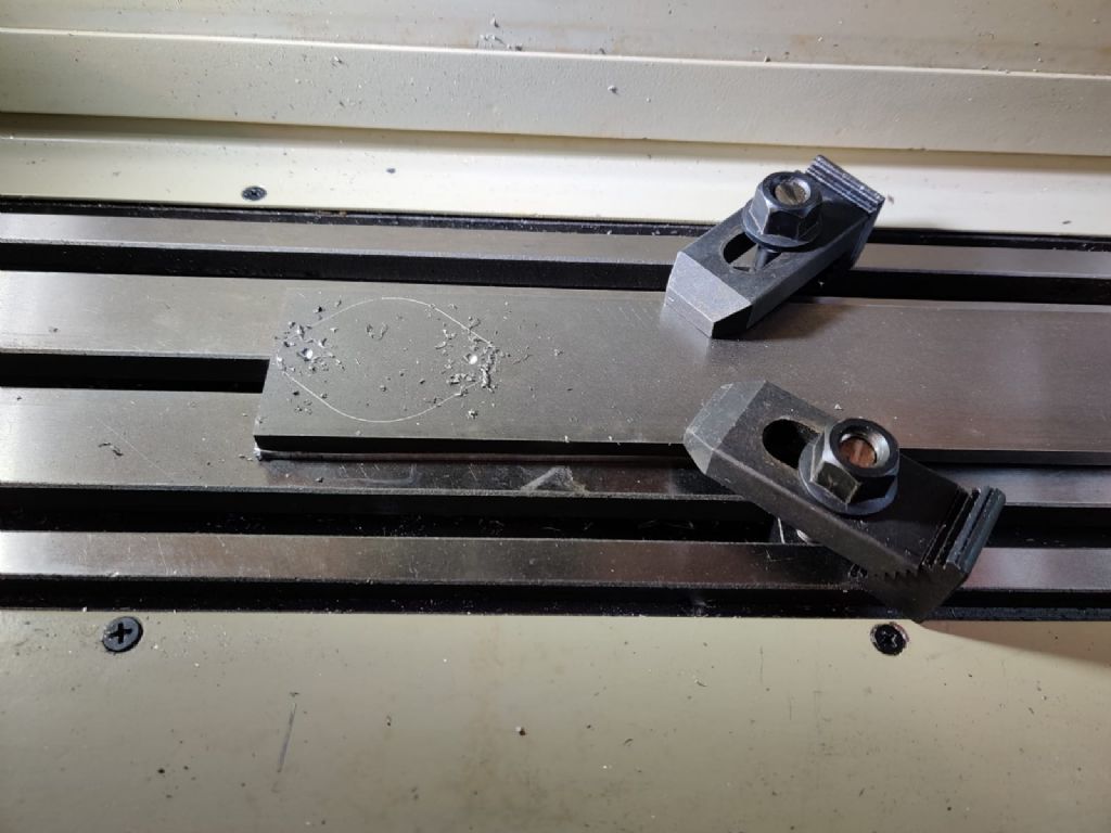

22/05/2021 14:03:13
I made these a few weeks ago with Aspire, before I got started with F360 CAM. I had to go really slow with multiple depths and used lots of coolant.
JasonB, I can see your contouring above is quite slow too. What depth of cut are you taking?
I tested some contouring with F360 a few days ago with no mist or coolant and got my 6mm carbide bit to glow wonderfully. My feeds and speeds were massively optimistic. Cutting a slot in steel is a completely different ball game, obviously.
Stock workholdingFlange contouringFlanges
