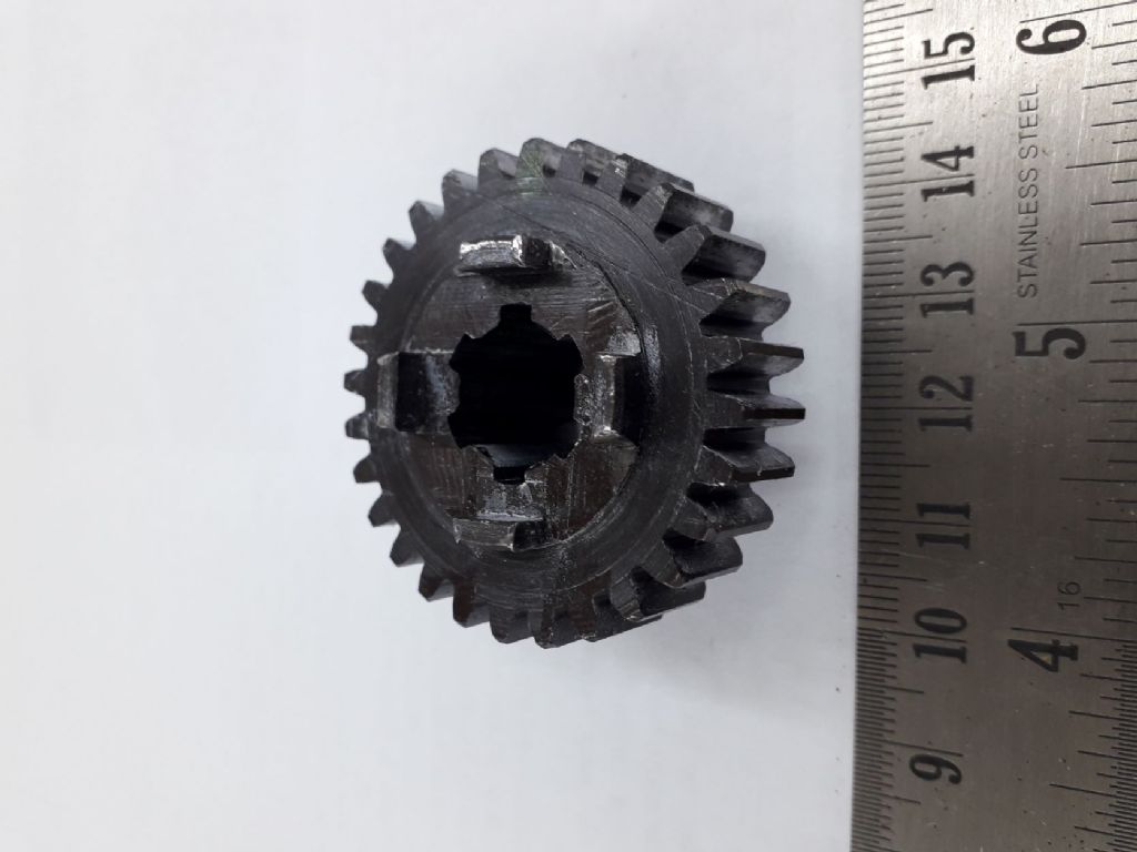

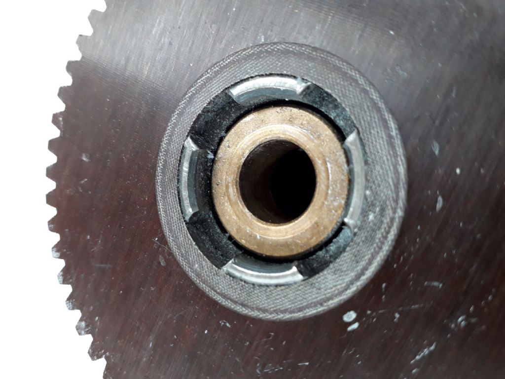

The issue I am having is with the connection between the gears as the drive teeth have worn. Both of these gears are on the same shaft with the splined gear driving the other gear. This is causing chattering when I start the lathe in the two highest speeds which is the only time these gears are engaged with each other. I have created an album called "Gears and Stuff" that has more images in it but the two attached images show the worn teeth on both gears. I will make sketches the gears and add these to the album. The teeth are about 0.030" smaller than the slot they engage with.
