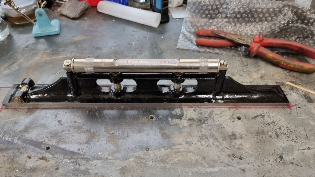

Well guys. I have managed to repair the Level. I will attach pictures below. As SOD or someone said, not everyone wants to watch Youtube video's. So the photo's will at least show the thing being repaired. But honestly. We say a picture paints a 1000 words. But how many words does a video paint. Just saying.. I recorded over 6 hours of footage. Spent much of today editing down to 25 mins. Regards all. Yes they are very difficult to set up. I ended up on the mill bed. I have no Granite block or anything like that. The rotating & adjusting took around 1 1/2 hrs. Will put a link to the video, once it is up & running.

I am suspicious as to why the vials break so easy. Is it bad storage. Is it because it's glass . Is it because it's glass & pressing against a steel body apart from the back of it.
If the latter. Then would the whole vial benefit from being wrapped all the way round & then trimmed carefully where the opening is. The hole in the steel /Brass tube is a little over 16mm. The Vial is 15mm. So 1/2mm wiggle room all round.
