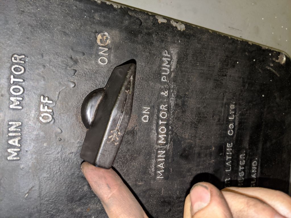

Definitely a toggle switch originally.Can't see if they're hex or slotted

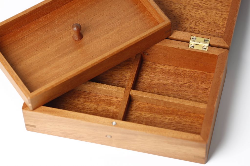

Now you've said it, looks like there are plenty of compartments for various instruments!
04/06/2020 19:26:02
I'm sure my background of a nice brick wall works perfectly too

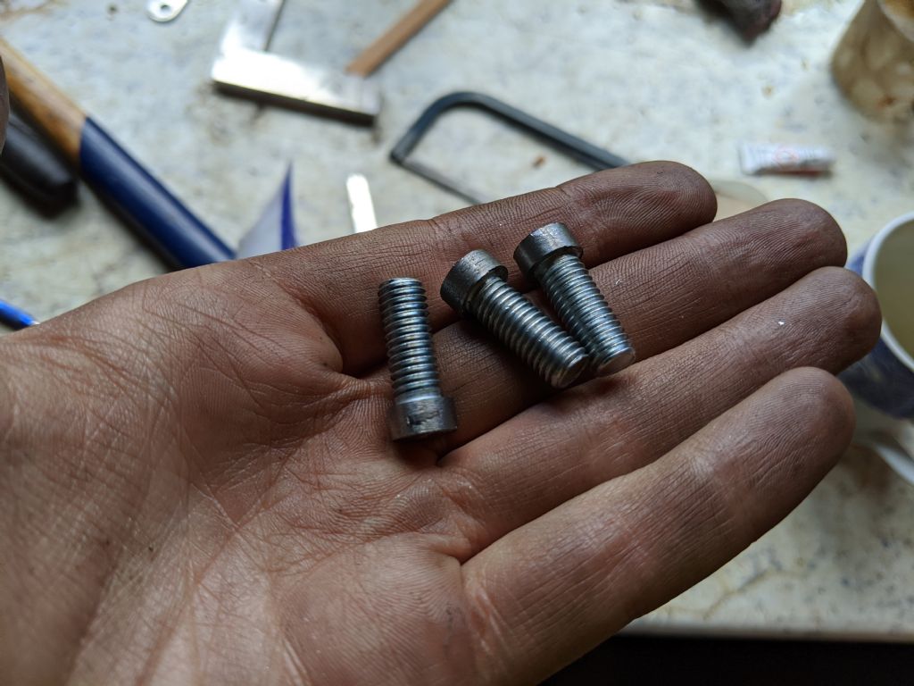

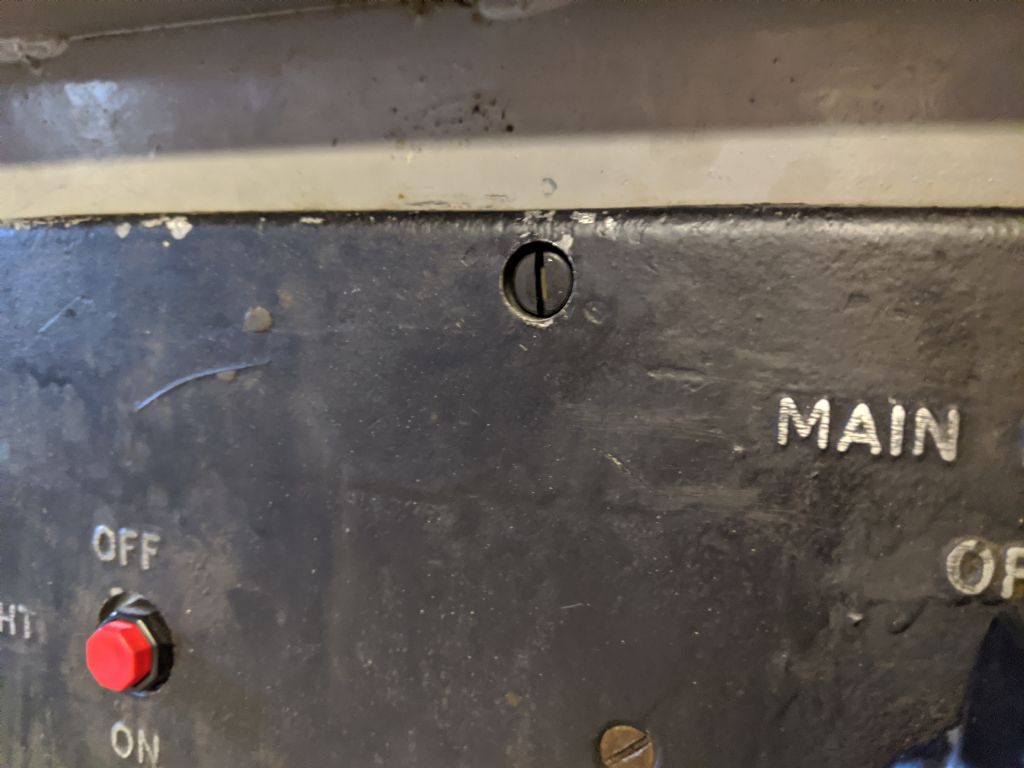

I've had a very productive day. I finished some jewelry boxes, similar to the one I made for Phil, but with trays and sections. Then some castors arrived in the post so my bandsaw is now free to glide around the garage. Then onto lathe work...

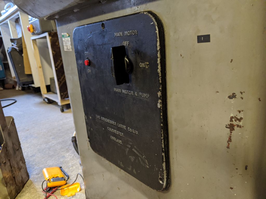

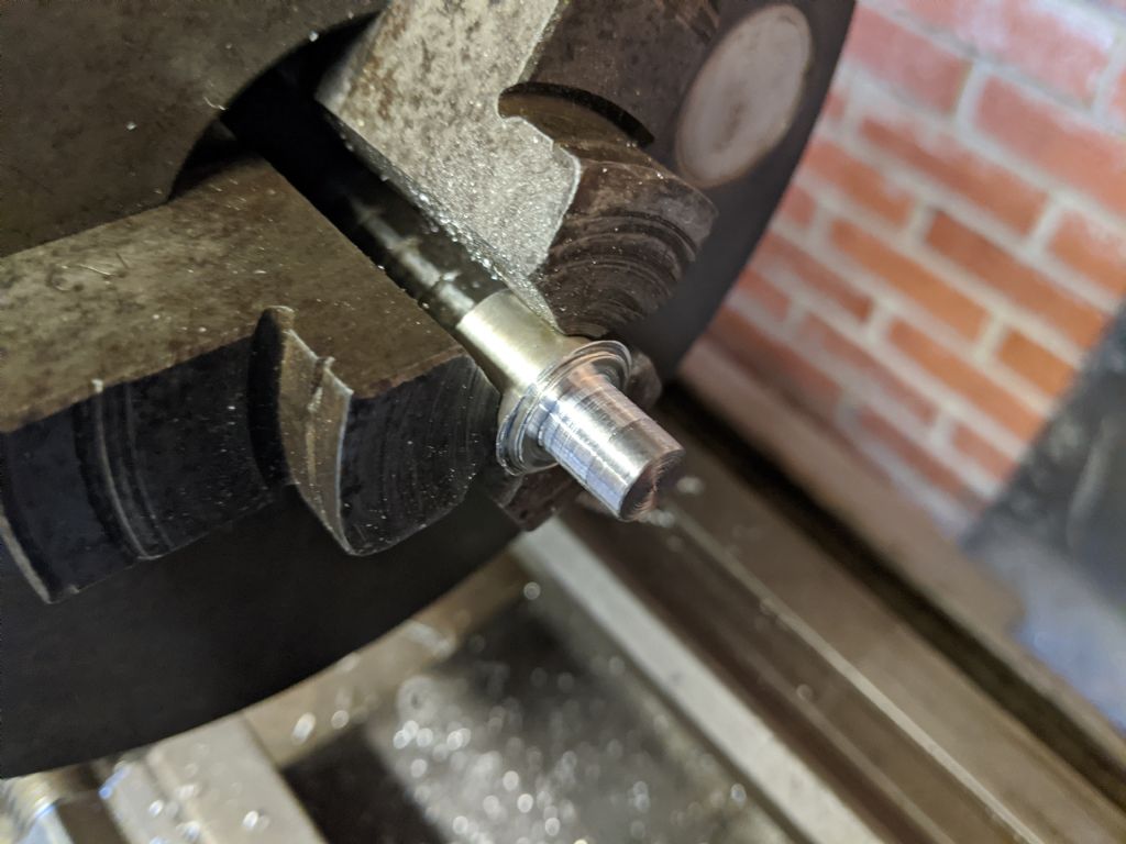

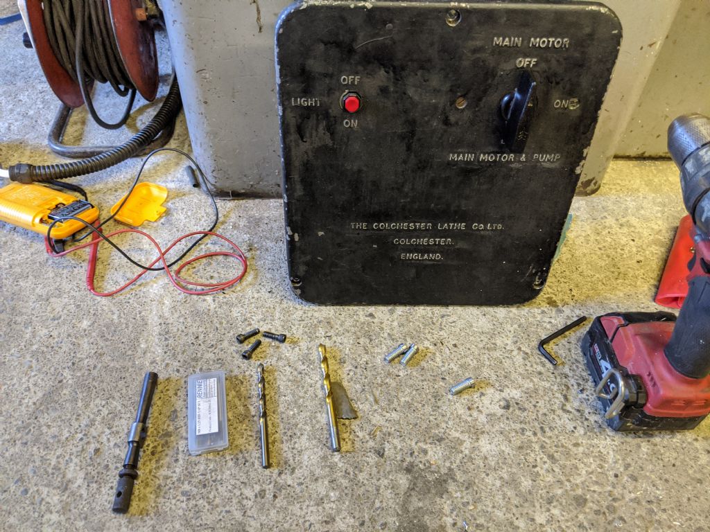

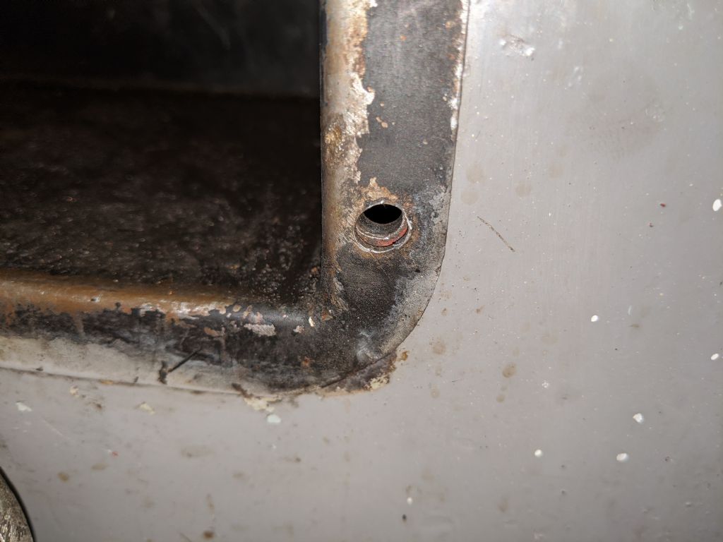

I picked up some m8 bolts from Toolstation so I could work on getting the panel fixed in place properly
Before I could turn the bolts down I had to put the starting lever back onto the lathe, so I took a picture of the back. Tracy finally got back to me today, so I will try to see if she can send me the starting level of her lathe so I have a spare if I mess this one up!

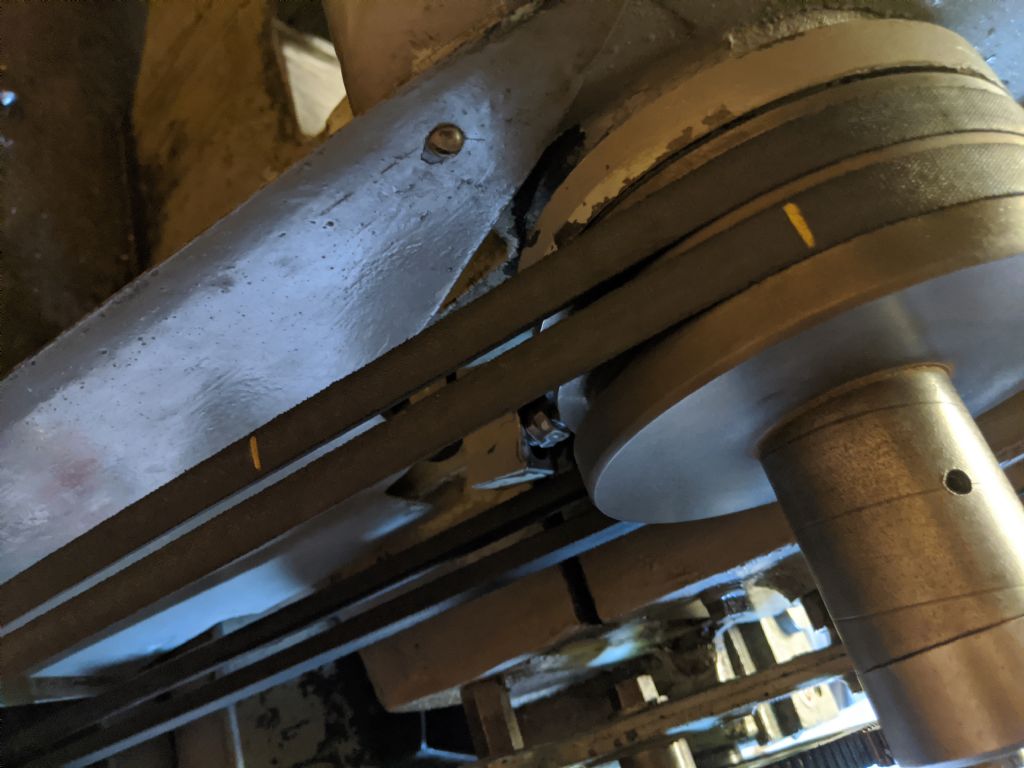

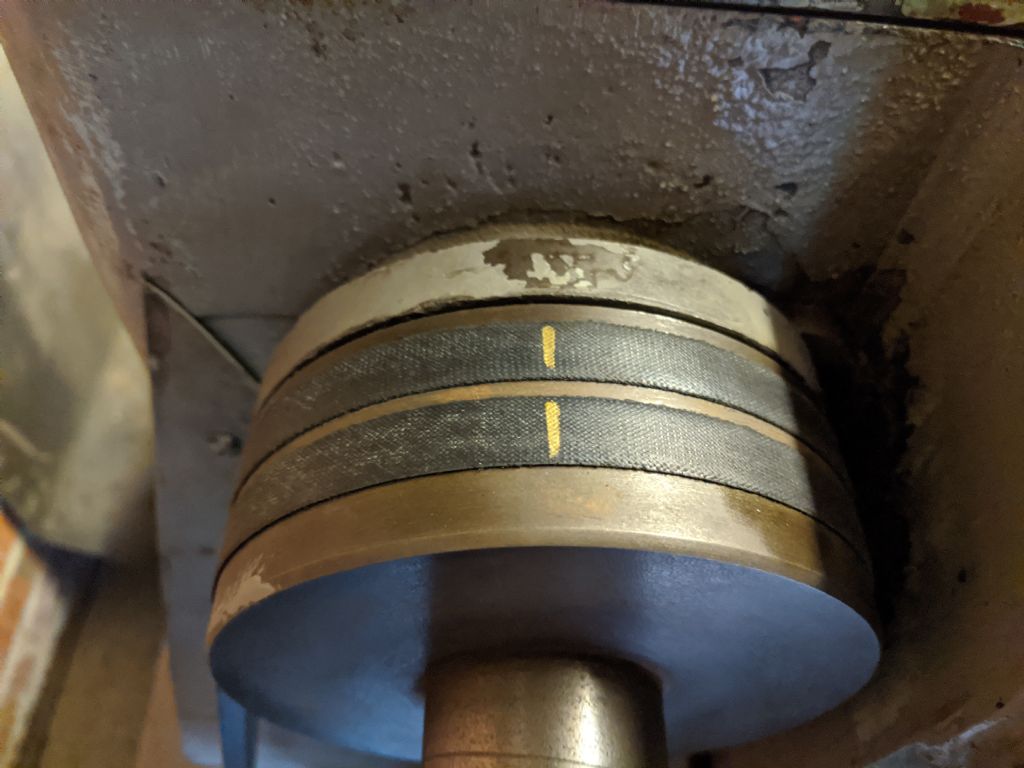

Chalk test, with a gold highlighter as I didn't have any chalk. The belts are not even. Can this be caused by a misaligned motor too?
Anyway, I'm running on 1 belt now and the lathe is much more peaceful. The link belts seemed a bit expensive when I can just use one belt, especially since I just bought these belts, although I do see the attraction.
The bolts were screwed into a piece of aluminium I tapped, then faced, and turned to the dimensions I wanted.
Then I cut the slots just with a hacksaw

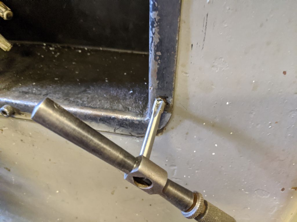

Then I prepared to drill and tap the lathe body.
This went surprisingly well

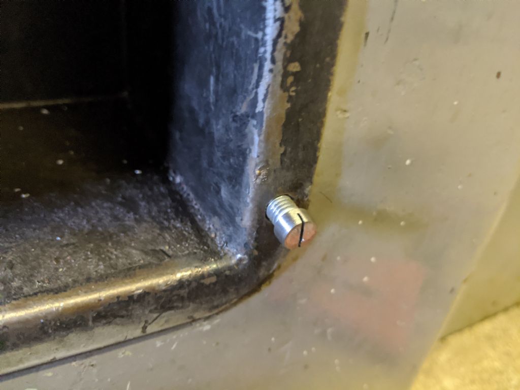

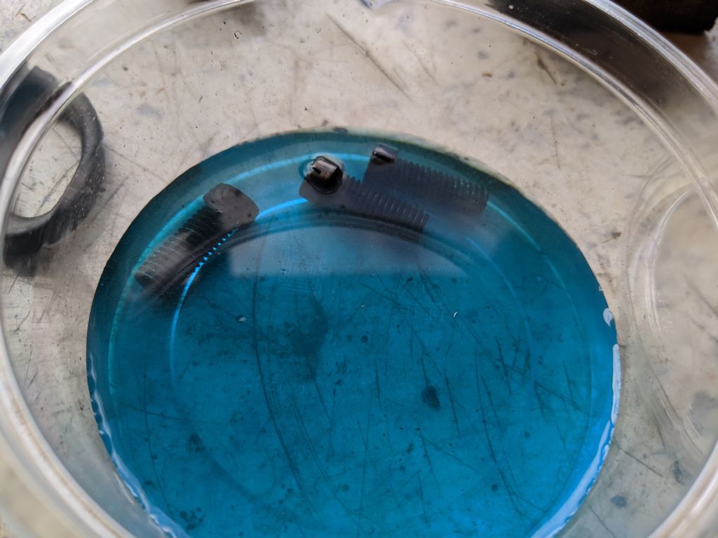

Then I polished the bolts, gave them a brushed finish, then cold blued and oiled them.
Fully installed, I'd say they look rather fitting.
They pull the panel in tight
Then I tried the light and gave the panel a bit of a bang around to see if the light went off.
The light went off again
I've still fixed the stripped threads and improved the panel's fit, which I'd say is productive enough, but It annoyed me that it didn't fix it, so I started testing things
I cleaned the contacts of where the 2 legs for the lighting power leave the brass plug bit, that didn't help
I cleaned the surface of the slide lock fuses, that didn't help
Then I bypassed the switch to see if that made a difference, low and behold it stopped flickering when I banged it, I think. I could be completely wrong once again, I'll replace the switch and see.
I've ordered a toggle switch to replace it with since I found a picture and there should have been a toggle switch there anyway. I ordered it a couple of days ago actually, so this is currently working in my favour until it turns out to not be the issue.

Posted by Herman van der Merwe on 03/06/2020 22:21:39:
Posted by Richard Kirkman 1 on 03/06/2020 21:35:40:
The belts are almost definitely different lengths or not running right as they make a lot of noise and sound like they're hitting off each other. What is this chalk test?
You need a matched set of v-belts. If you do not have such you need to replace the belts with Nu-T link belts. I only run Nu-T Link belts on all my machines.
Chalk test - http://www.lathes.co.uk/colchester/page2.html
Thank you, I have read that page before but I don't remember reading that. The belts were supposedly matched but I'll do the chalk test tomorrow. Link belts are a possibility depending on the cost.

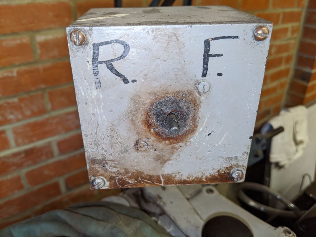

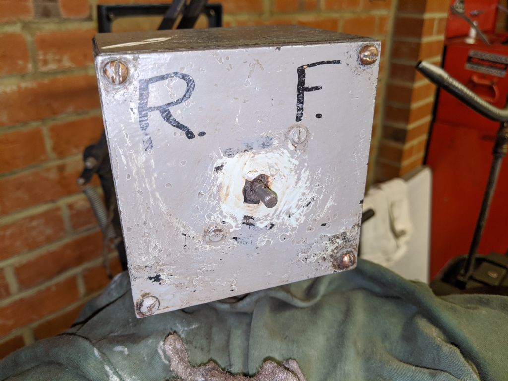

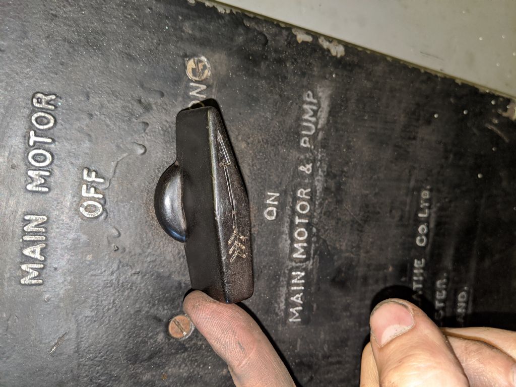

I cleaned up the face of the switch box too. There must be a more elegant way to write reverse and forward onto it
Interestingly, there is the original lathe colour paint underneath the grey. This means that the switch is original, or at least was put on when the lathe was painted before.

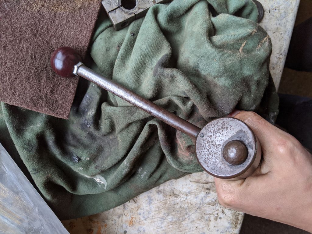

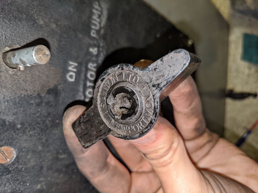

This is the handle, it will be brightened up. The rod is held in by a blind pin. Any suggestions as to how I can get it out without drilling out the pin? Drilling is last resort, but I think it might be inevitable.

Most likely the V-belts are not of equal length. Have you done the chalk test on the belts?
I meant what is the electrical issue caused by, but I've figured that out now.

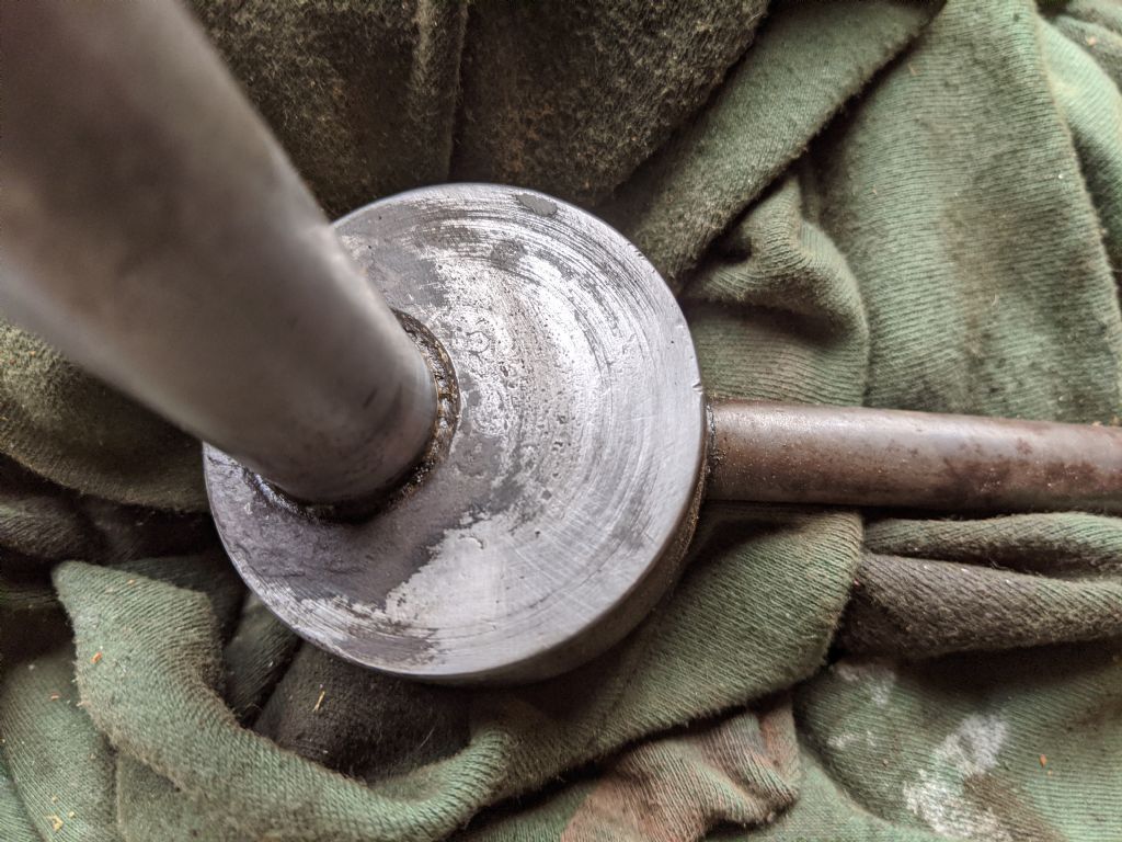

I managed to sort out the excessive wobbling by using a much longer bolt, it works much better now
Wobble before
Wobble after
So it's now much more satisfying to turn, and doesn't feel like I'm about to break something.
These are only finishing touches but they're the feel of the machine, everything I touch when I use it. So I think it's important for it to feel nice so I enjoy using it more.
I also did the same for the reverse forward switch
direction switch before
And then it had no movement after. all the play was from the actual knob spinning, not the shaft spinning.
The last handle that Is loose is the main on/off lever. There is a lot of slop in this and it makes it feel loose and less tactile to use. The only trouble is, it's actually worn.
Herman, after seeing your future shiny handle I think I need to polish a few of mine. Perhaps just a brushed finish

I think it was just caused by the entire box not being secured properly. A few of the threads are stripped so it's hard for me to get the box all the way in, however when I managed it worked nicely. I also cleaned the 3 prongs that the power goes through, and the holes they go in. The box bit was bent out of shape too, so I have beaten it back into shape so it now fits nicely.
I managed to get two of the screws in and they held well enough to make it work nicely!

I'll drill and tap them M8 and buy some bolts, which I will turn down to the correct dimensions and put a slot-head on. This way I can get the exact fixings I want. I believe they're currently quarter inch, but I dont have any imperial taps, so m8 will do.

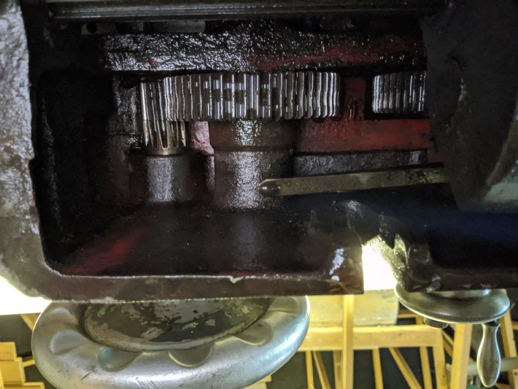

02/06/2020 11:20:37
Well, that is interesting.

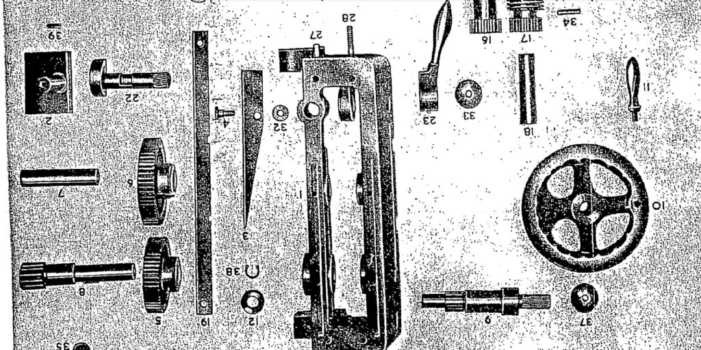

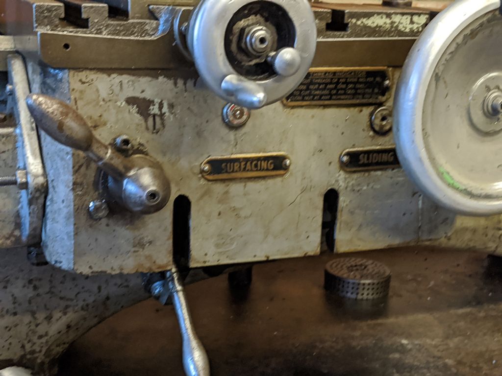

I found the picture that I took of my apron in the manual, might help a little if you haven't looked it up

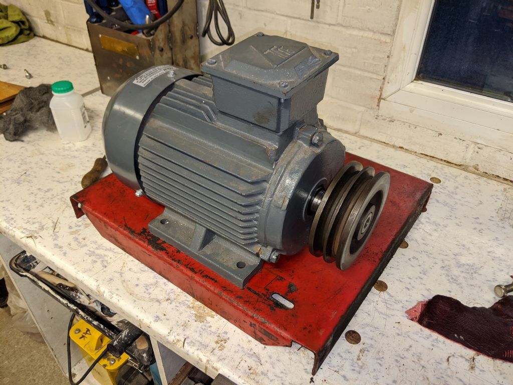

Posted by Herman van der Merwe on 01/06/2020 22:02:23:
Posted by Richard Kirkman 1 on 01/06/2020 21:37:57:
The rotary converter is fine for what I'm doing. I do not need to change anything. I just need to replace the capacitors at the same value as was already in there.
With respect I disagree. The RPC is to be matched to the type of motor you are driving. Your lathe's motor is VERY old, so the RPC might need different cap values to what is in it at the moment to be suitable to drive your lathe's motor.
I trust you understand my concerns.
I have changed the motor. I am now using a TECO 2003 3hp three phase motor. So much more modern.
I understand and appreciate your concerns. However i don't see the issue, the literature shows that the converter can run any single motor 5hp or less due to the power compensation circuit which eliminates the need for selecting and deselecting different amounts of capacitors for different motors. So my understanding is that it doesn't need to be suited to the motor, since it adjusts itself and works for a range.

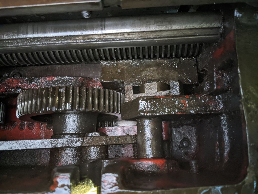

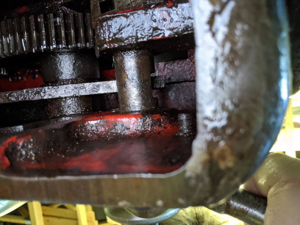

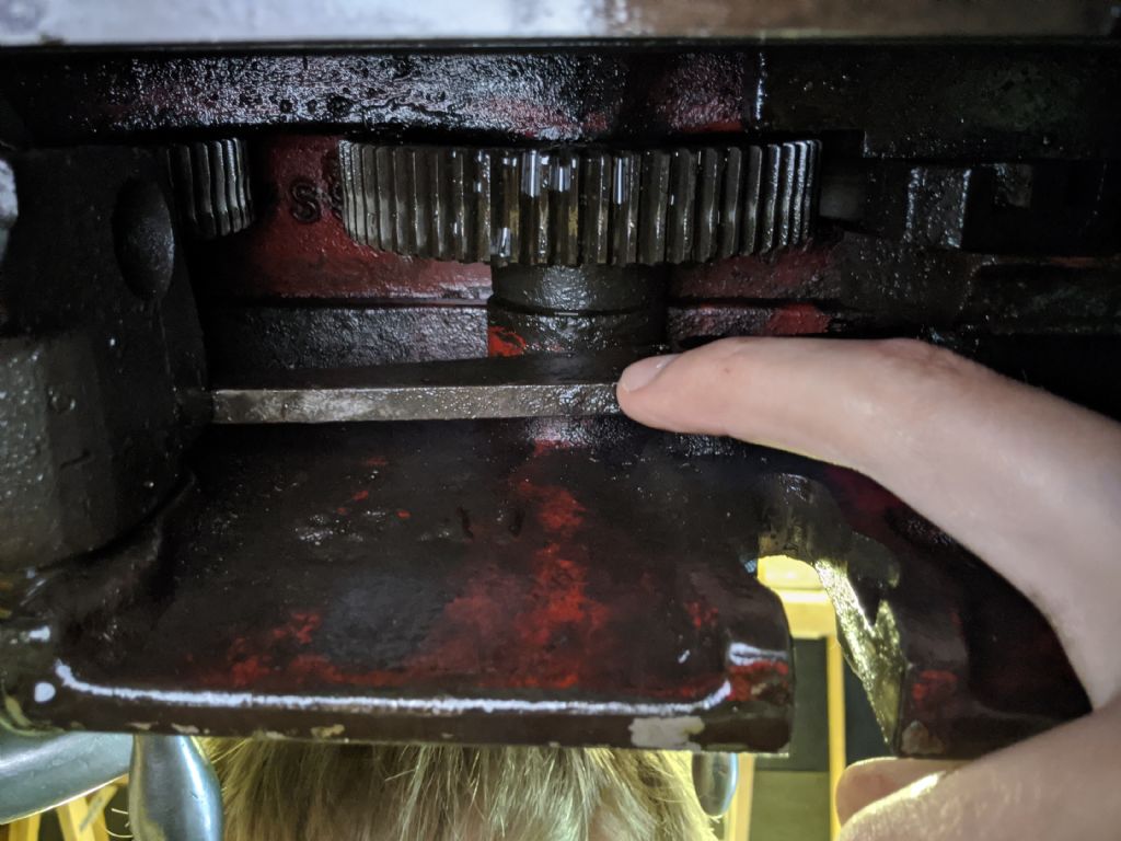

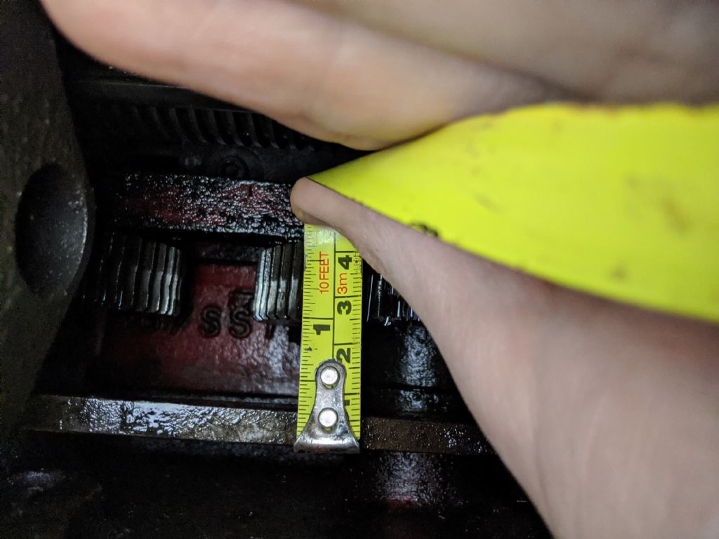

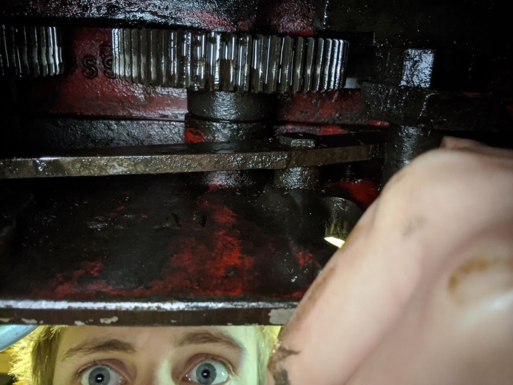

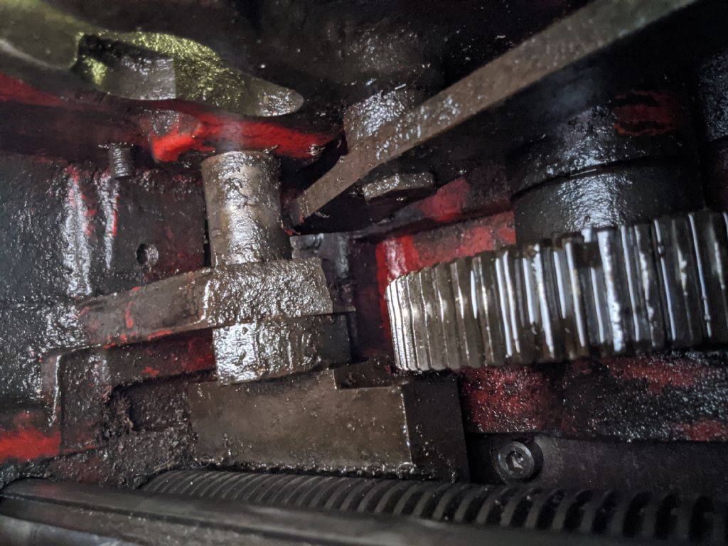

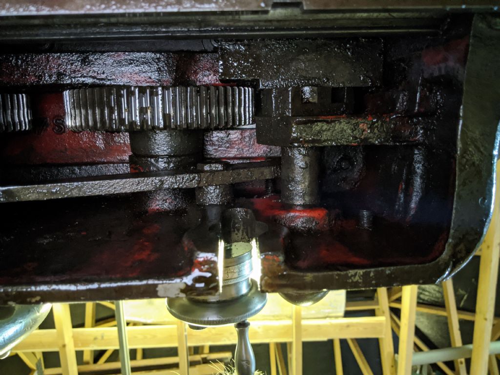

More pics here. I don't think the thickness of it matters too much as long as it fits in the slots that are on the lead screw bit. As yours is in pieces i'm sure you can measure the slot and other parts. I can get even more pictures, but I think I've covered most angles that I can get to it
Just to be clear, my apron is shown in the manual that I sent in somewhere. So that's the place to look
i can't get a full measurement but the measurements from the picture seem right to me.
Look carefully at the shaft it's resting on, there's a flat.

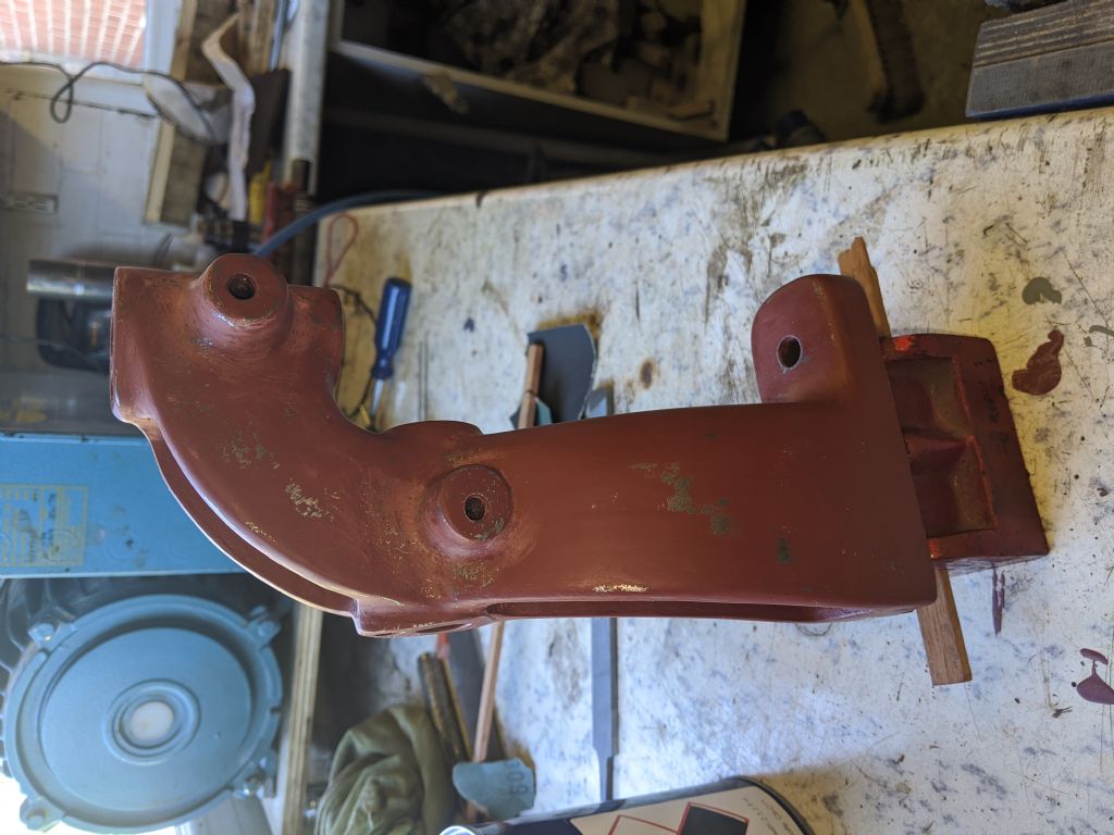

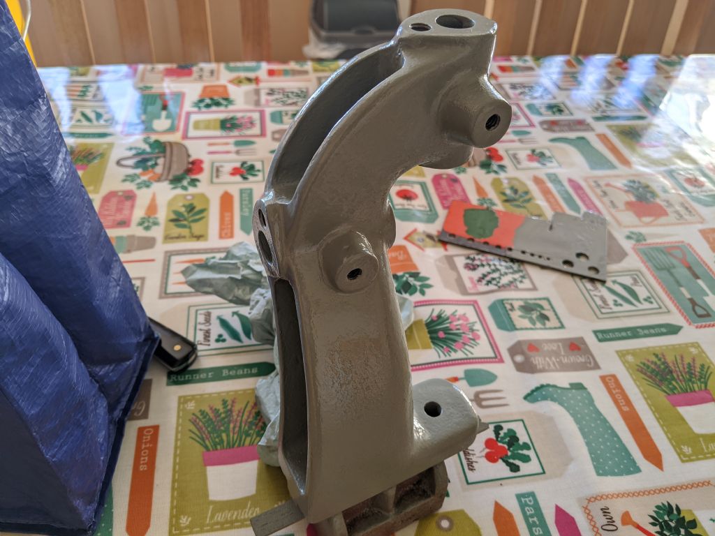

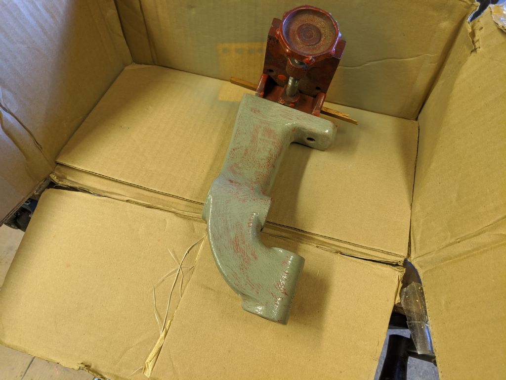

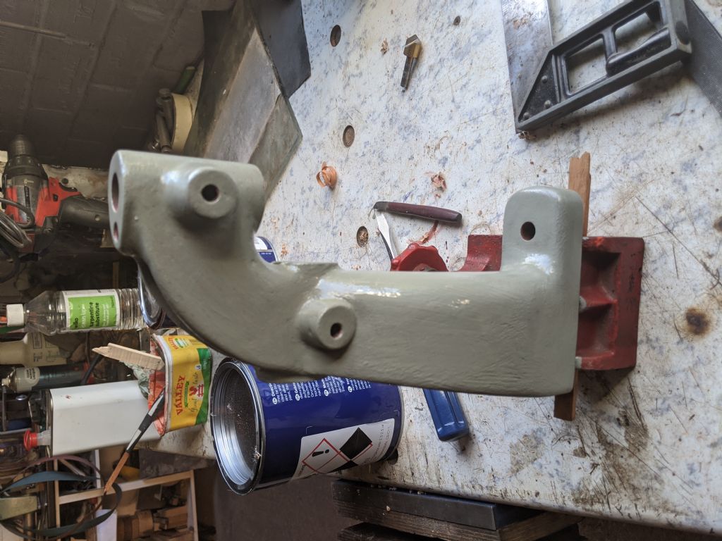

I've made a little bit of progress with the traveling steady. Still getting better at painting, but I'm getting there. Sprayed it for the first time today, it gives a much better finish, I'm amazed, even with a wagner fence and decking sprayer. I just wish I had sprayed the primer on with it too! The finish could still do with improvement, but I'll sort it somehow.
I think painting more things at once would be much better, so I might move onto doing a few lathe parts soon. I can feel the tailstock calling to me
Pictures and video of apron
Video Link
