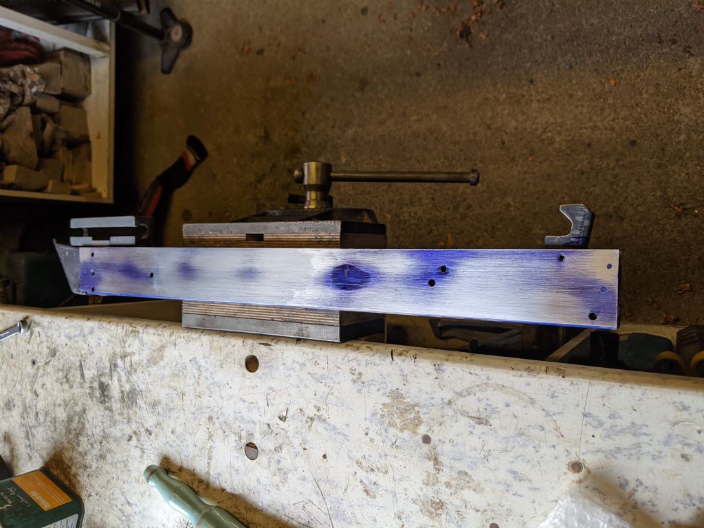

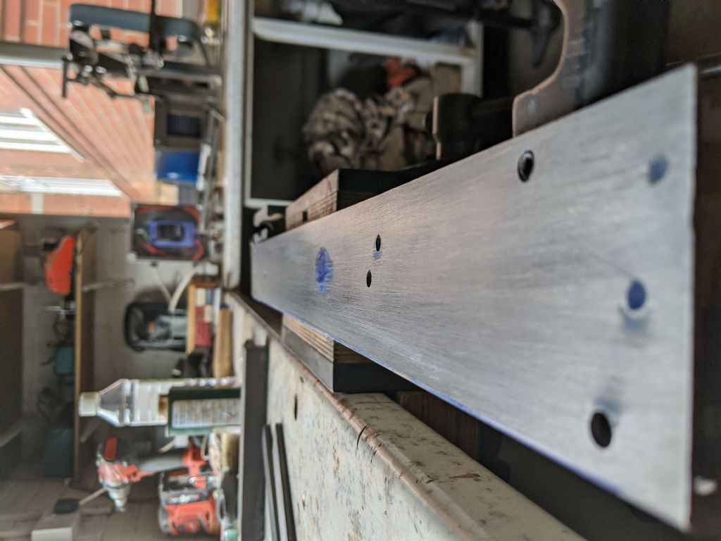

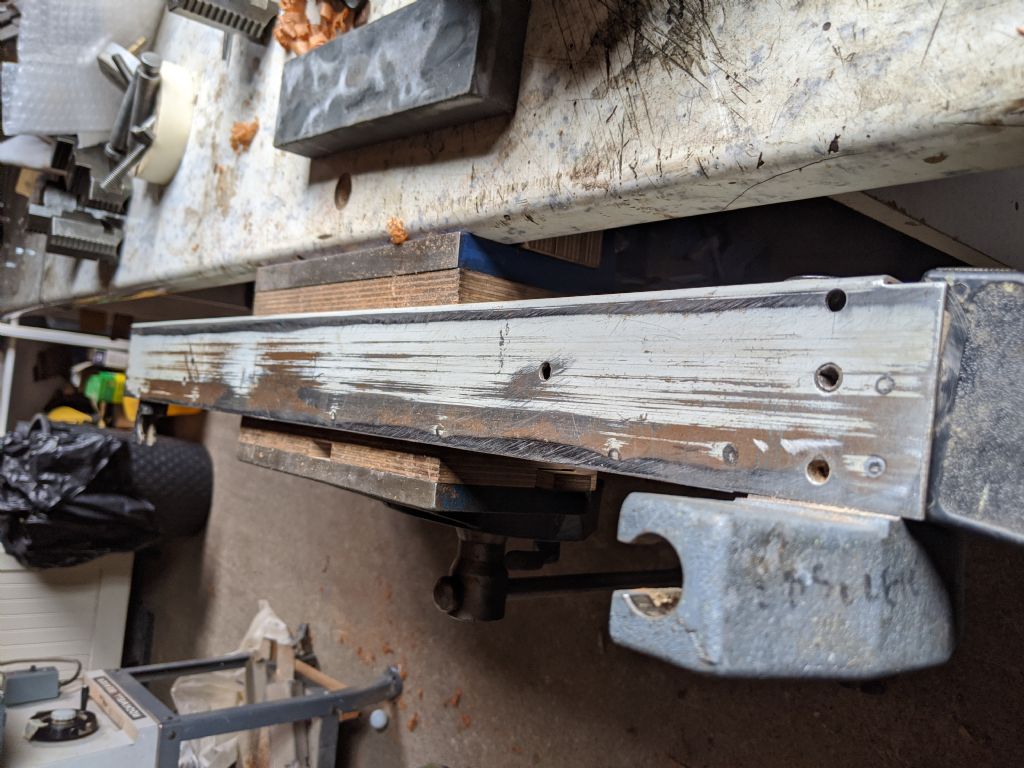

03/04/2020 15:10:24

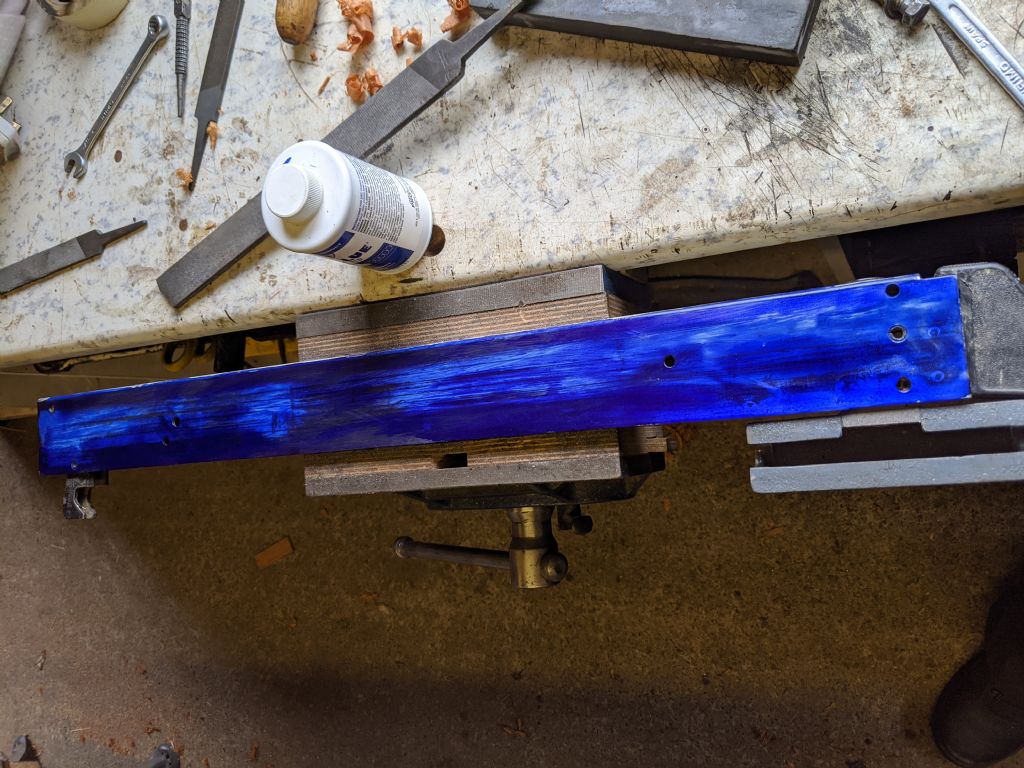

Well it was a lot of filling. But it's a lot flatter than it was
I've just blued it up again, now I've glued a bit of 240 grit paper to a bit of glass so I'm sanding it flatter (hopefully)
It's an old Rockwell 9 inch. Canadian. Not as good quality as startright or however you spell it. But it should do the job when it's aligned properly. It's been causing me problems for a while. Either that or I'm the problem
There's a few low spots, but it's good enough for woodworking

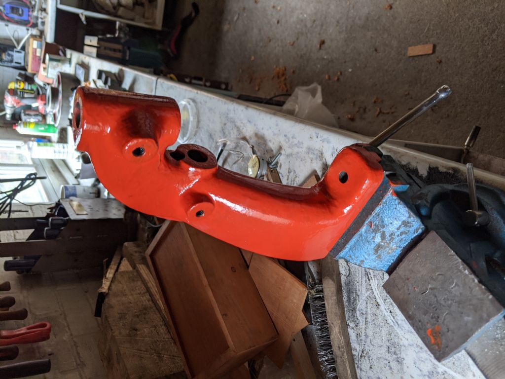

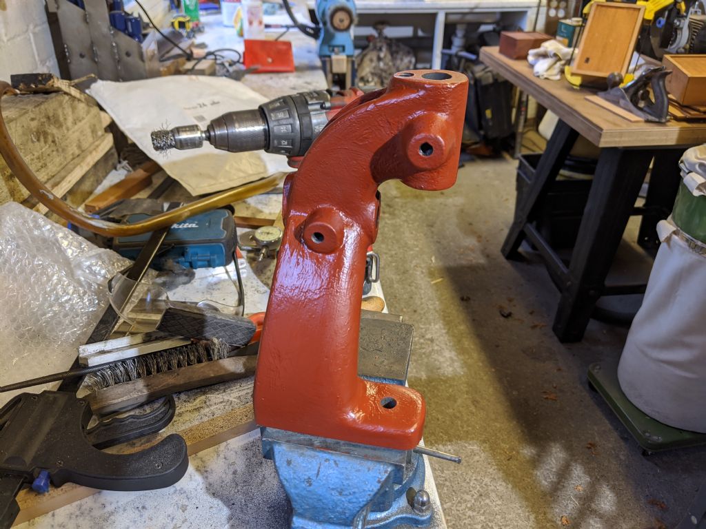

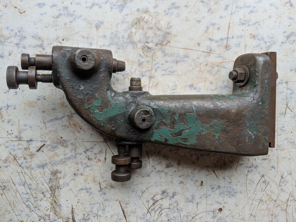

03/04/2020 13:58:28
Traveling steady is looking very orange. It'll hopefully darken a little since it's meant to be red. But it's probably only 6 or so degrees in the garage. So it's not drying very quickly at all still, I don't need it any time soon. I'll just wait before I sand it and put another coat on. Might even bring it in the house to dry
That picture makes it look better than it is. And that still looks rough

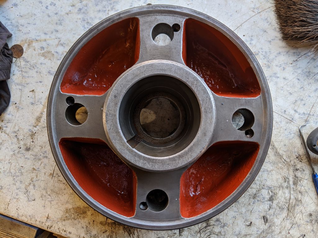

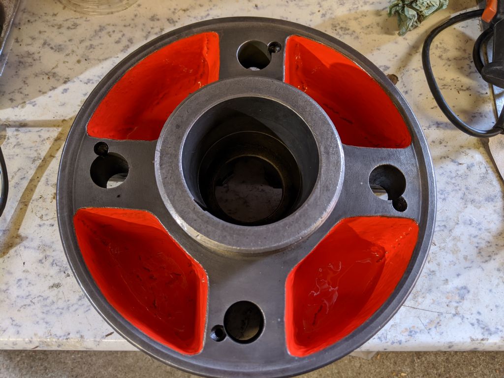

Got the inside of the chuck painted too. I think it looks very nice. Perhaps unnecessarily nice. But I like it

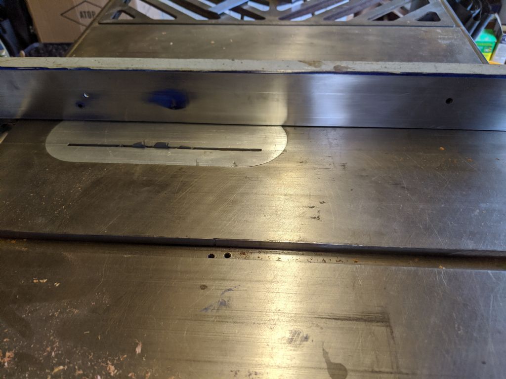

So I've blued it up
Letting that dry then I'll get back to filing it some more
03/04/2020 12:52:35

It seems like a great idea for getting things flat, but this fence is very very off. I can alter the taper just fine, but it's lengthways not nicely flat. I'll take a picture to illustrate later, but it just needs filing, to begin with at least

I did put a coat on the traveling steady, but it didn't go very well so I'm going to need to sand it back and get a better finish. I'm loving the orange/red colour. I'll post a picture when it's looking better

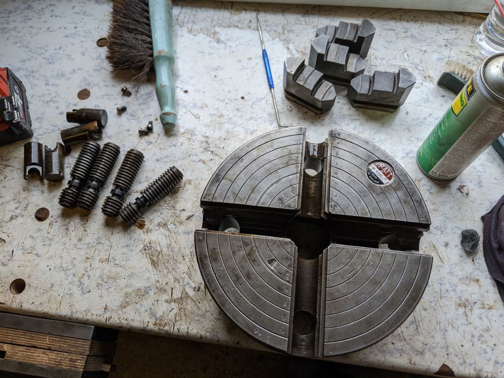

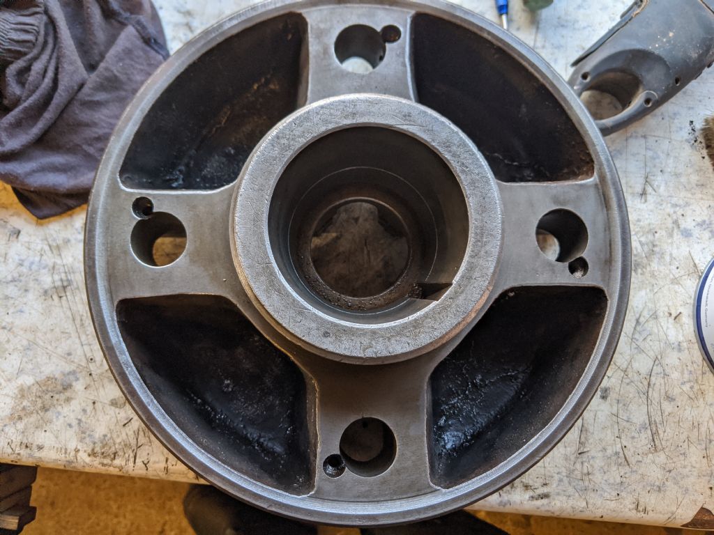

Then I took apart my 4 jaw and decided that I would repaint the back while it was apart. It needed a good clean, and I think once again the orange/red will look great. So I stripped and primed it

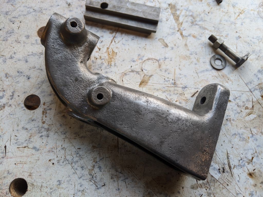

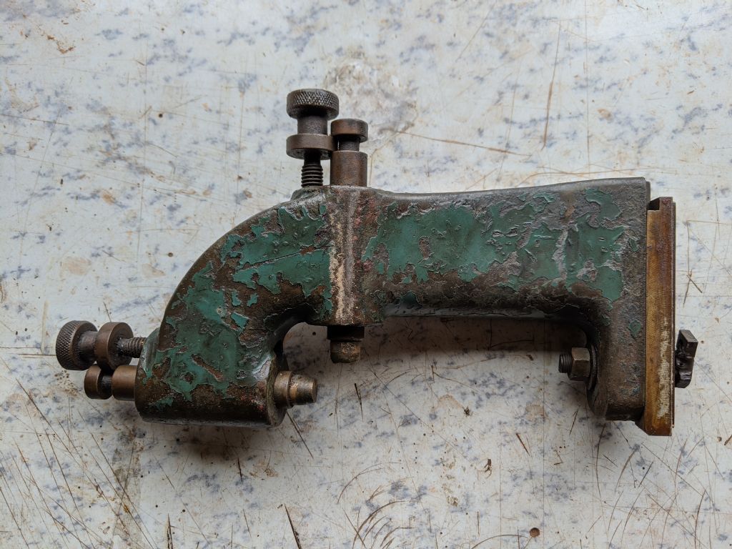

01/04/2020 19:49:12
I had some more woodworking gluing today. But I don't fancy working on the actual lathe. So I took out a traveling steady
I took it to pieces, the paint was in such bad condition I thought I would take it all off with a wire wheel
Then I degreased it and gave it a coat of tractol red oxide primer. Once that's dry I'll give it a coat or two of the same tractol I used on the coolant tank. I'd like to paint the whole lathe in that colour eventually! Just focusing on getting the lathe fixed and working first
Three phase seems like a distant dream at this point. Pandemics don't help getting things installed.
I've spotted a decent rotary converter for about the same price as three phase would cost, so I'm quite tempted by that. We'll see
Any tips for painting the traveling steady and getting a really nice finish? Just with a brush?
