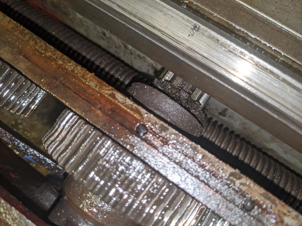

I wasn't worried about the precision or the wear. It's just anoying having the wheel move in and out.

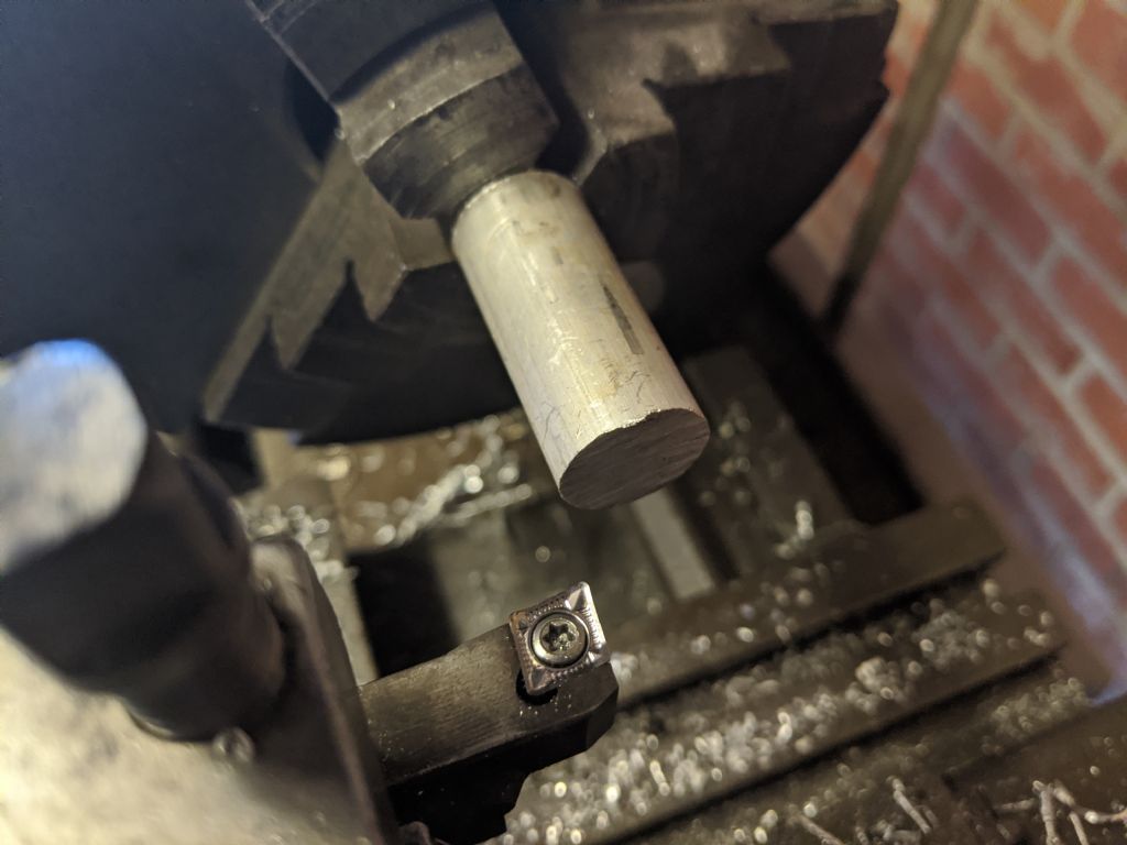

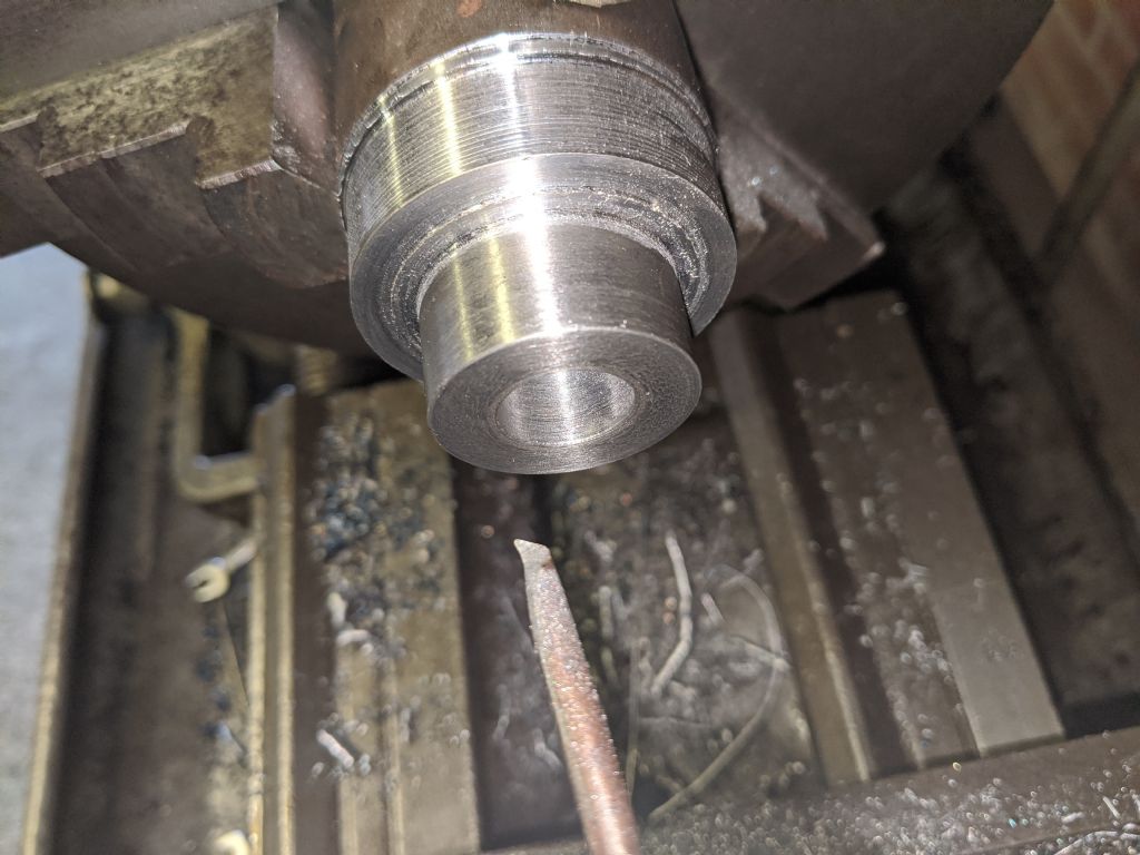

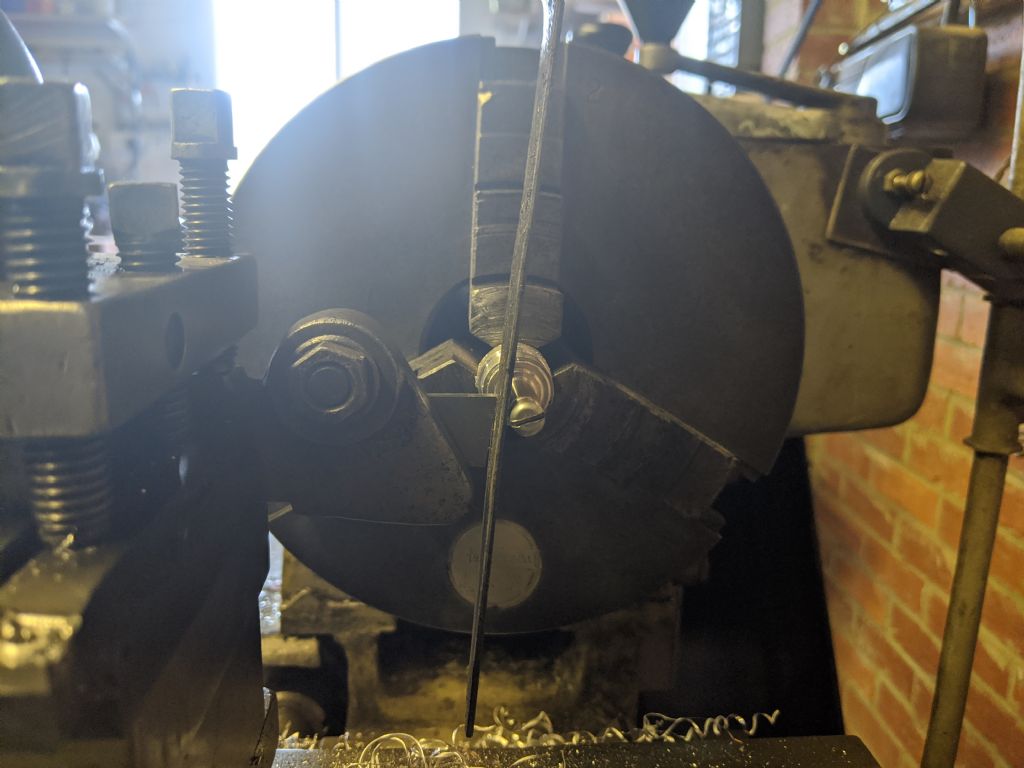

I put it all together, measured what I needed, then made the spacer. I had a play with speeds and feeds. It would be nice if I'd remembered to bring my machinery's handbook back from uni with me
Parting off is going much smoother now, so thank you for your tips. Although I am still using the carbide one, I will get back to the hss one since it's thicker and will be better for heavier work

In the video you can see where it's already been worn unevenly

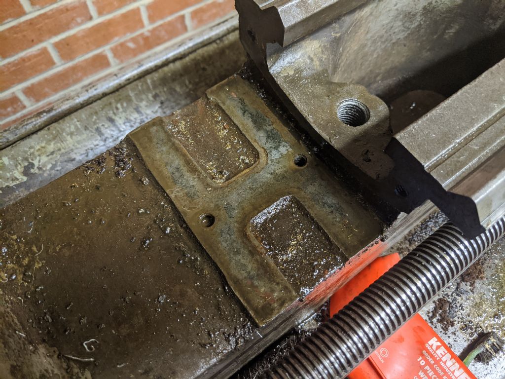

I did some cleaning today. Got everything ready to go back together. I need to measure up the size of the new spacer I need to make. Needs 5/8ths bore, then o can measure the thickness when it's all back together. I need to remove as much of the slop as possible since it's causing uneven wear on the gears.
All the oiler holes were bunged up with gunk, so a good clean should have helped them a lot!

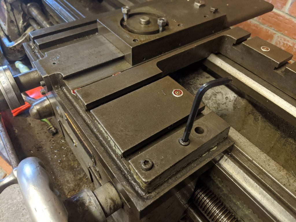

I cleaned the gap bed thoroughly, but I don't think I'll be painting it this time around. Maybe next time

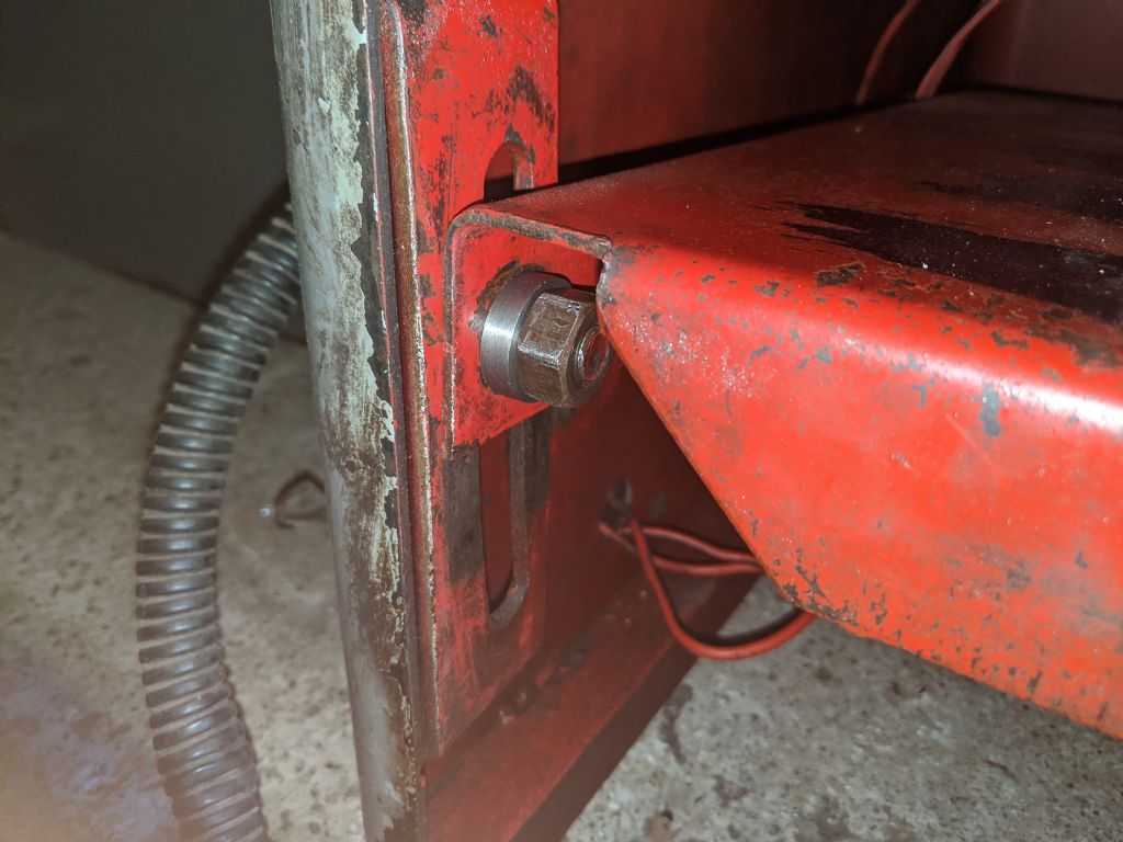

Also, I think I'm going to get some 100x100 box section steel, 5mm wall so I can raise the lathe. It's just too low and it hurts after extended use. I may as well make it comfortable.

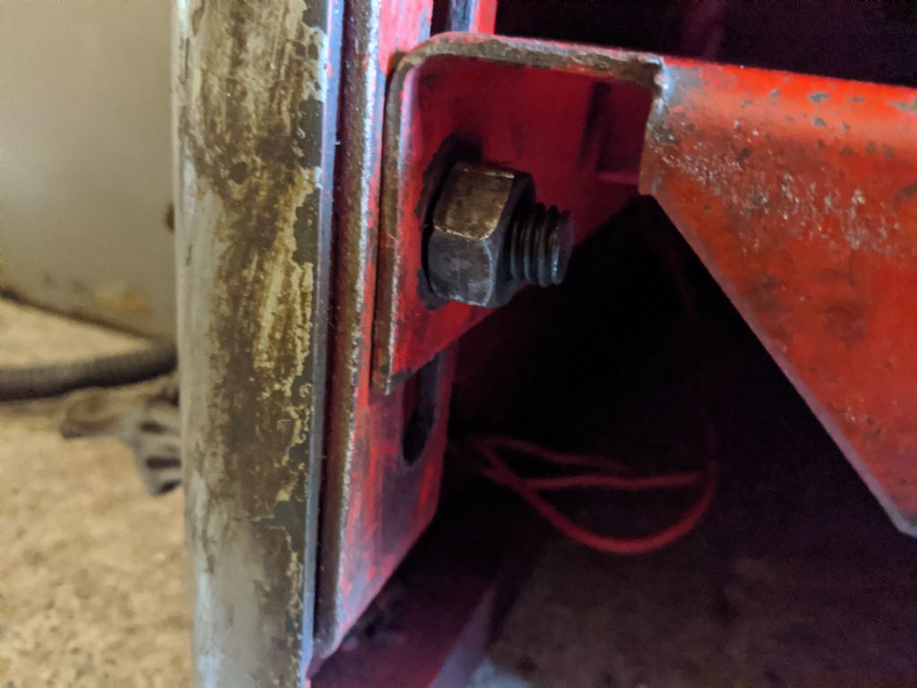

What sort of approx size shims did you use. Lxwxh? Obviously it depends how level and flat the floor is, but I'm just interested

It's not just the twist, it's also raising the lathe since I'm taller than average, it's a little low. I don't want to be crouching over to use it. Accuracy isn't quite it either. Obviously I've got plenty of time so I'd like the machine as well as possible, but that had limits. I'm not sure if the garage floor is level as well

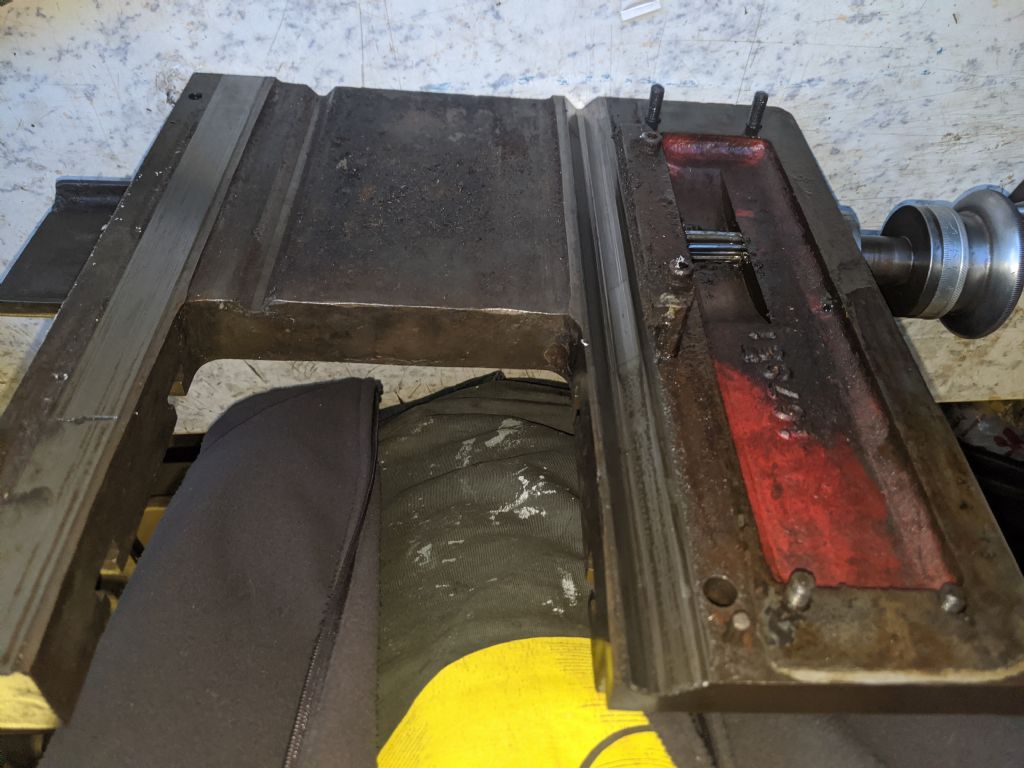

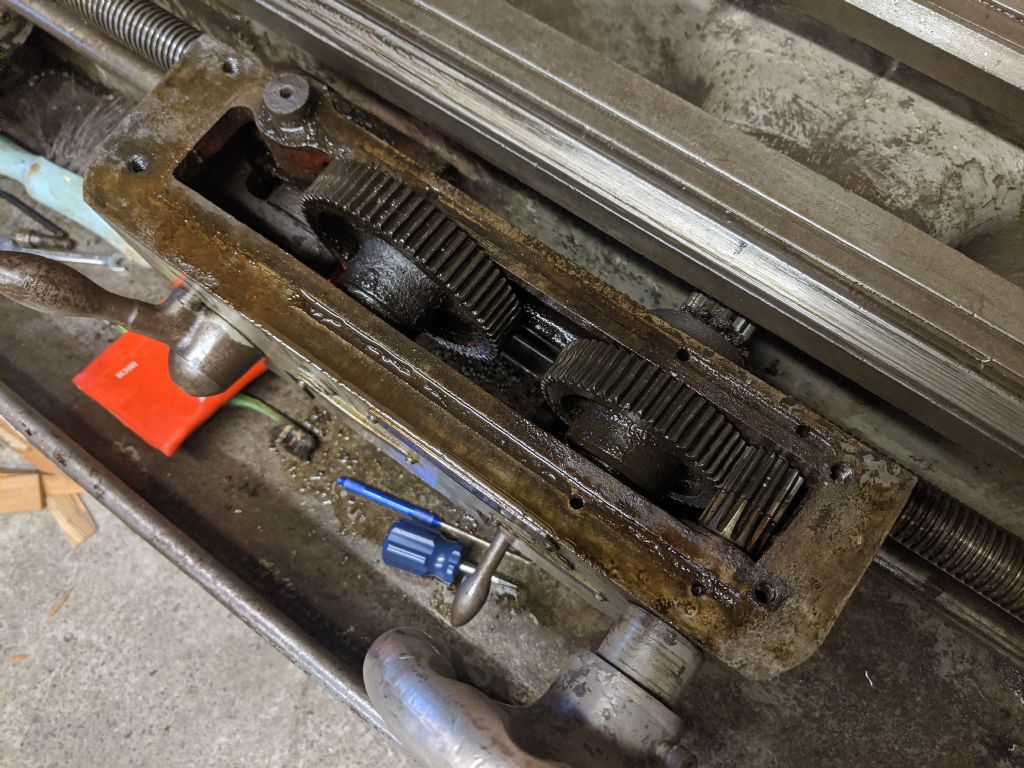

When I've been playing around with threading, the lever doesn't always want to disengage fully, so I thought I'd try to take it to pieces so I can get in to clean. Also, I wanted to look at why my main carriage hand wheel moved in and out, which is very anoying when turning. All has become clear!

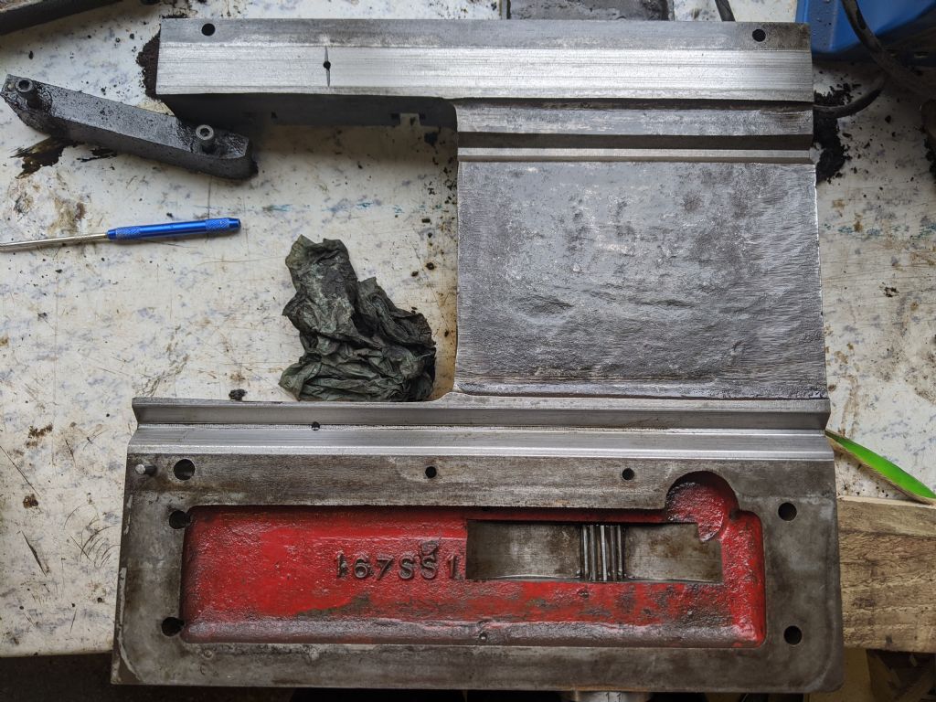

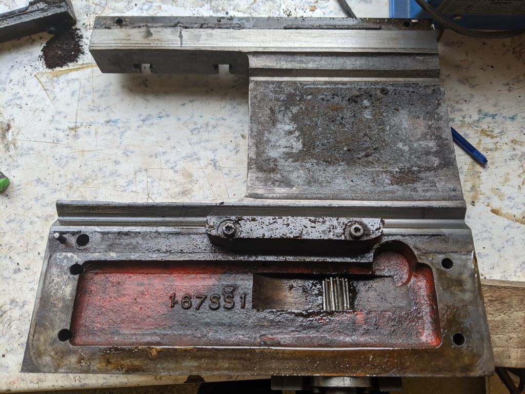

So the issue is, I can't remove the apron completely without taking the SC gear box off. So I thought I would just take the top of the carriage off and clean in from the top. So I started to take it to pieces. The holding part at the back came off first, then I unscrewed all the bolts holding the top on. This unattached the apron, but the top was still attached with a part underneath. I couldn't remove it since I didn't have access. The only way was to slide it across then lift it off once the gap bed was removed.
First time I've taken the gap bed out. I'm very tempted to paint it orange while it's out😀
I have no idea how this would be disassembled on a straight bed lathe, possible the long way round
This then let me take the top off, so I have access to all the gears. Very dirty inside as expected, I'm just wanting to get all the gunk removed and have it cleaned up
Some very thick gunk in there. Anyway, I'll get on with a proper clean tomorrow. It won't be perfect, but it'll be better than before.
I also got a look in behind the shaft that the wheel goes on, there's a circlip holding the shaft in place, but there's a space of about a quarter of an inch that's unoccupied. Looking in the manual, I'd say there should be a spacer in there to keep it from moving back and forth like mine does

The lathe looks like it has space for feet on the machine through some threaded holes. Im not sure if anyone else has seen This Old Tonys video on lathe leveling, but he has a student mk1.5 and it has 6 feet to allow for leveling?

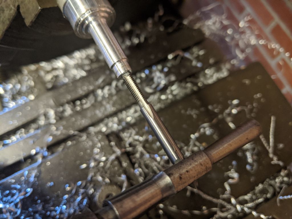

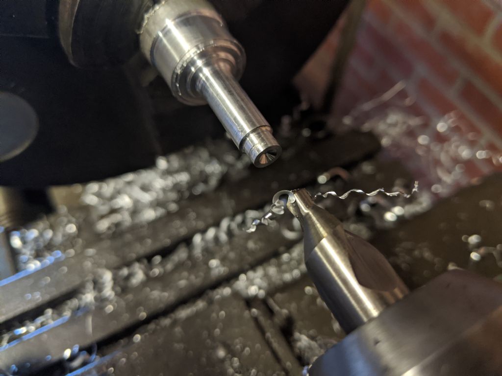

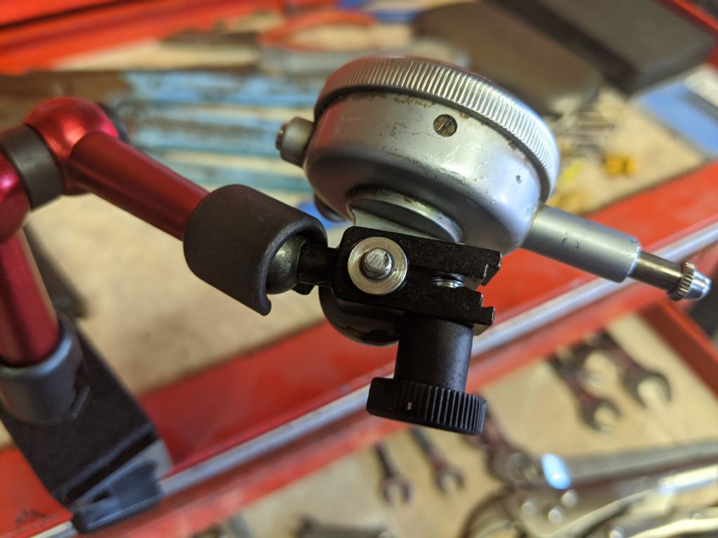

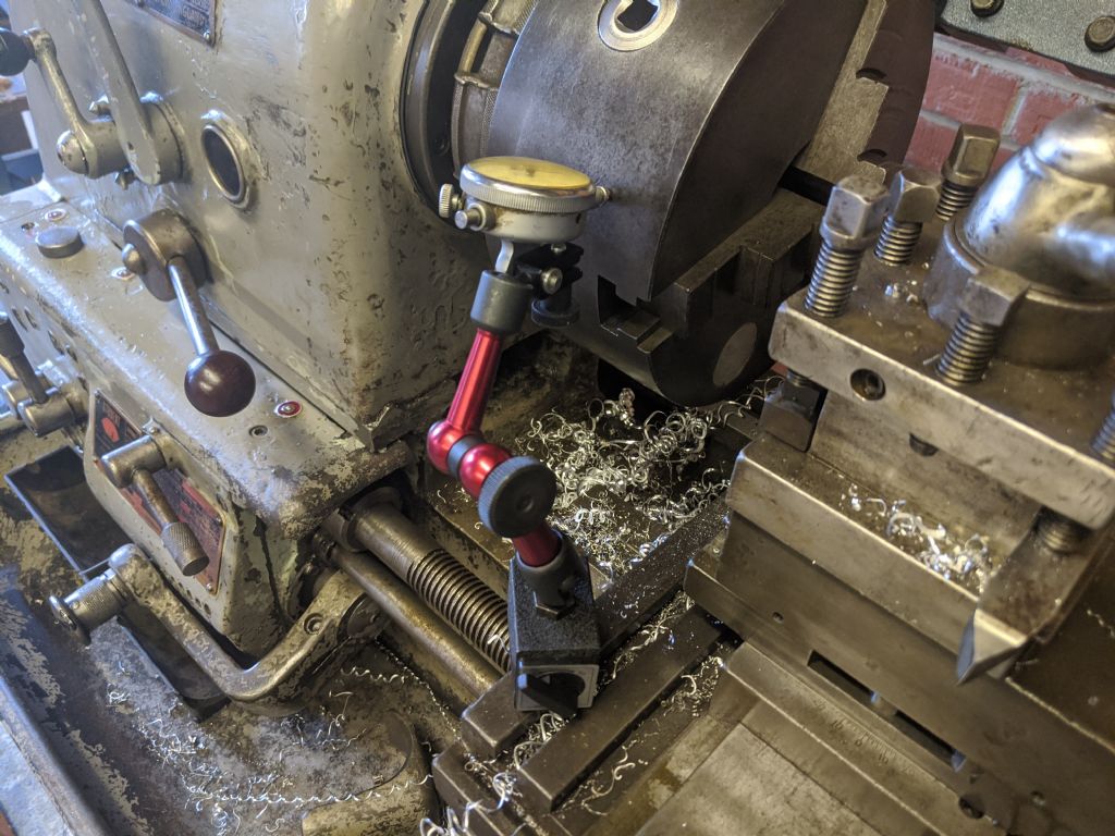

I made a mount for my indicator today, although I'm not sure it's on the right kind of stand, it's works for me
I used a weird insert I found on arc euro trade. It said it was for non ferrous metals so I thought I'd give it a try, it did a good job I think
I turned around 250 thou end for the indicator to sit on, then turned the rest to fit in the holder nicely
Drilled the end out to 3.3mm for a m4 thread. It was nice to finally get to use my taps. Although they were too small to use a spring center, it went in very well by eye

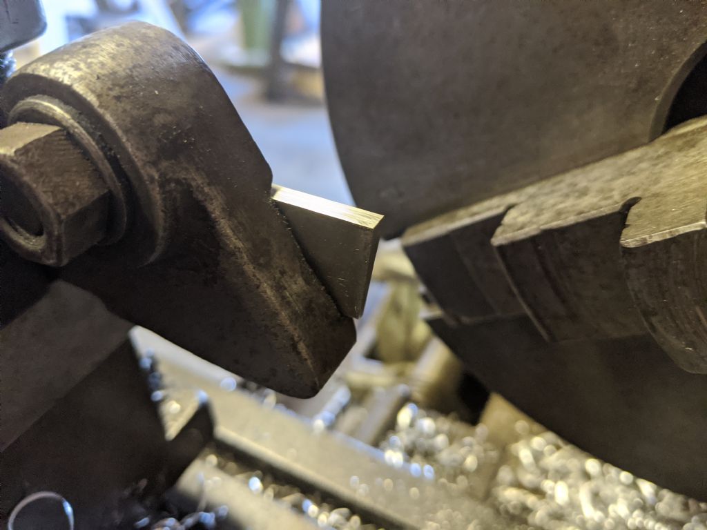

I had a play with my has parting off tool, ground it to how it was suggested, then I played around looking at the center height. It was a long way off, too high. I used the flat bar trick thing. I did try to grind it down a bit but it was taking too long. And since it was such a small part I decided to use my carbide parting off tool which was under center so I could shim it to the right height. It worked like a dream, 120rpm or so, hand fed, very slowly, with plenty of oil. Only aluminum so not too hard, but still good practice
When I parted off yesterday I used the other end of the tool which was lower, but I didn't check the height of that, so I don't know if it was or wasn't on center. Guessing it wasn't since it went so badly yesterday.
It fits! A nice little project

I'd never realised what a rear tool post would be for, I'd seen them before on listed lathes and things but it hadn't quite clicked. So that's very interesting!
Zero top rake sounds good to me, no angles to deal with!
I'll attempt this and report back. What sort of speeds should I be looking at

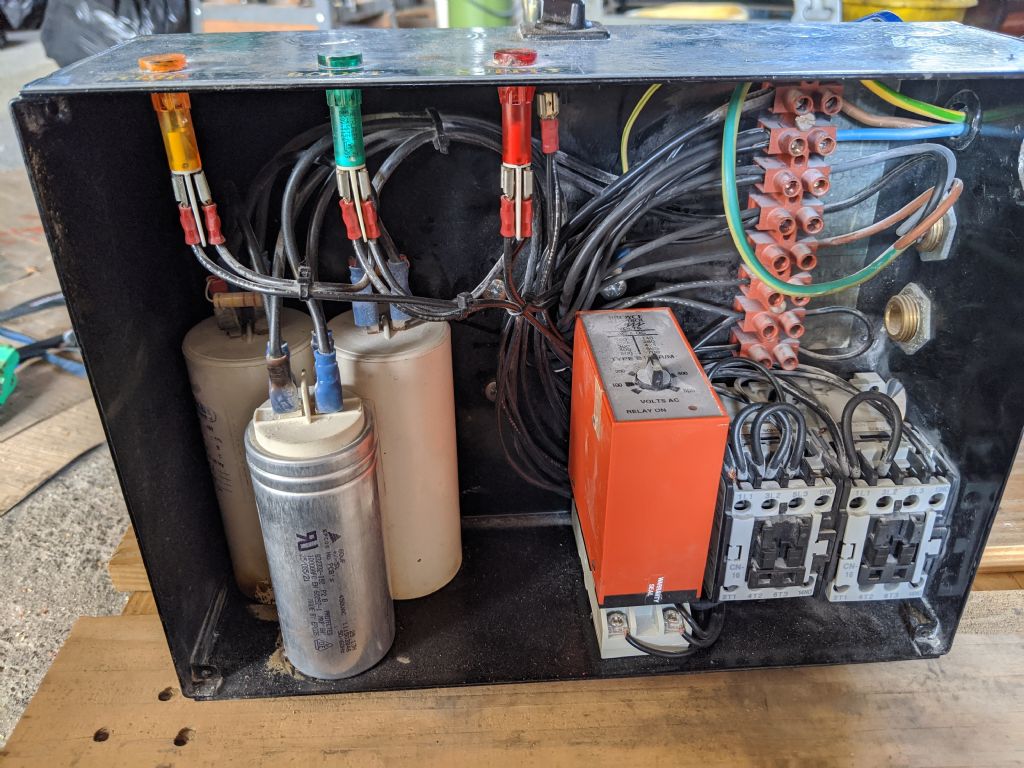

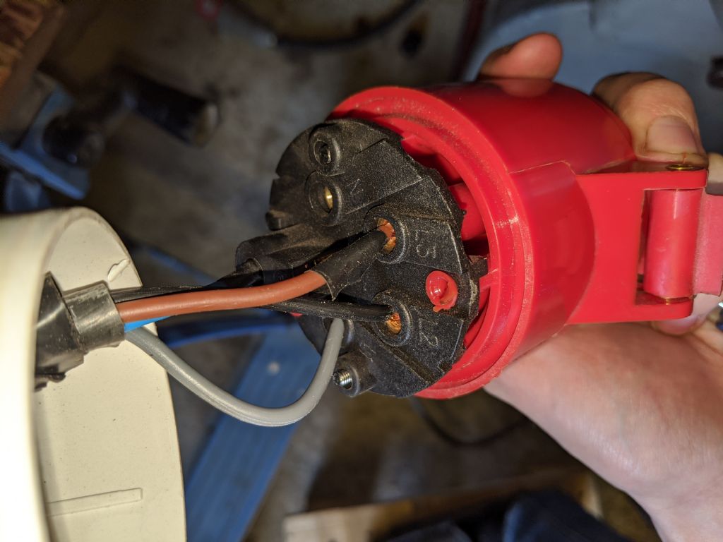

Those wires are the ones coming out of the back of the isolator. I'll look at it tomorrow. Why would the phase converter be damaged from the lathe wires being damaged?
Any thoughts on why the lathe doesn't always switch on? Could it be the switch contacts?
And any thoughts on why I don't hear the contactor pulling in like a big clunk like your one did?
And does the coolant pump seem very noisy/ growly to you?

As for grounding, the only grounding there is is coming from the plug to the box that those wires go into. Here
Also, my dad is concerned that the lights flicker for a second when the phase converter is turned on, and then again when the lathe is turned on. Could you explain why this happens?

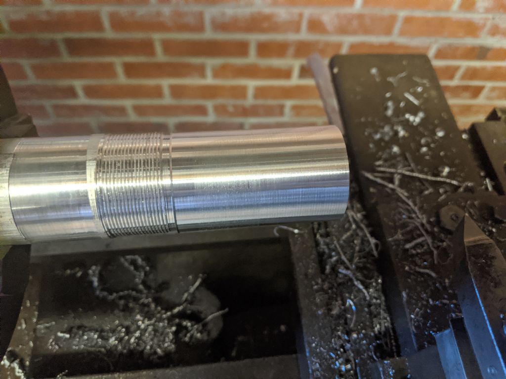

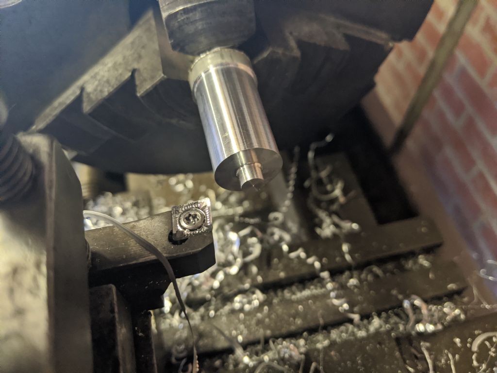

I played around with some aluminum, just turned the end part and did a large 4tpi thread on the end. I didn't have the thread gauge on the lathe so I just left the half but engaged. But it went well. I forgot to move the tool back out a few times so it made marks on the return since the threads have some slop in so they don't line up back and forth
Taking a cut to remove some surface marks from messing the thread up!

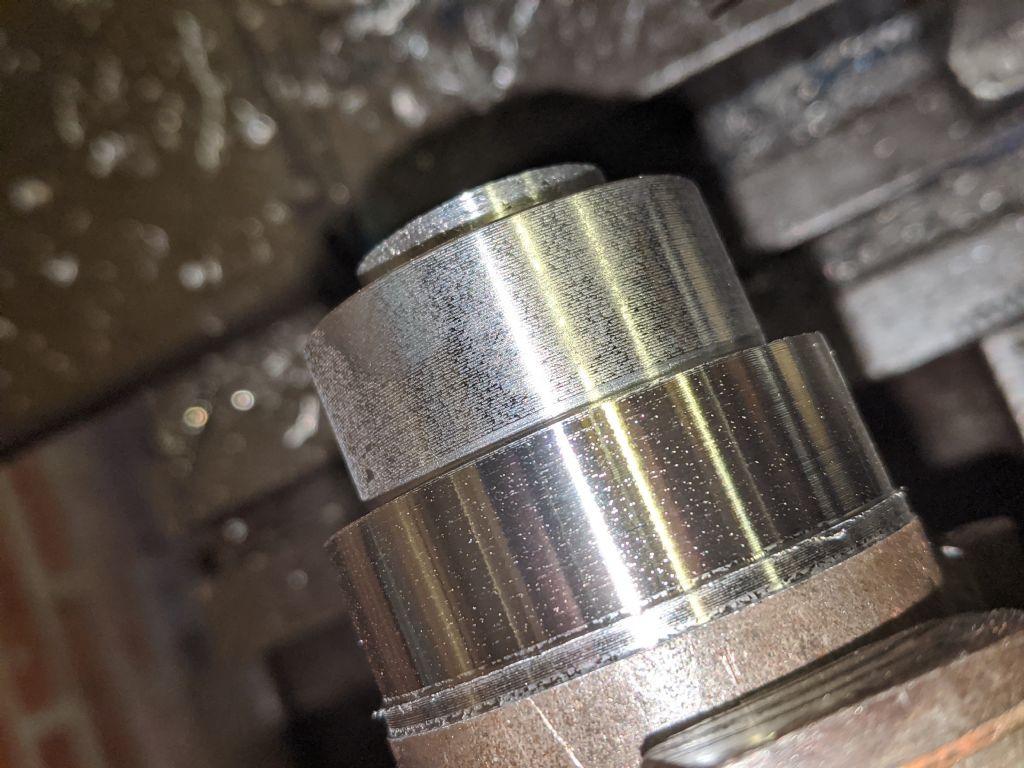

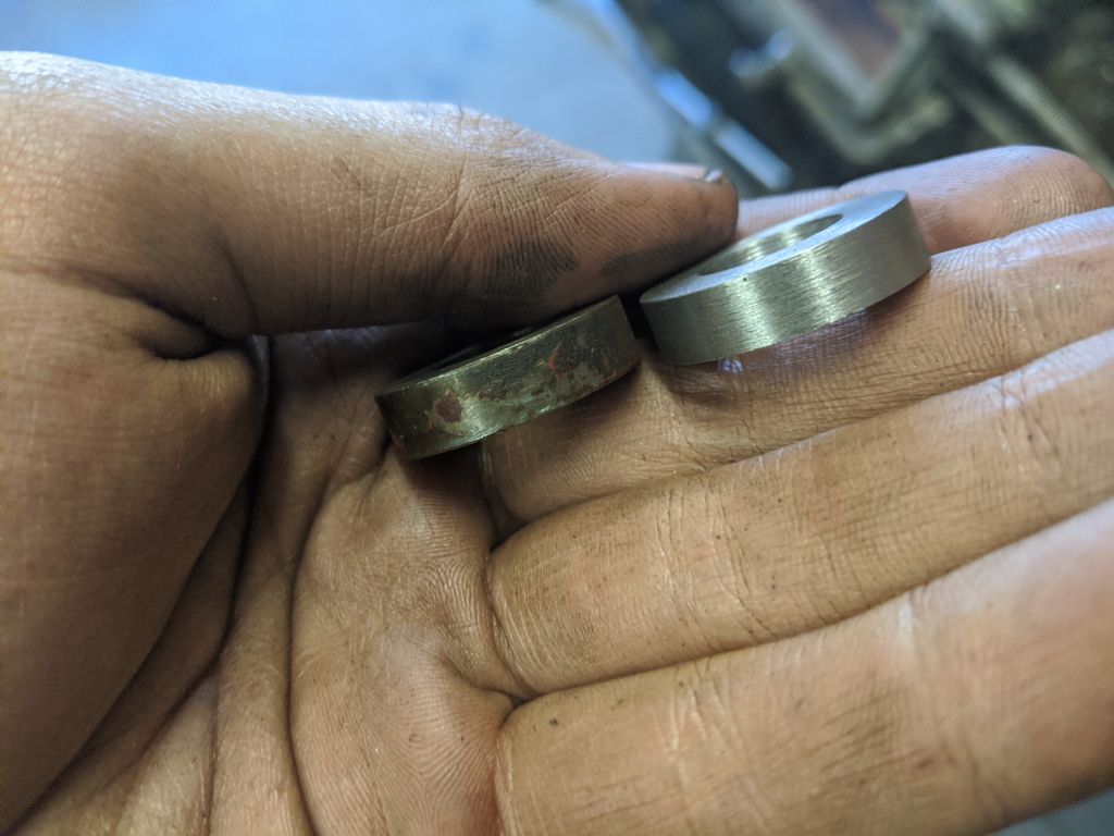

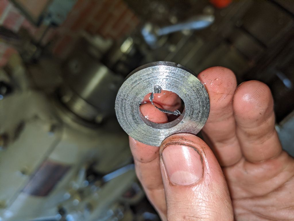

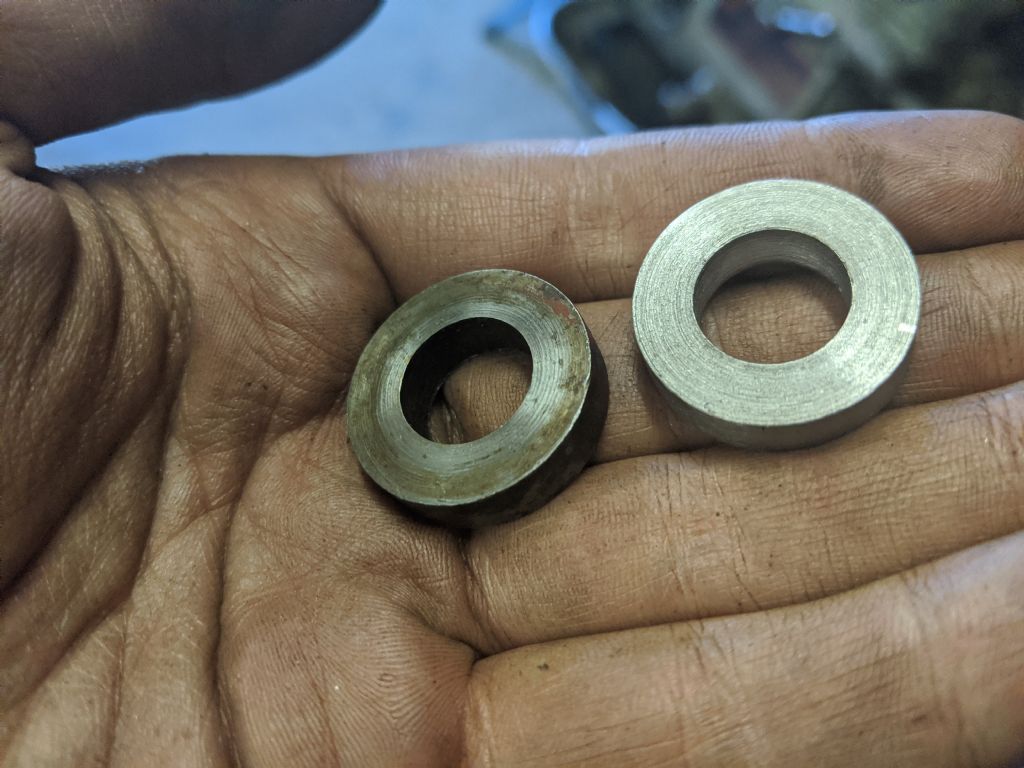

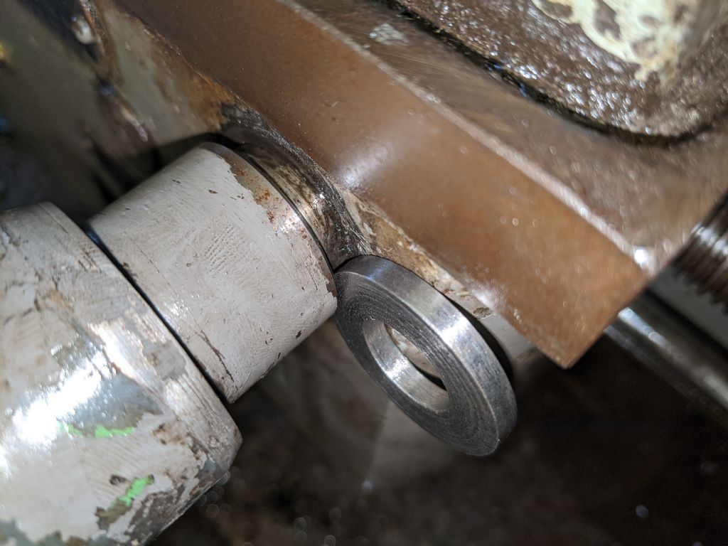

As I said I would, I made a spacer to go where the missing one was. It was fun to try and get them to be as identical as possible, but was difficult with my available tooling(no boring bar big enough and not a drill bit the right size) still, I managed

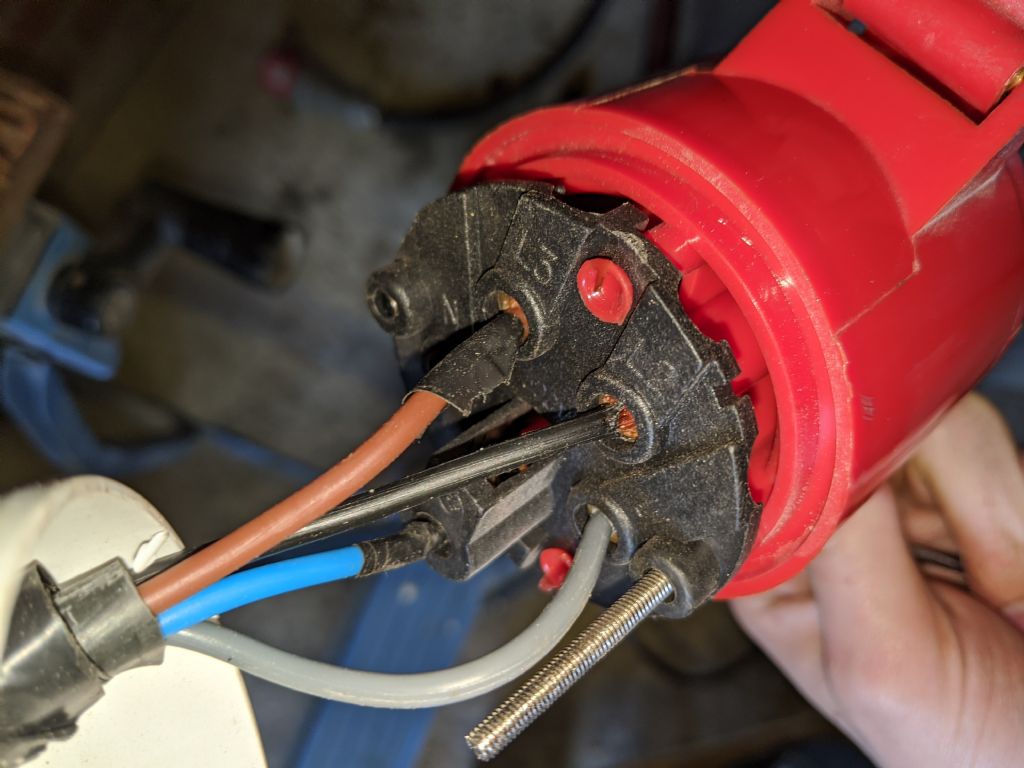

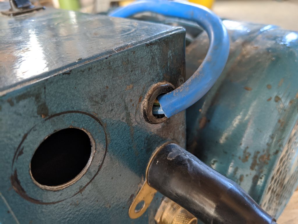

06/04/2020 20:07:17

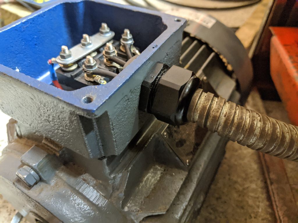

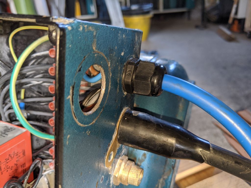

I took the motor out and put that spare gland I had on it. It's holding the conduit very well. It's not the stuff that threads in, but it's doing the job
I'll keep the motor out for when the socket arrives tomorrow. So I can just test without a load. I'm pretty happy with the converter so far. Much more satisfying to turn on than the Clarke static one 😄

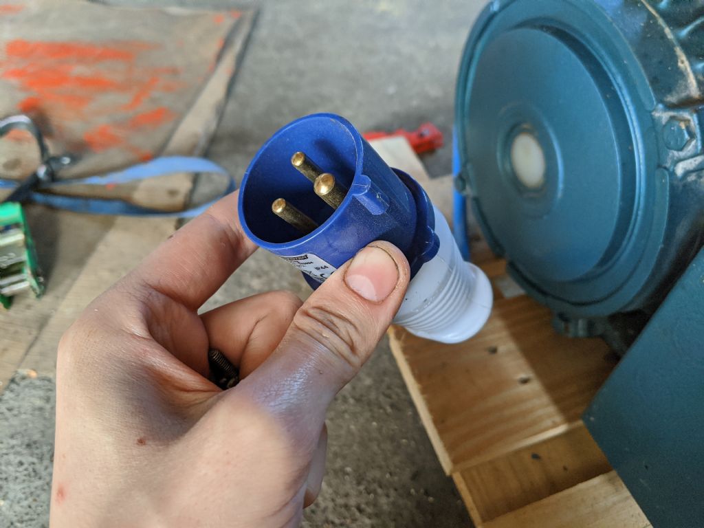

Are there any safety advantages of putting a 32 amp plug and socket on instead?
06/04/2020 12:39:08
I'll check continuity later
The socket on the machine is 5 pin 3p+E+N but the converter doesn't have a neutral and neither does the lathe
So, do I get a 4 pin 32 amp socket to fit to the machine and get a 32 amp 4 pin plug to go on the lathe(up from the 16 that's there, although it shouldn't be drawing anywhere near 16amps) Or can do I need to change things around?
I don't know if a 16 amp 415v plug is smaller than a 32 amp one though?

06/04/2020 11:27:04

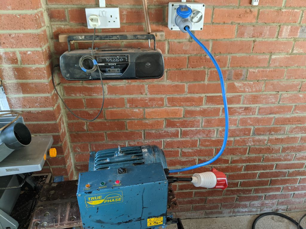

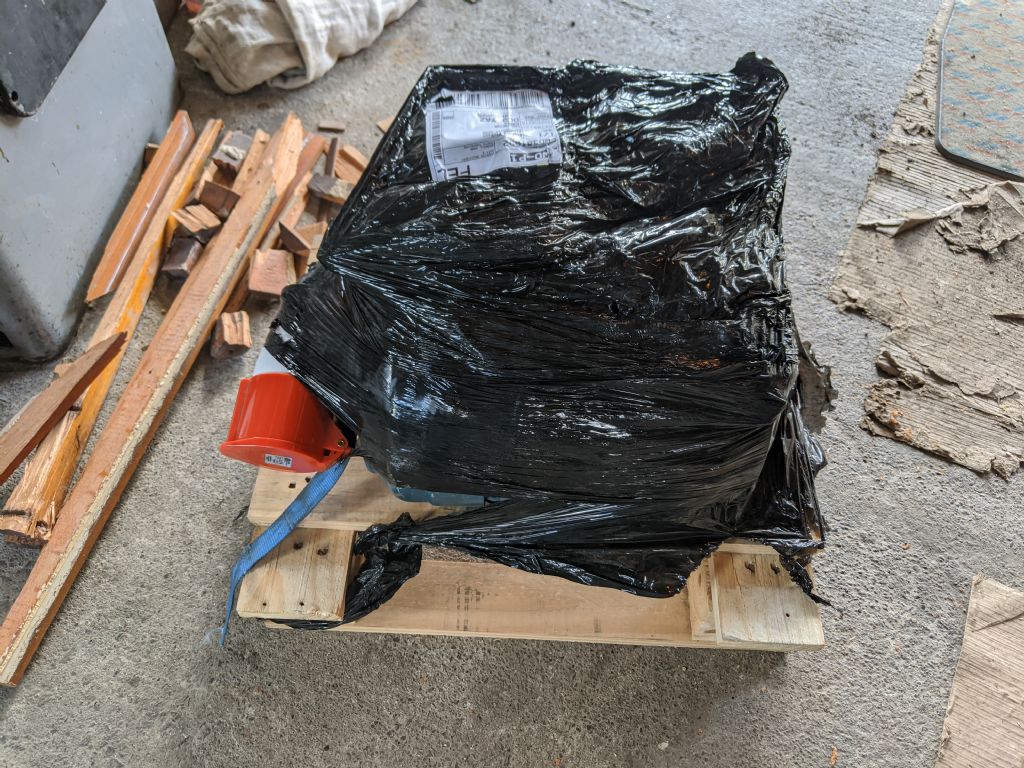

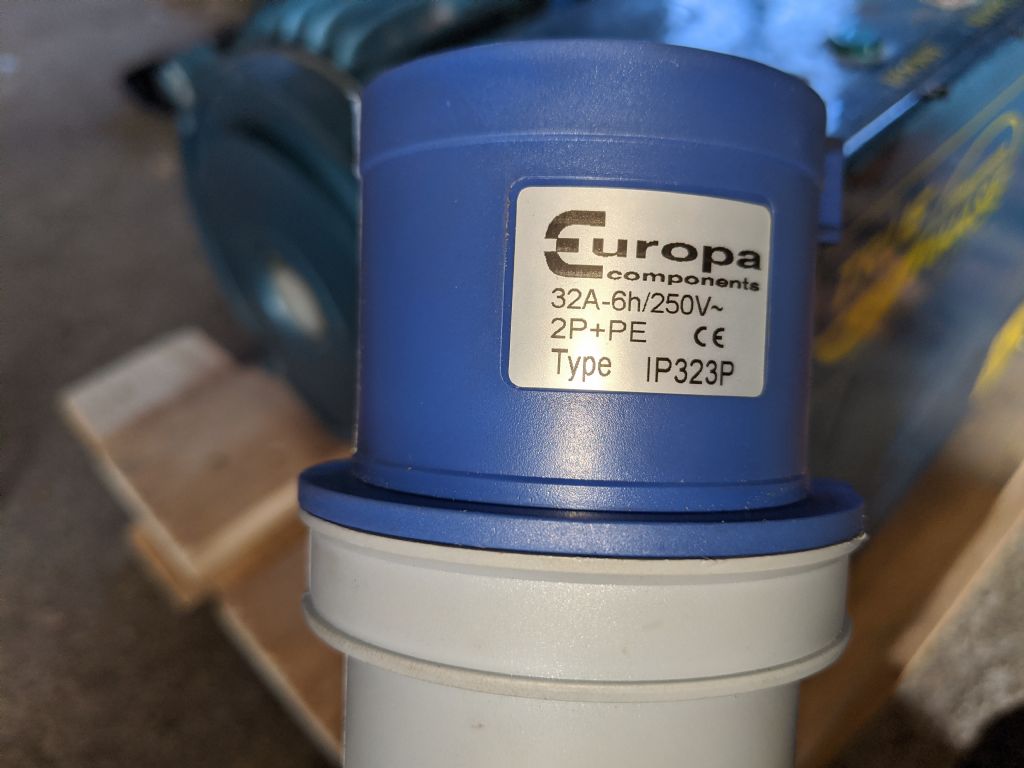

We have a big blue box. As expected we have a 32 amp 415v ket on the end, so can't plug and play. Where can I get a 32 amp plug today? Especially with lockdown
I've swapped the 16amp plug on it for the 32amp one that had left over from the Clarke converter also noticed that the connections from the box seem a bit off, so added a gland to secure it since had one spare. I'd like to fill in the other holes to stop dust getting in
Plugged it in and it seems to turn on just fine. Better than I thought it would. I'm surprised how quiet it is

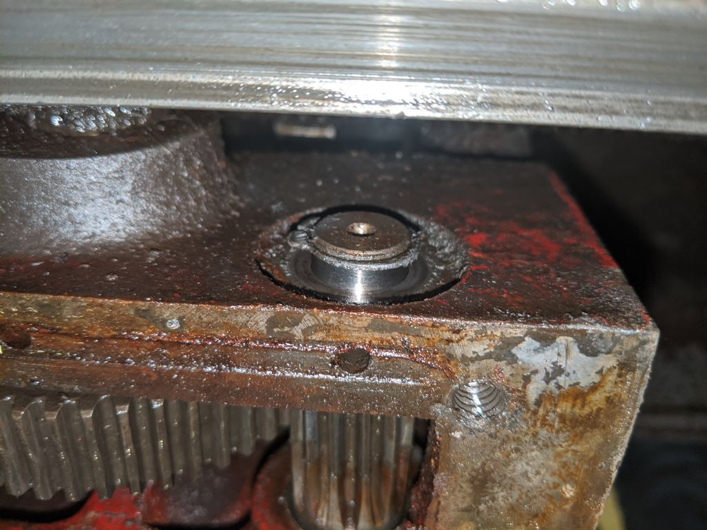

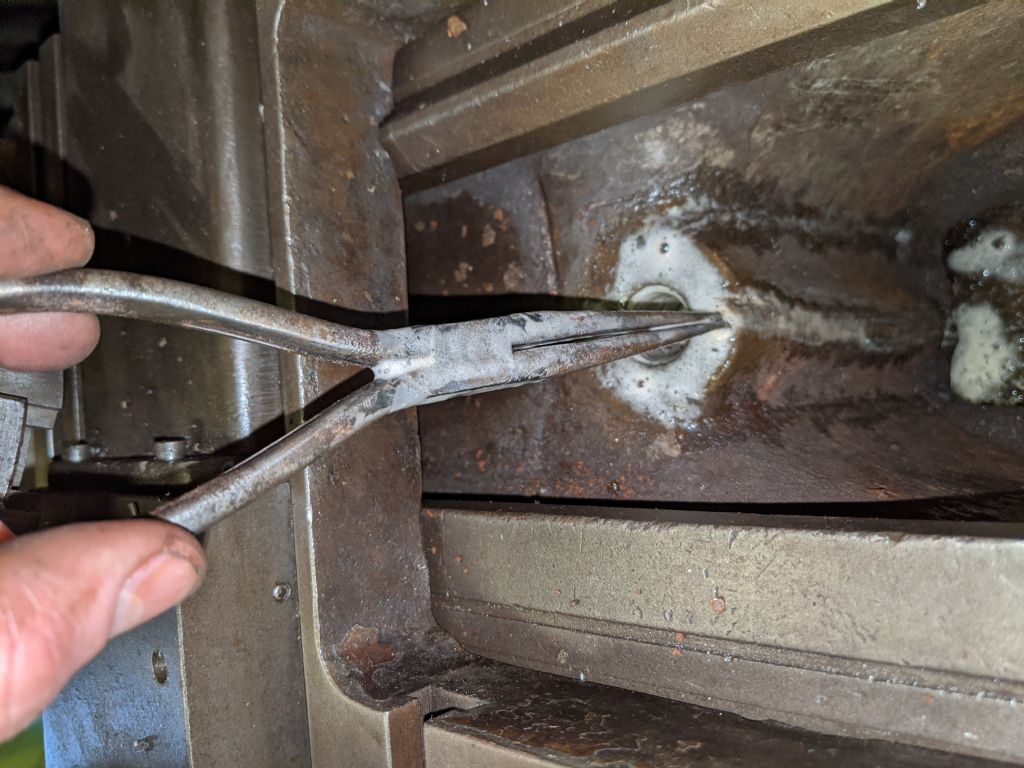

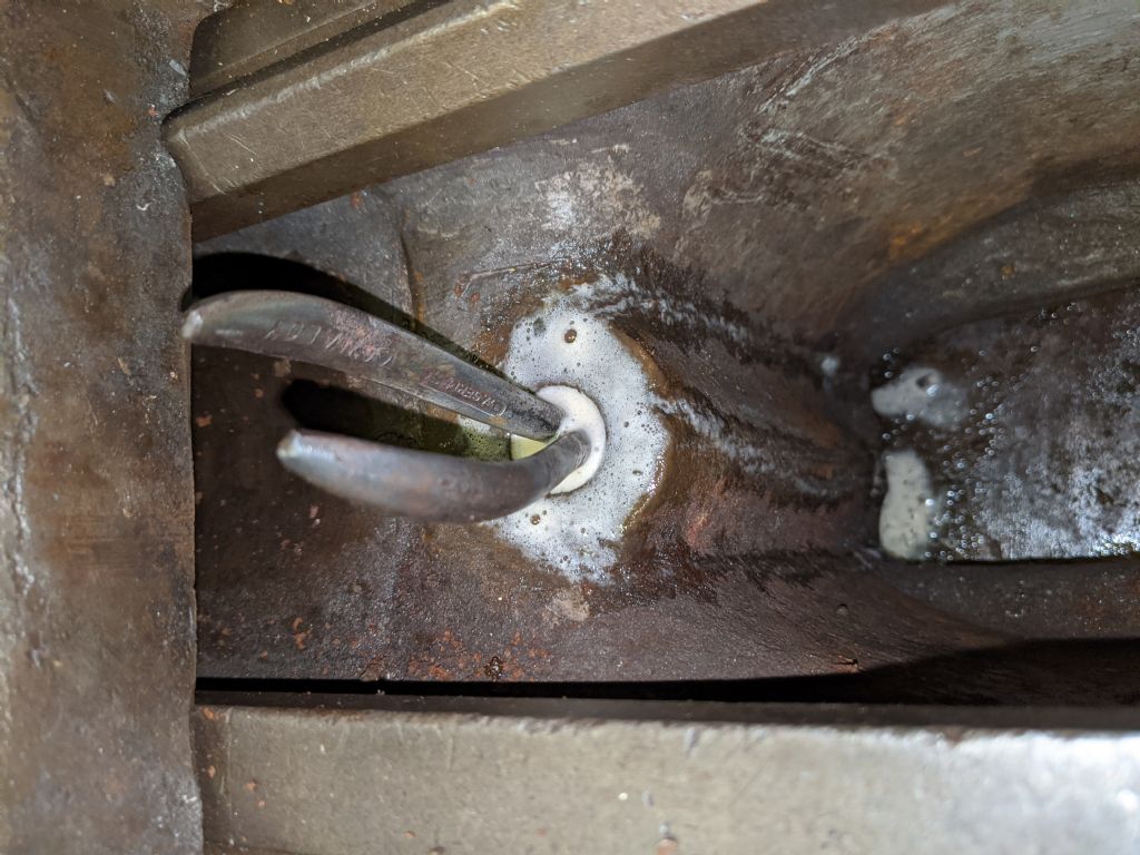

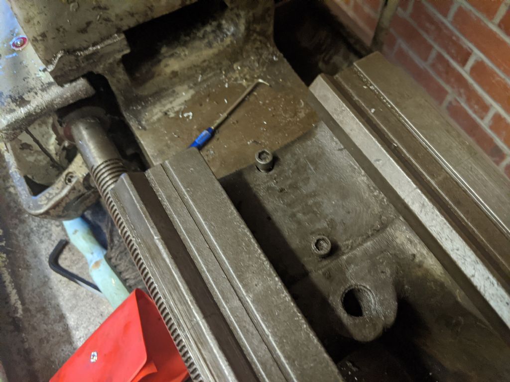

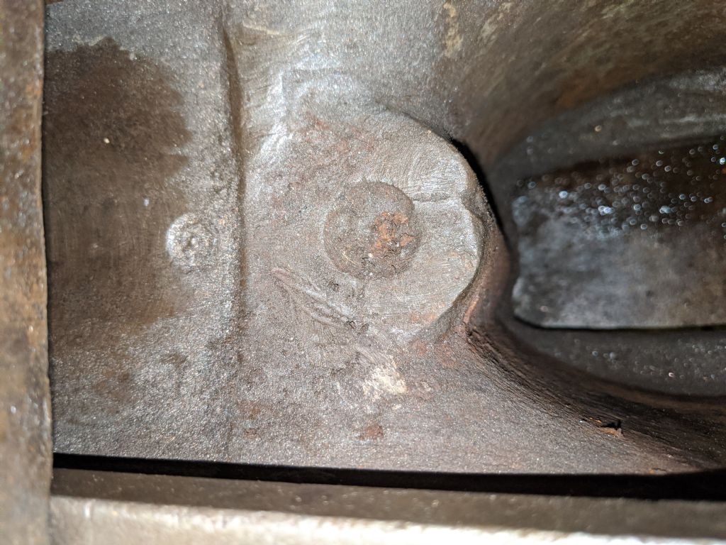

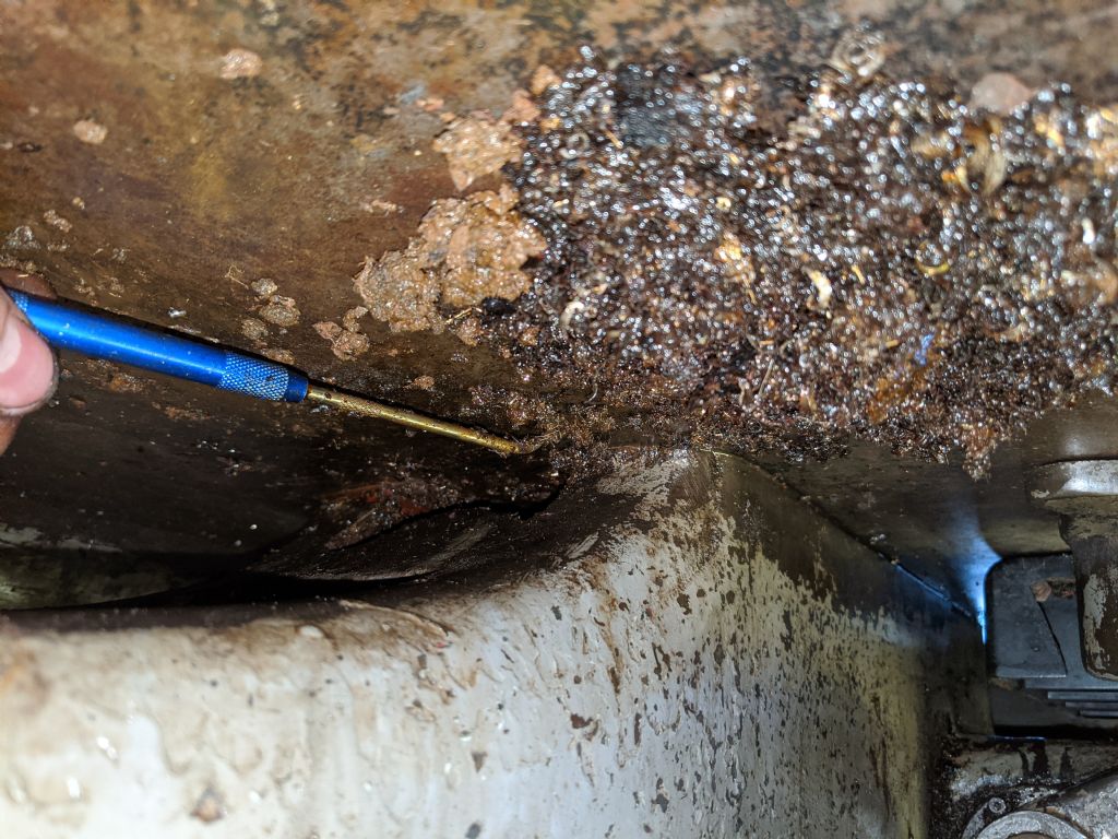

Just did a little cleaning today
Found a hole that I thought was going to be a bolt head or something, but it turned out to be a threaded hole and about 4 inches deep. It's just in the lathe bed. Not sure what it's for? It was full of crap, but I got most of it out
Just showing the depth
Then below there are some holes which I managed to clean a lot of stuff out of
Upside down, but you can see the gunk

I think the converter has a 32 amp socket on it, but the lathe has a 16amp plug. Don't know for sure yet, but I'll find out. Might need to change it somehow?

Converter didn't arrive, even though it said it was out for delivery. It'll come on Monday

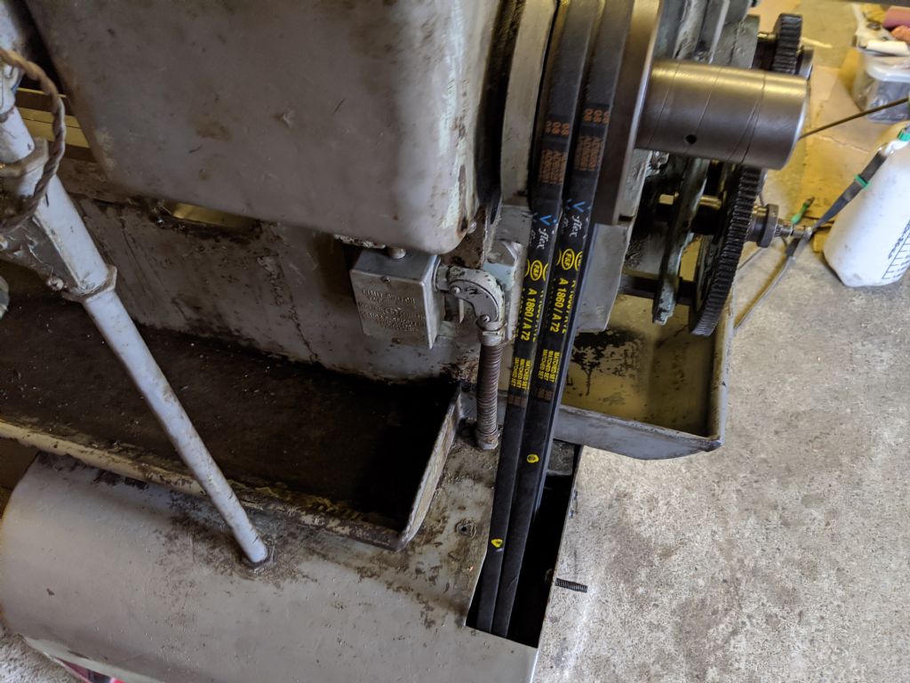

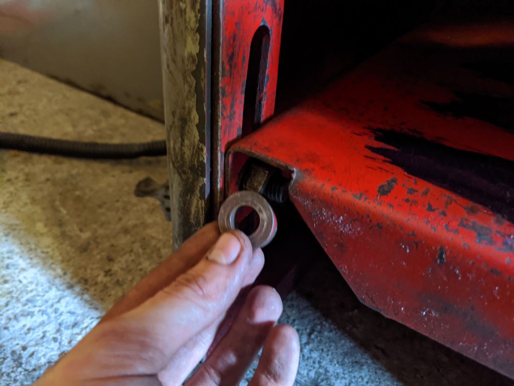

In preparation I fitted the motor properly in location and the belts, fits much better than the old belts and allows for changing of the tension of the belt
the motor plate only has one washer, so that'll be my first project, to make a secondimg_20200404_111427.jpg
