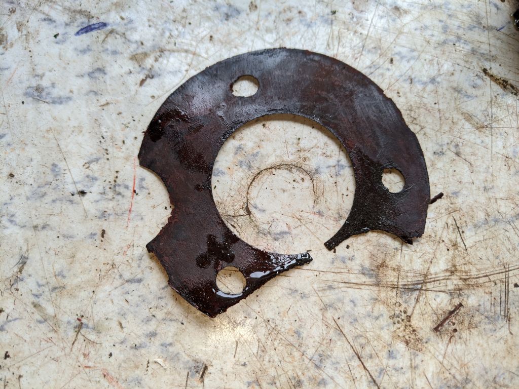

That seal I linked to has almost exactly the same number as the old seal, just one more zero. Maybe I misread it.
I've remade the gasket and it fits perfectly. Undersized holes in the gasket to make it stick to the bolts and be easier to install

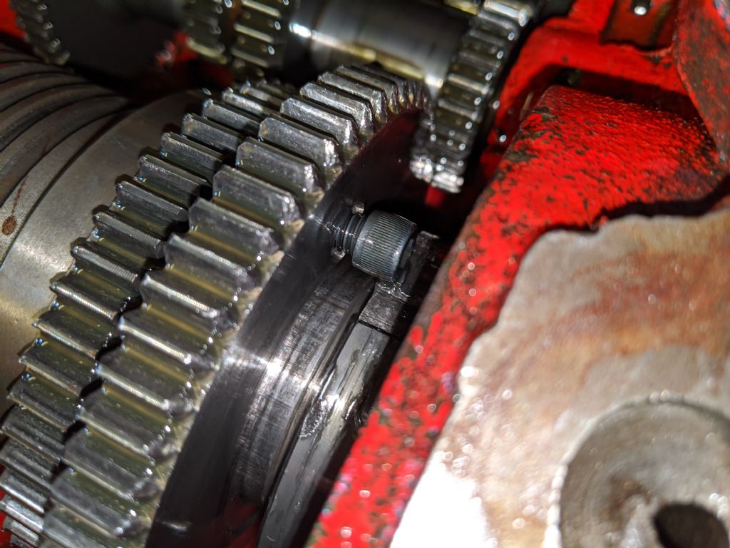

Then I was playing in the headstock just moving the gear selector back and forth. I noticed it wouldn't move all the way. Turns out one of the bolts had come very loose! Very bad news. I must have not done them up tight enough when I put them back in. I've tightened them all very tight now, but its worried me quite a bit.

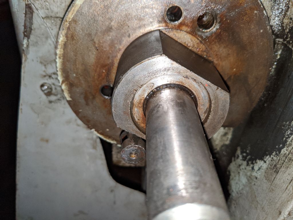

17/05/2020 15:58:17

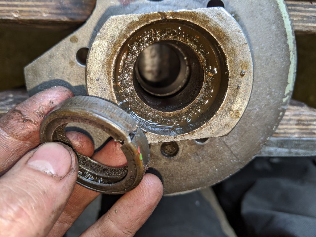

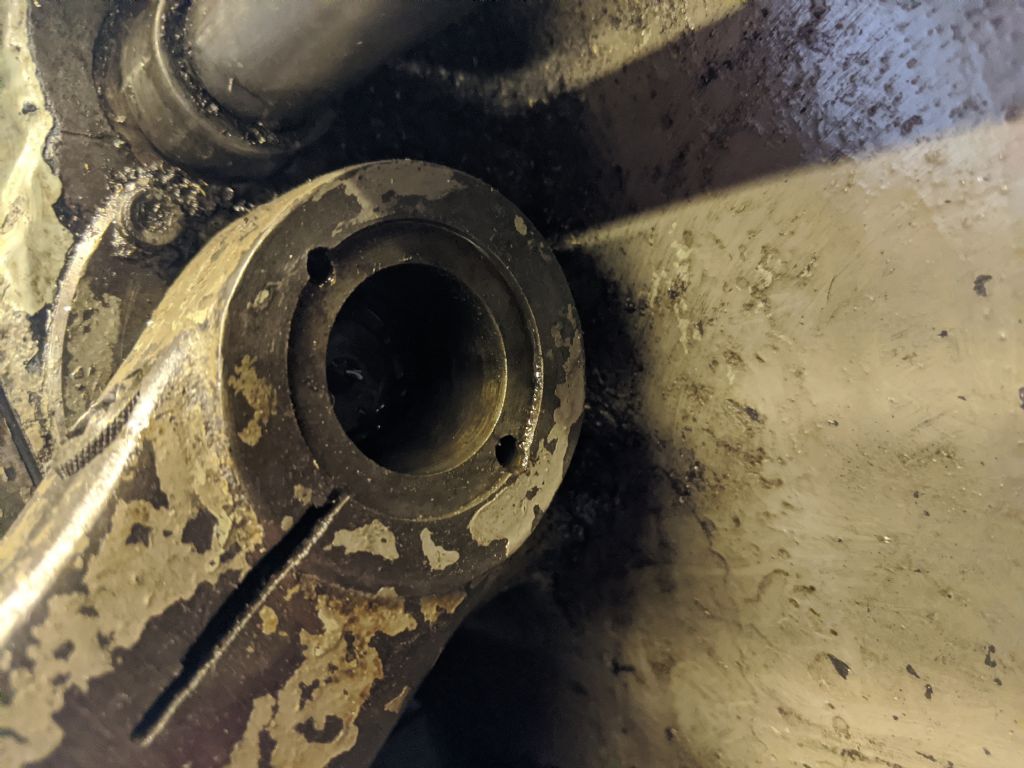

Thanks Herman, very useful, I'll go for a seal like that.

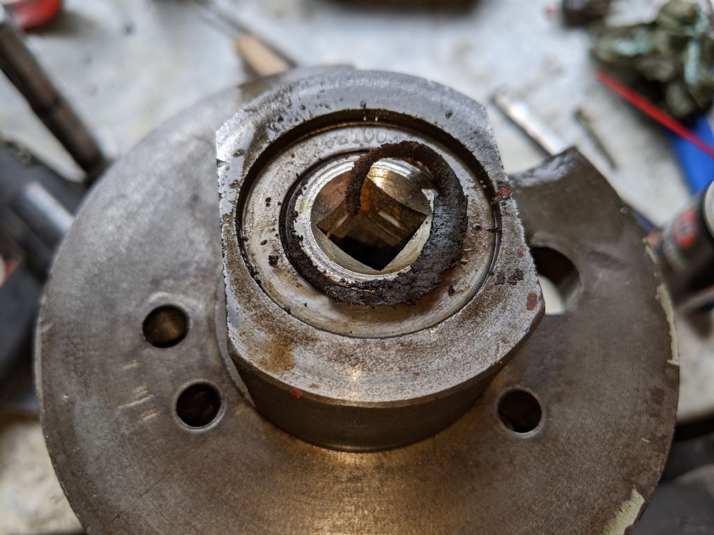

I got the numbers from the old seal, 16210037. I'll just find a new one with the measurements I took

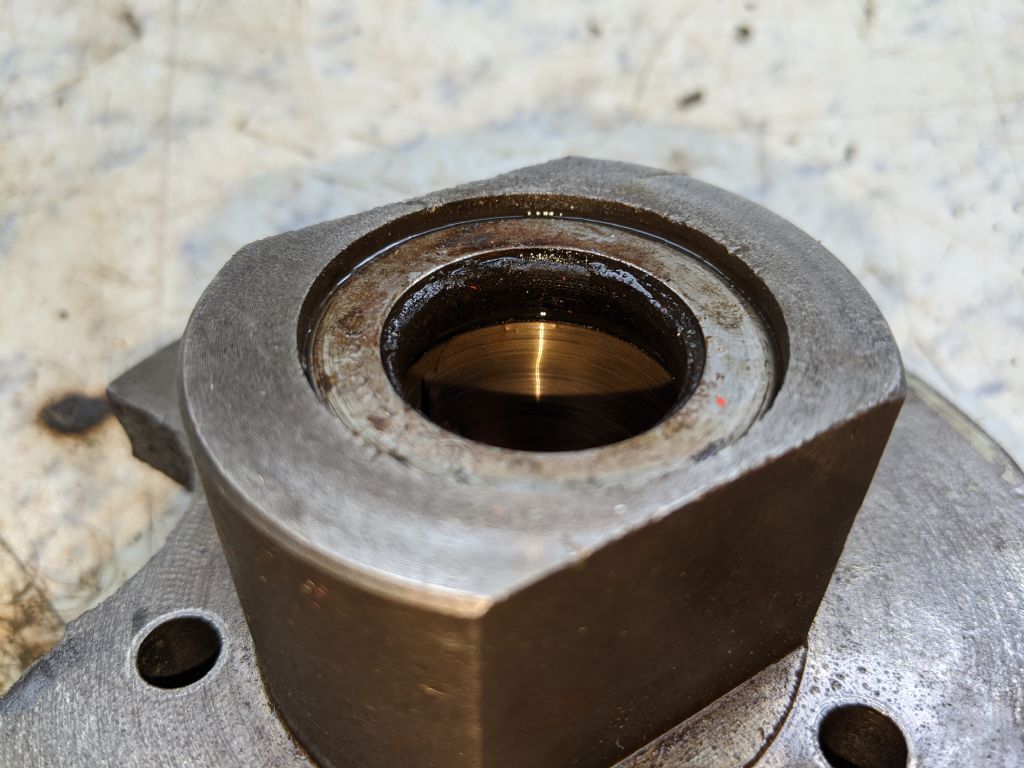

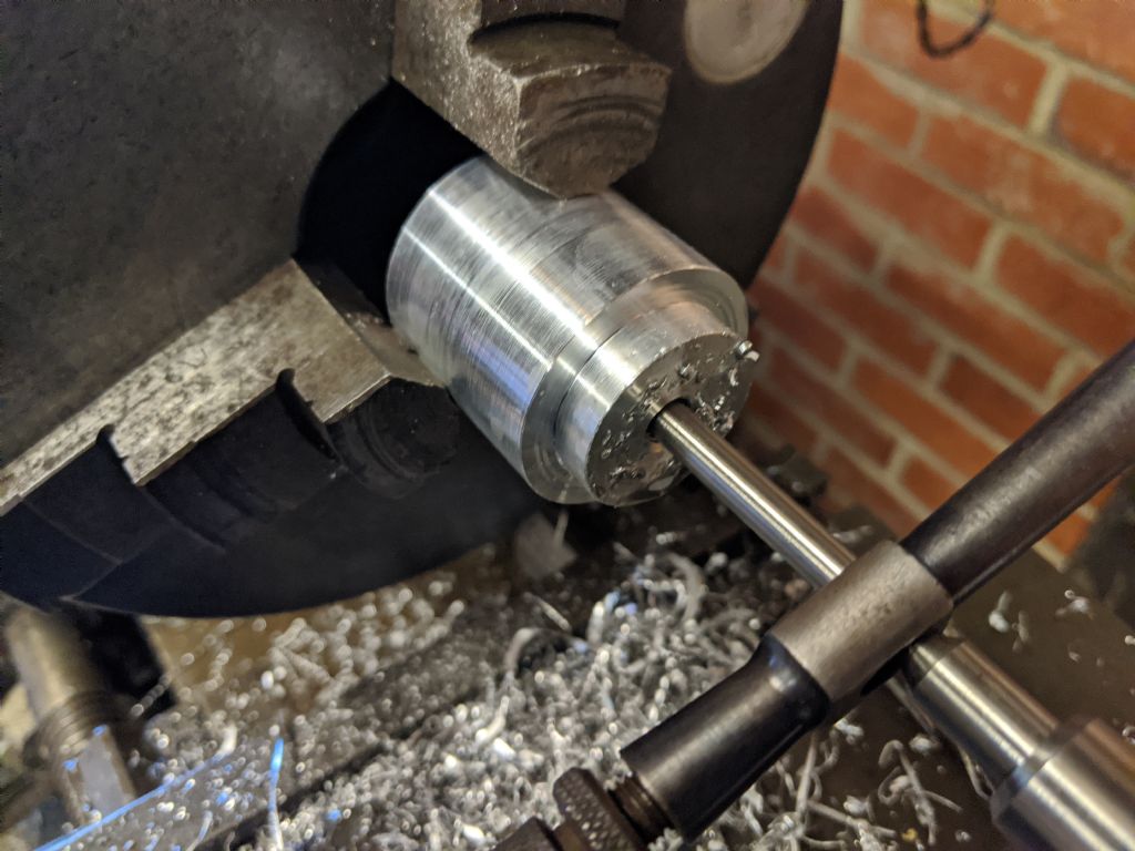

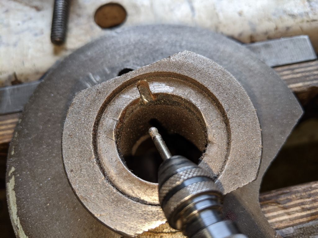

Anyway. I started by trying to use a socket to push it out from the inside. This didn't work well as it just pushed out the leather and messed it up. Not a good start.
Immediately that stumped me as I couldn't get any grip on it any way or tap it out from the inside as it wasnt working. Too tight in there. So I resorted to using my rotary tool to cut away one section of the seal to release the pressure and allow it to come out
This worked quite well but I went a little too deep and took a lttle out of the bore, but that shouldn't make a difference really.

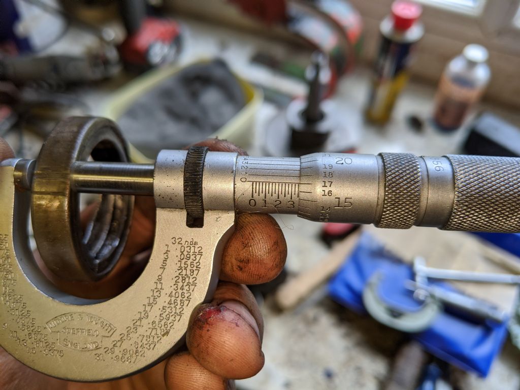

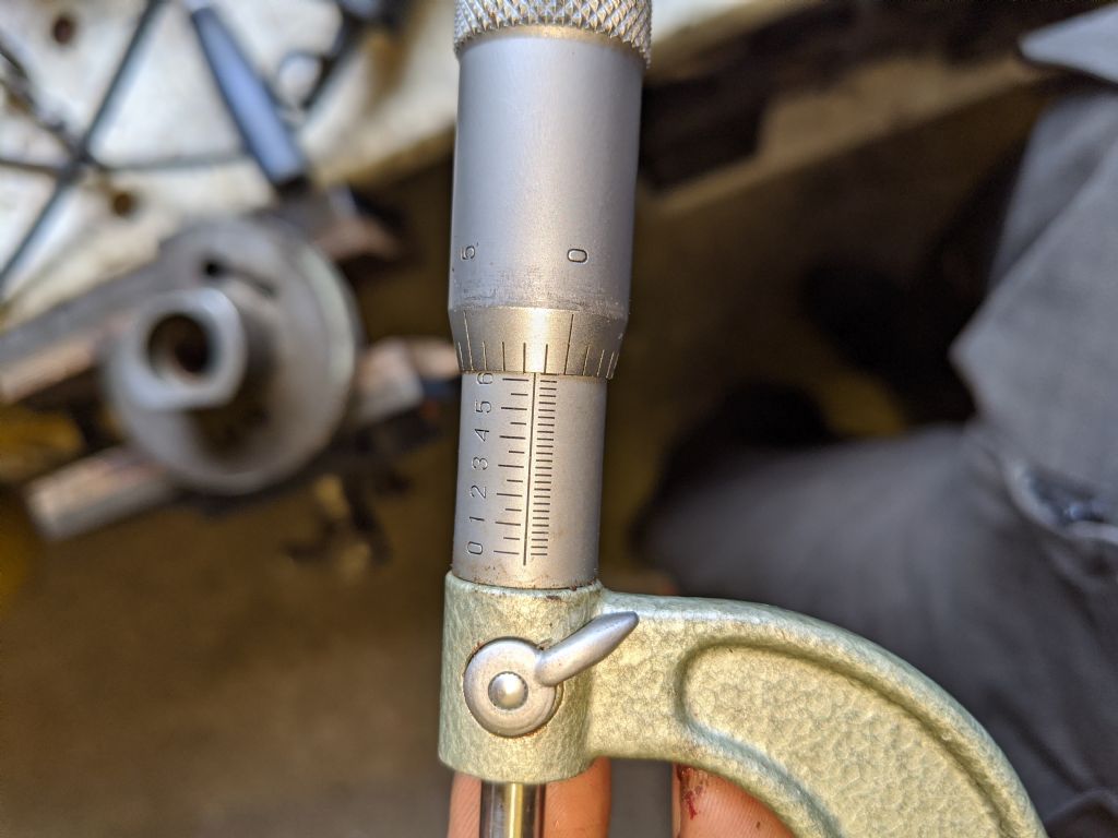

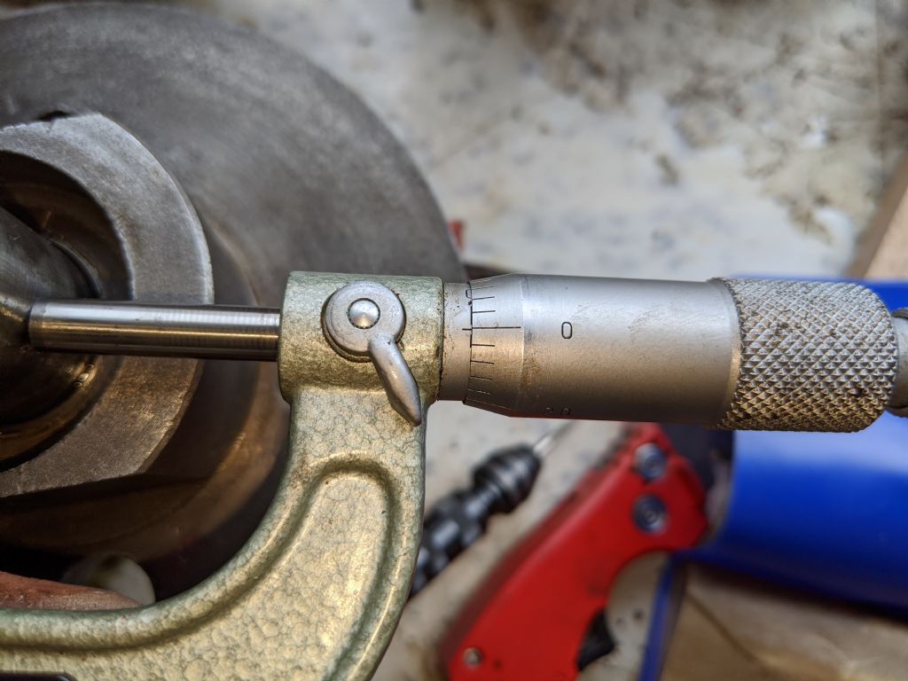

Then I measured
So we have
OD=1625 1 5/8ths
ID=1000 1 inch
T=a bit more than 350, probably 3/8ths
So, I'll find a standard size closest to that 1 5/8x1 5/8x3/8
Like This
Question is, do I want double lip or single lip? And whats the difference

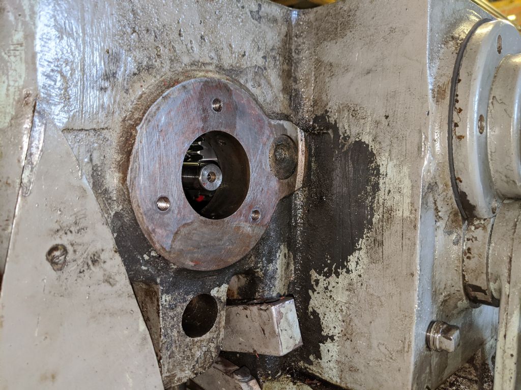

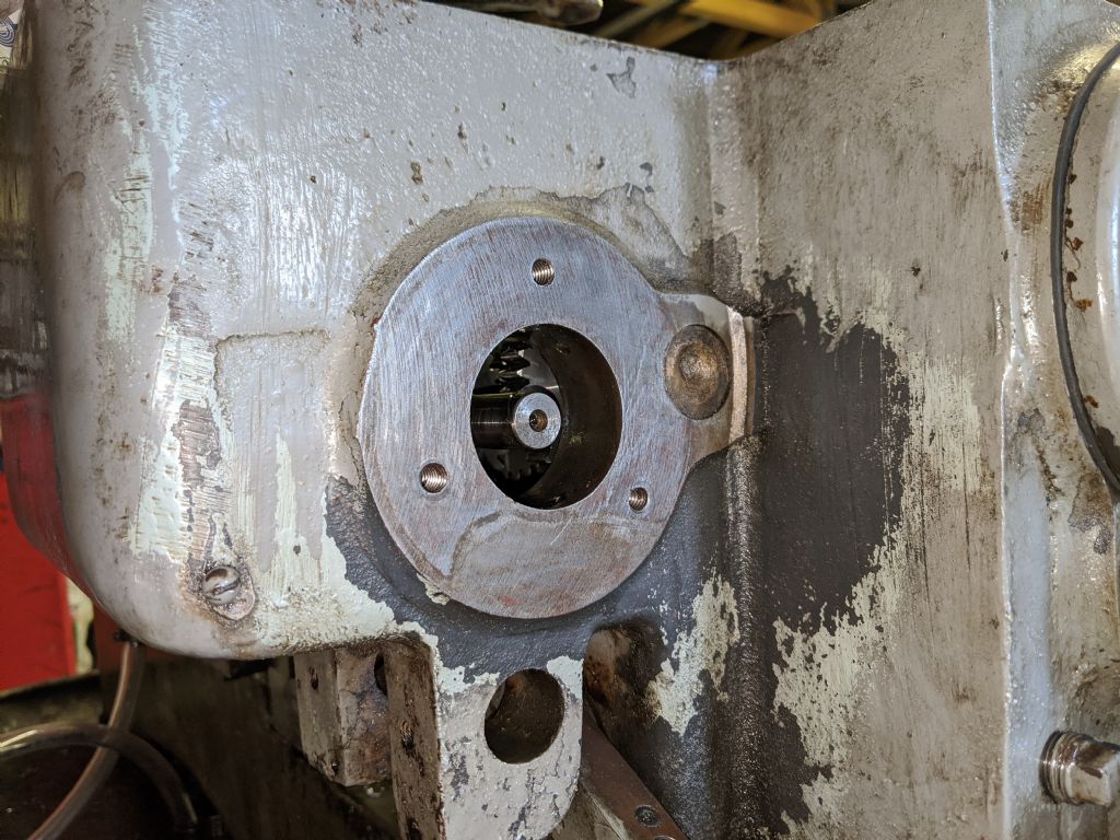

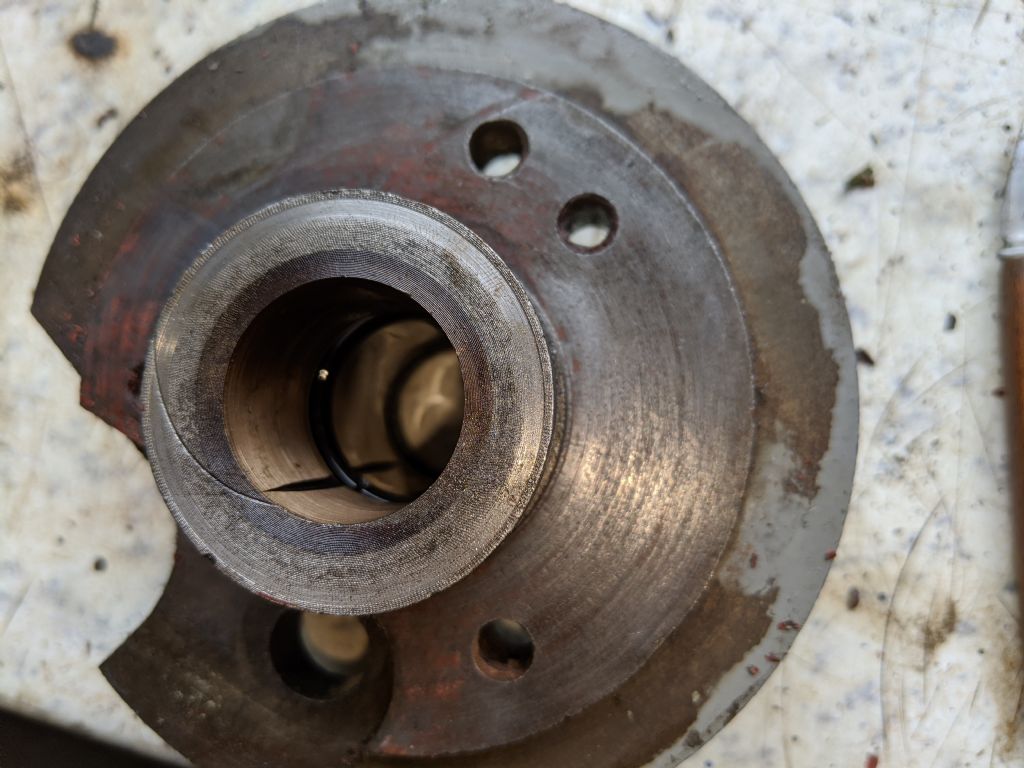

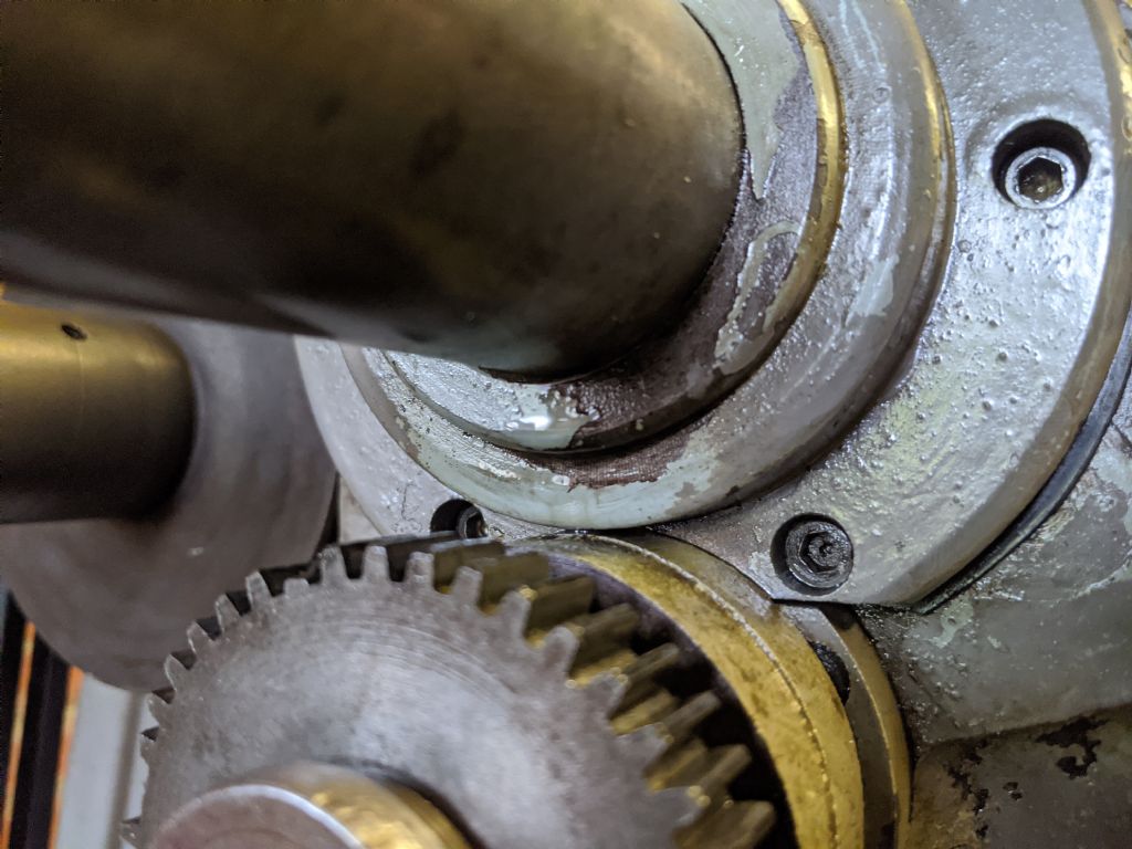

17/05/2020 13:39:46

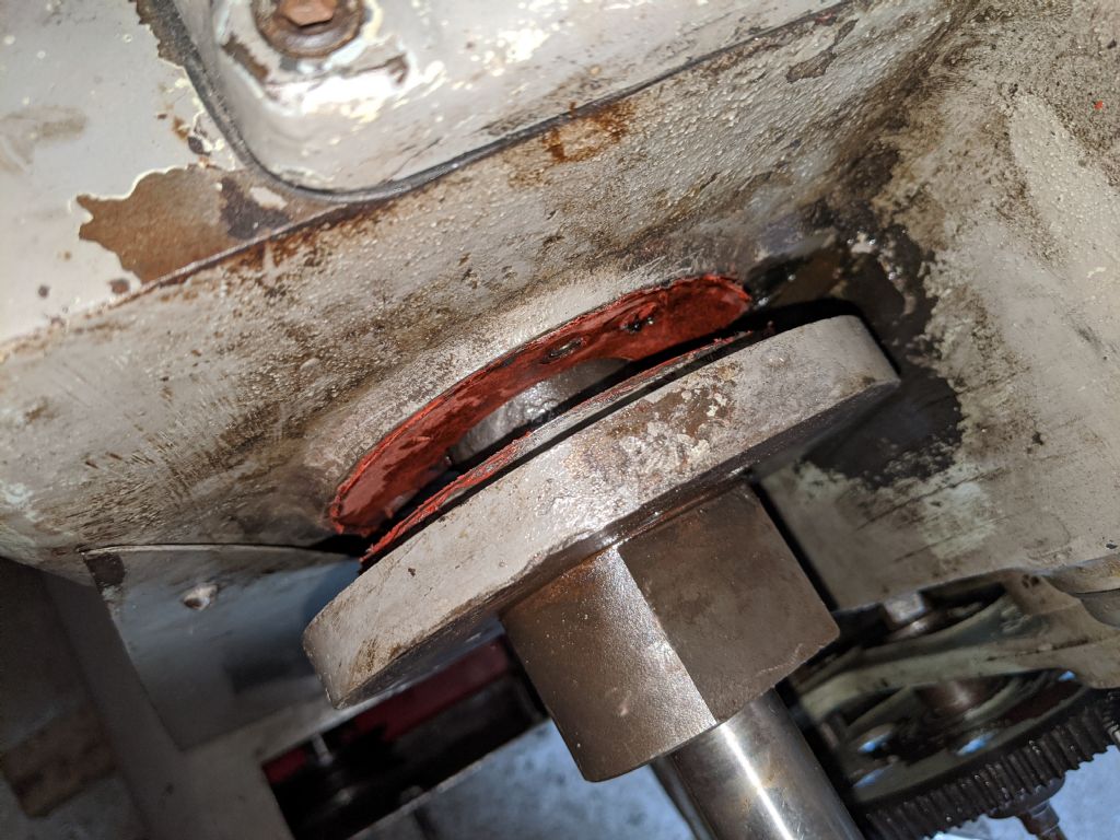

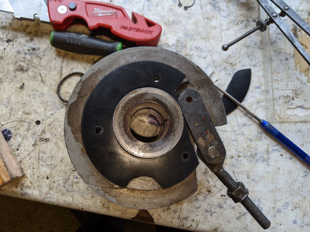

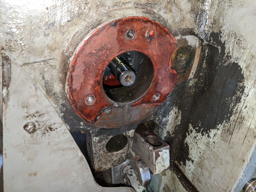

We have success!
Heated with a heat gun till it was almost too hot to comfortably hold, then just gave it a little pull and it went pop! Very easy. Unfortunately, as I pulled a little further, the inevitable happened, oil gushed out of the hole. So I quickly plugged it back in and drained the headstock. Not something I wanted to do for this, but necessary.
The smell is back, so that must be the smell of the gasket cement. Definitely recognizable for the future.
I even found the original gasket in there too. It was stuck on very well so I had to use a box cutter blade to slowly get it off, but now I have a template for the next one.
So, onto the main problem. The leaking seal. It has a set of numbers on it, but I can't seem to get it out easily.
The seal looks pretty shot. Looks like a leather one like the other one I replaced, but thicker.
I'll get the numbers from the seal

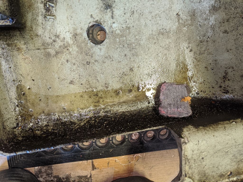

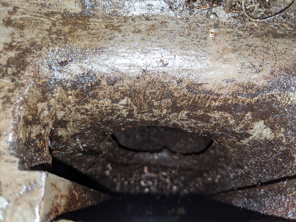

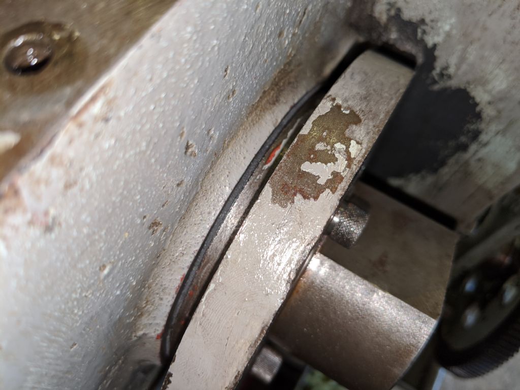

16/05/2020 20:52:27

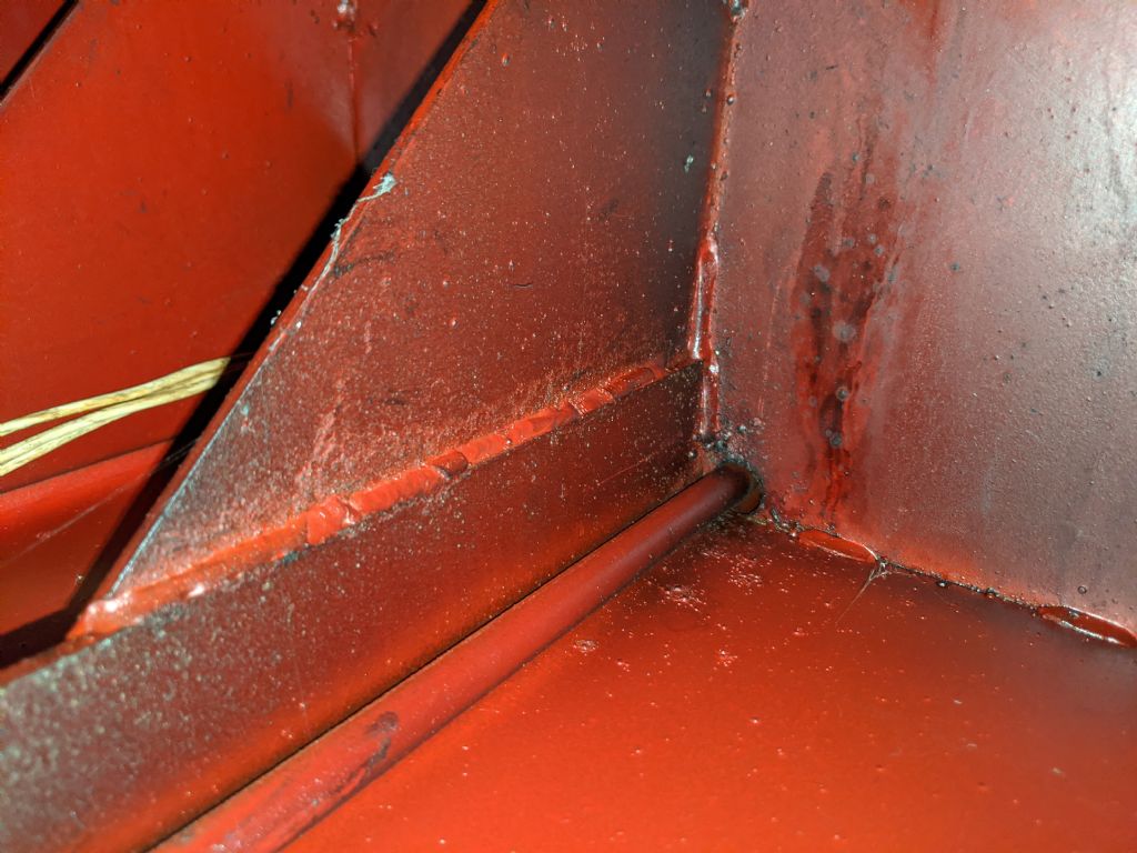

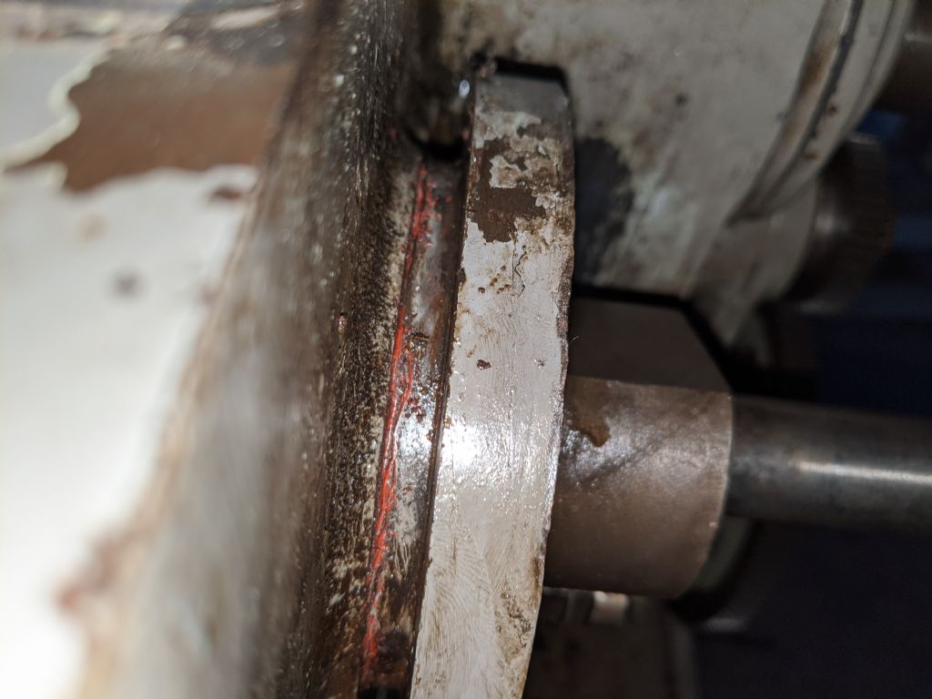

A few more pictures to Illustrate.
There seems to be some red stuff which I presume is the gasket material. I think the bolts had some red on them too
Red stuff doesn't scratch away easily. Someone could have added glue to stop it leaking at some point?

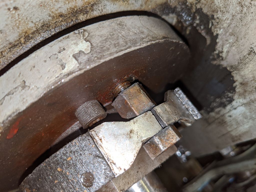

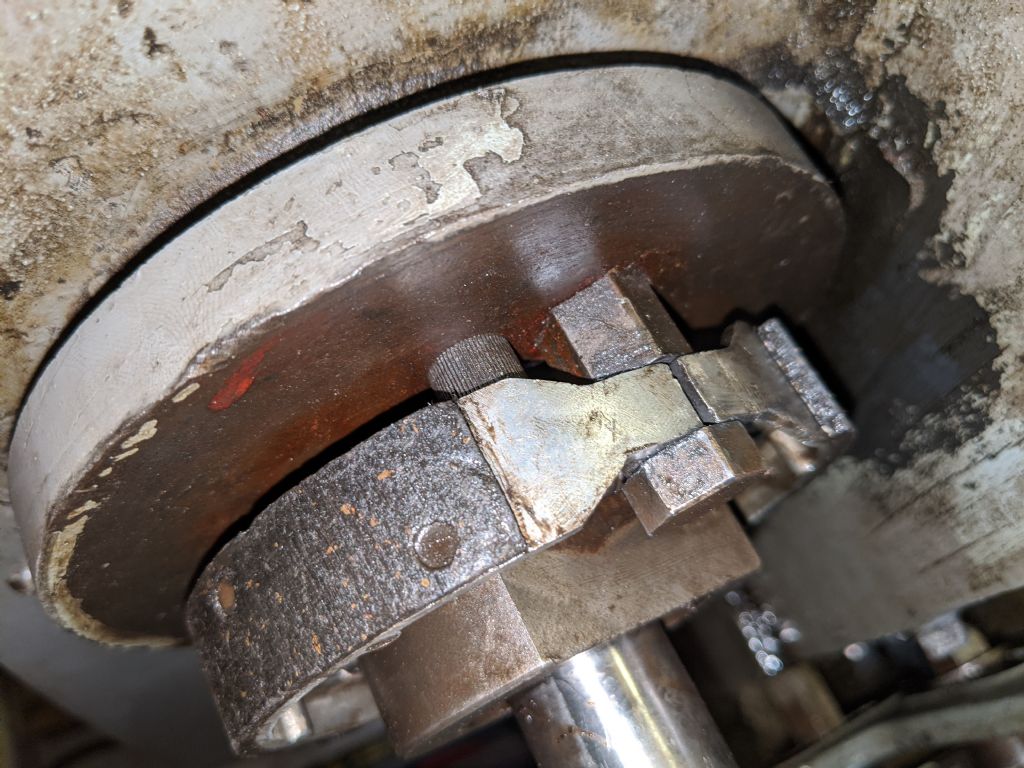

16/05/2020 20:38:01
Posted by Herman van der Merwe on 16/05/2020 19:49:14:
Posted by Herman van der Merwe on 16/05/2020 19:22:58:
Your shoes needs to be replaced.
Sorry, I meant the shoe lining of each shoe needs to be replaced.
Shame, I was going to treat myself to a nice pair of stilettoscheeky
Last time I cleaned in there when there was only a bit of oil, they worked really well, so I don't think they need replacing.

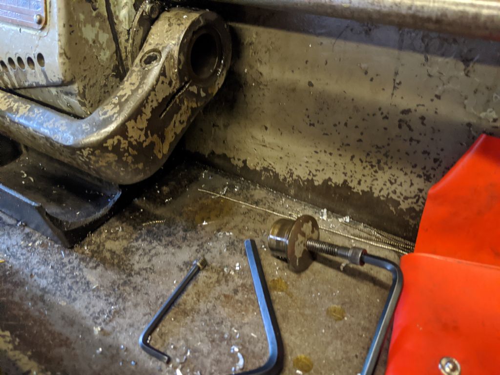

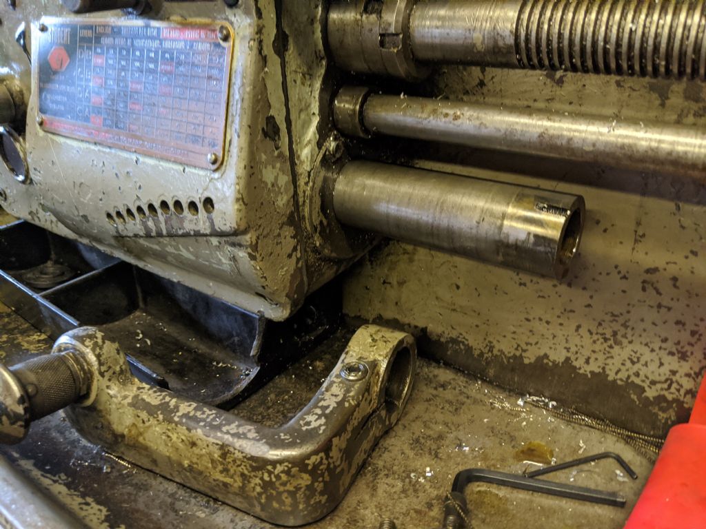

Speed change shaft is looking very nice Herman. I'm glad I didn't have that much trouble with mine!

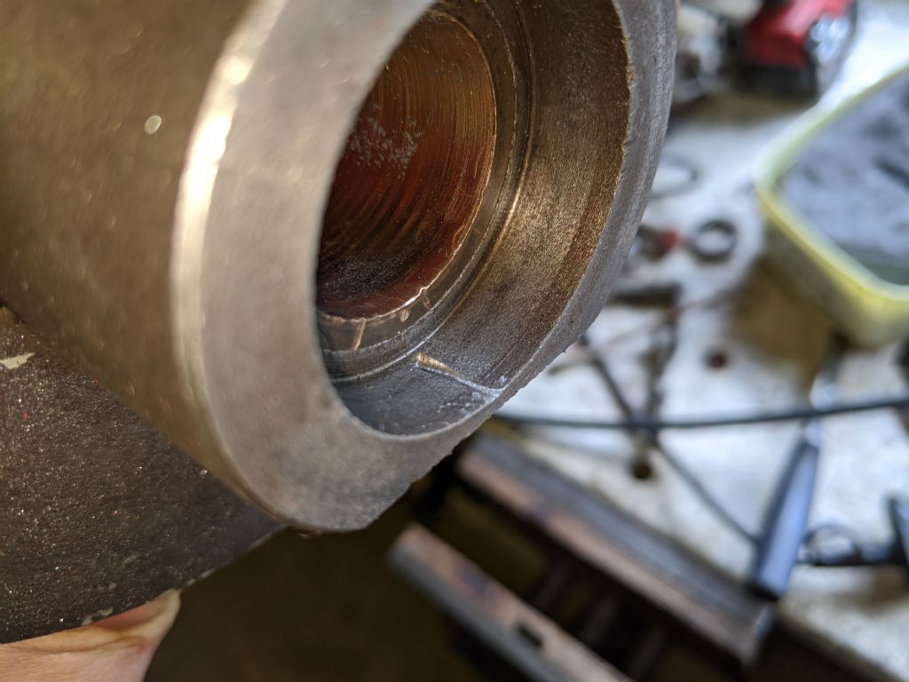

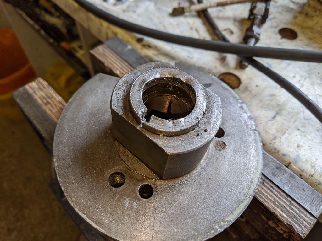

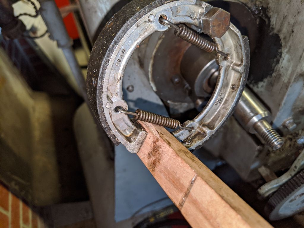

I had a nap to think on it then headed back out to try again. I managed to get it off, I pried it off at the bottom then undid the screw, while putting a block of wood on to keep it from snapping closed again, so it'll go back on more easily.
I'll see if I can get the spare brake shoes from Tracy. It's about time I messaged her again, it's been a month, but I was waiting on the bulb to arrive first so I could finish that chapter.
As for the flange/bearing thing, It doesn't seem to want to budge. So I put some penetrating oil on it and I've left it. The 3 screws that came out smelt quite funny, not like a normal grease but sort of sweet maybe? I don't know but it didn't smell normal.
I don't particularly want to order a new seal from the spares place as they'll probably charge a small fortune for something that I could possibly make myself? Or perhaps source from elsewhere cheaper?

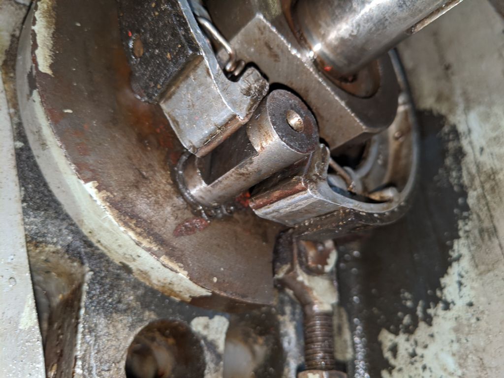

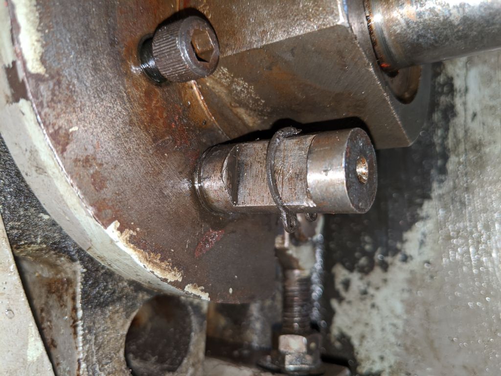

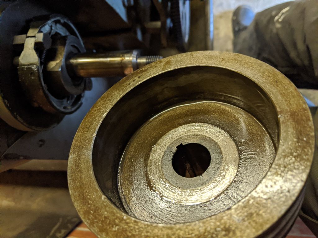

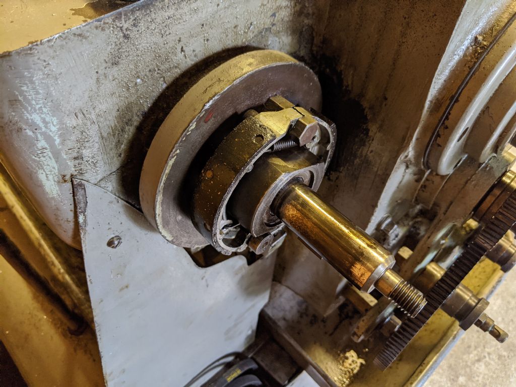

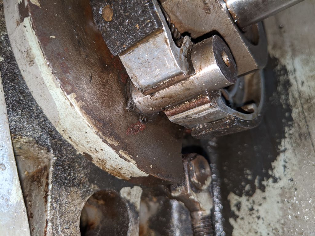

16/05/2020 17:03:01

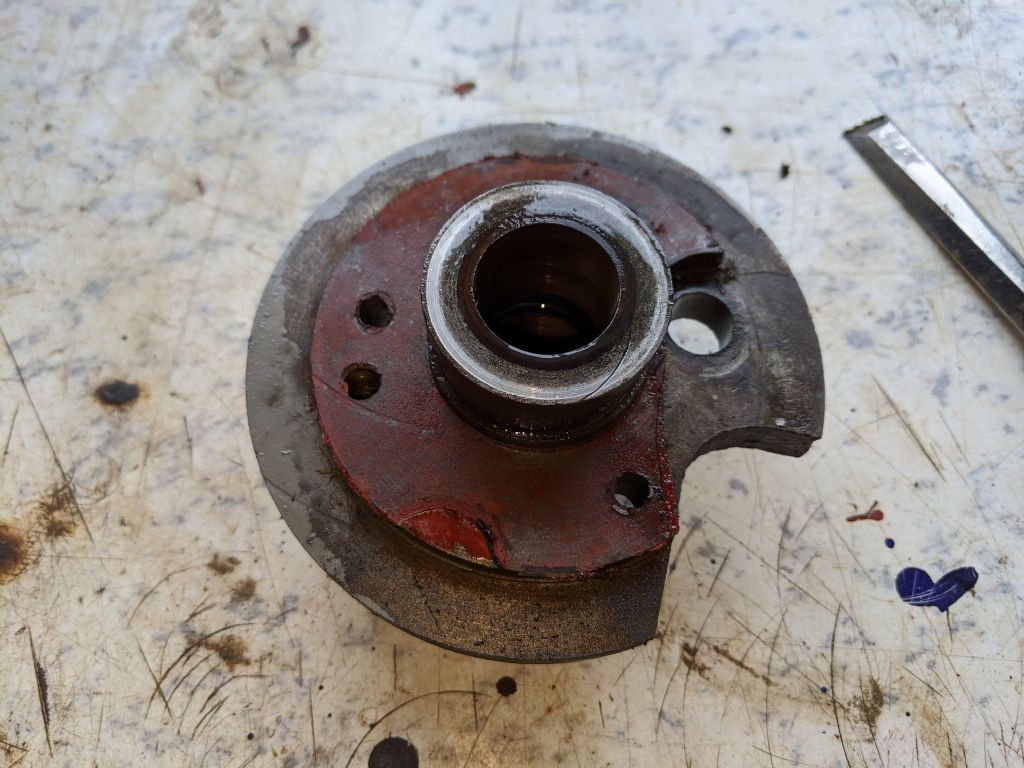

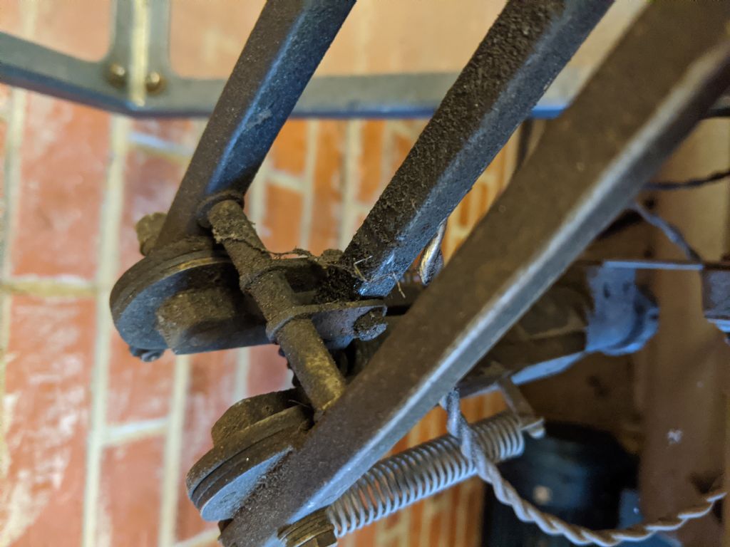

Phil, it is not the same as Hermans, I have material on mine.
The leak is trickling down the lathe and pooling over time in the tray. You can just see a slight bit in here since I cleaned it the other day.

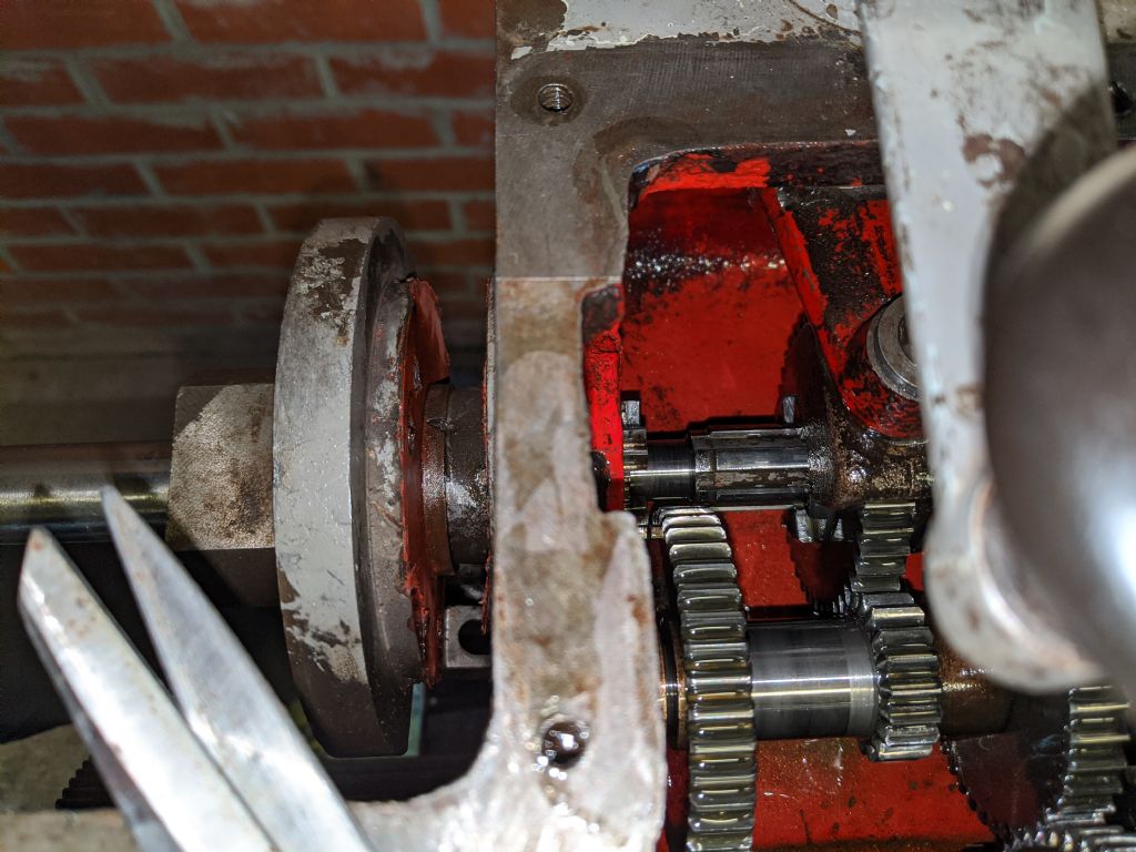

Leak is definitely coming from the inside of the brake
Covered in oil inside. Doesn't make for an effective brake, and makes my lathe messy!
This is where I get stuck. I need to remove the sprung bit, but I cannot seem to get it off. I tried taking out the bolt, but it doesn't feel quite right. There's a circlip on the shaft below that turns to push the brake out, but I don't see that helping disassembly yet. Any Ideas?

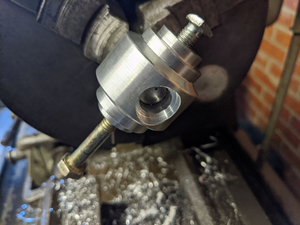

I've been working on making a tailstock die holder the past day or so. I've run out of material so I've ordered some steel from my local steel place. So I have a few days to stop this leaking
I also got myself a knurling tool, which arrived today, I tried it out and I'm very impressed, you get so much more grip on knurled parts. I think I'll have to knurl everything nowlaugh

Solution played out perfectly, except from the oil that leaked out of the end. It was much easier to dismantle than to reassemble, but still not too difficult. It would have been much easier if I had drained the change gear box first!

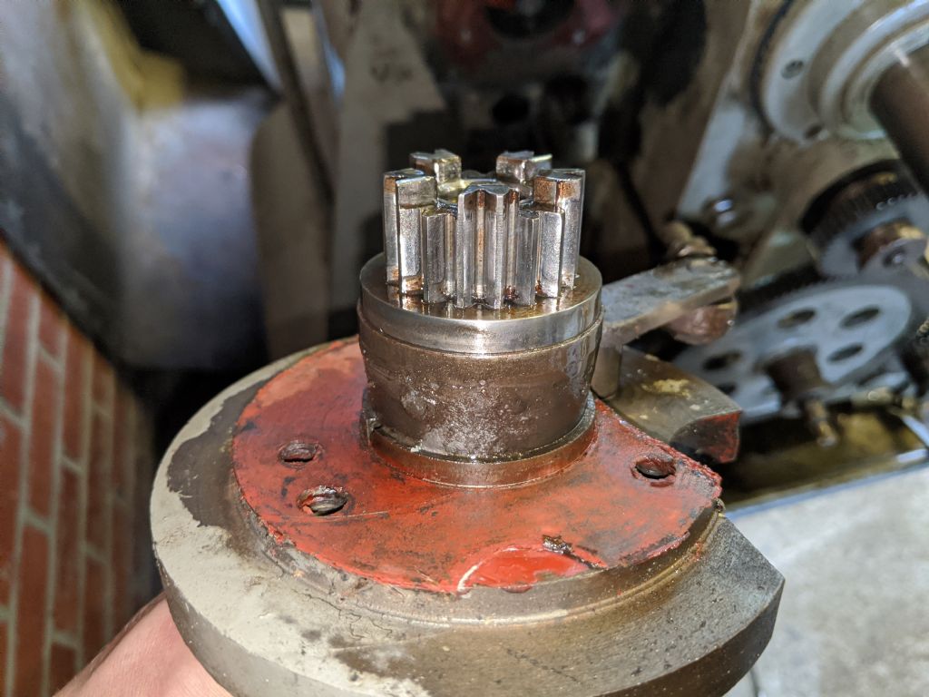

Yes I have seen. Very interesting stuff, I wasn't expecting your spindle to be anything like that. Enjoying your thread a lot!

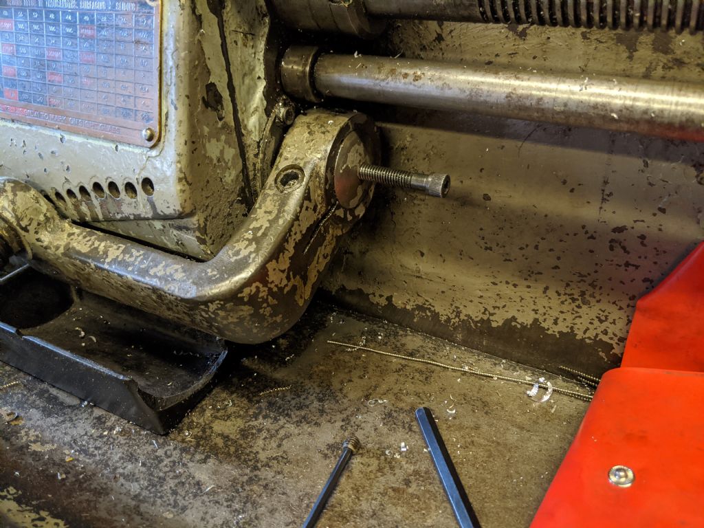

The gear was quite hard to get off. There's a locknut on the end of the shaft which must be removed, then there's a washer then the gear comes off. However, my gear was quite stuck. Eventually, after a lot of pulling and pushing and cutting my knuckles on the gears behind it, I managed to work it off. I didn't take out the other gear shaft, but If you have then it should be much easier access as I struggled and ended up pulling and pushing on the actual handle which risked damaging it. Luckily nothing broke for me, but it's worth mentioning.
Then, if memory serves, there is a leather washer behind the gear which acts as a gasket. My lathe was leaking from that shaft so I made a new leather washer which I made very tight to make sure it didn't leak anymore (1 month later, it's still not leaking) Then just reassemble in the opposite order.
Good luck
I'm not sure that yours will be the same as mine. I'll have a look at the pictures of yours

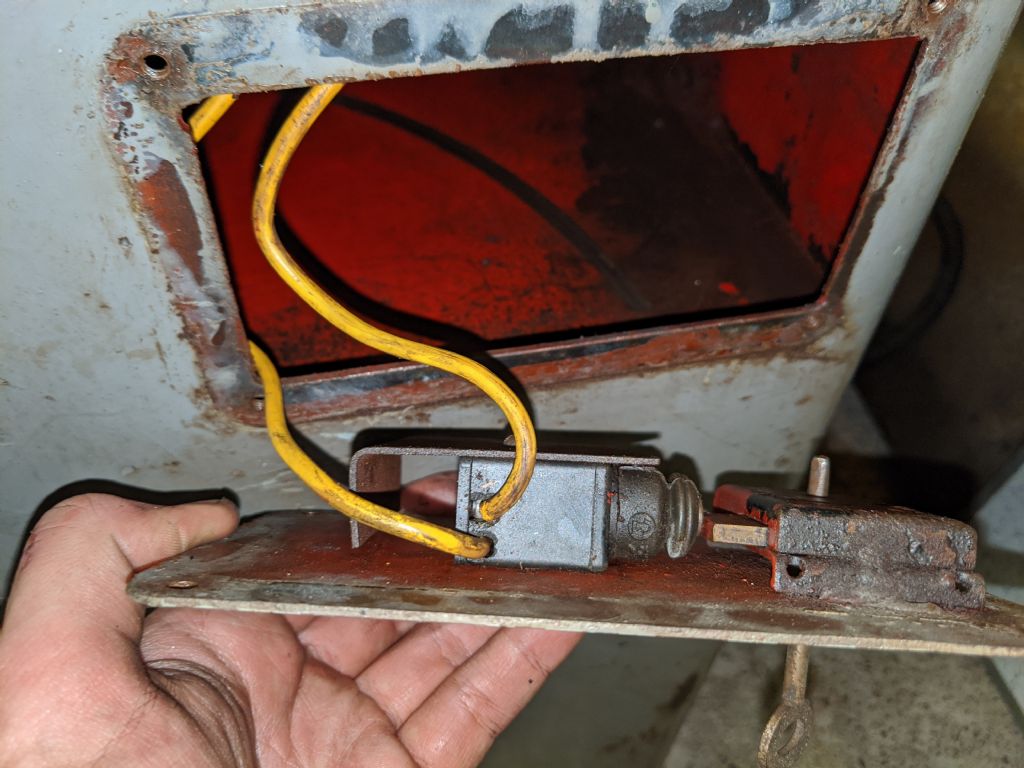

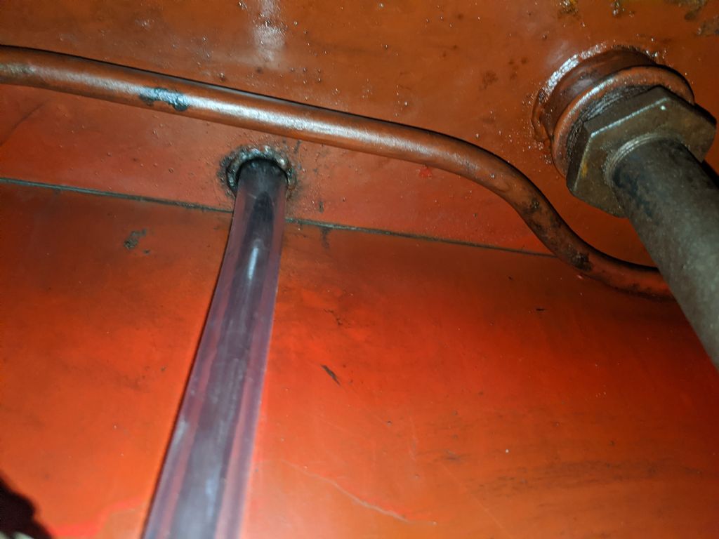

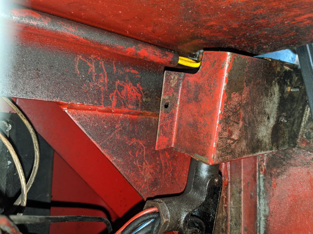

08/05/2020 15:41:45

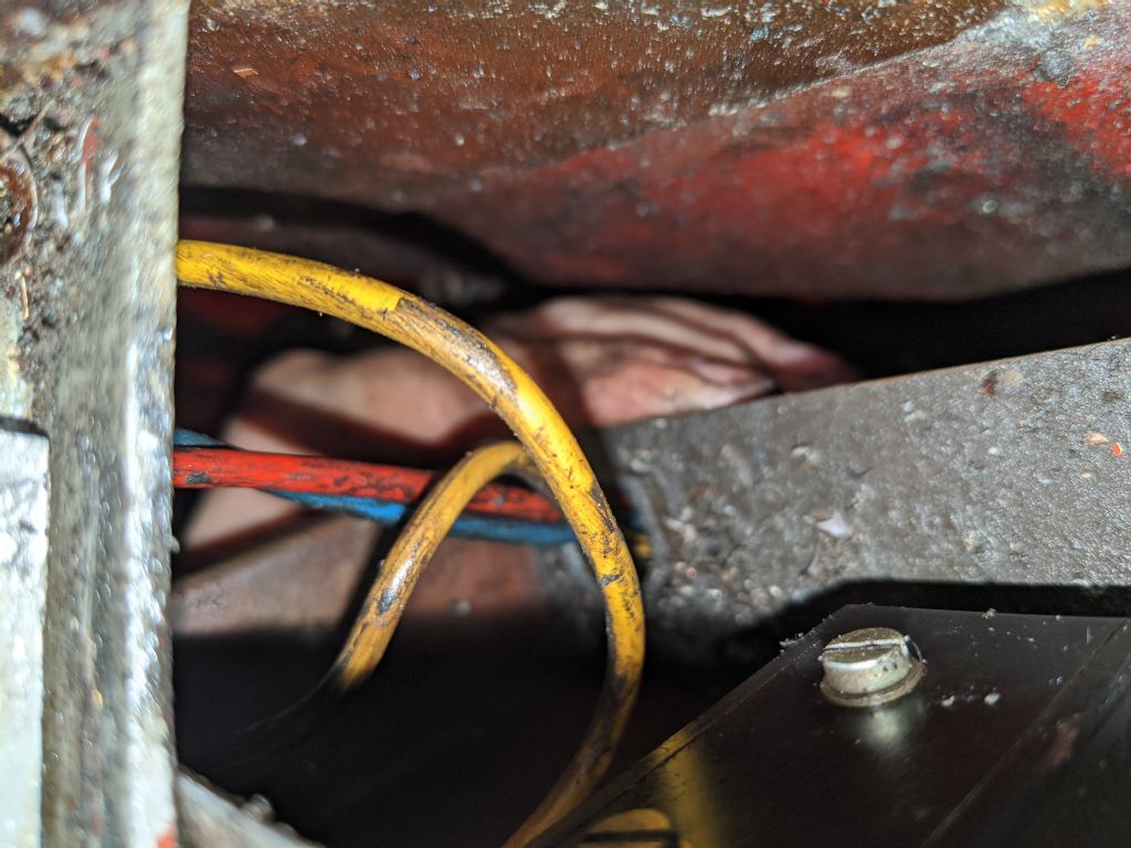

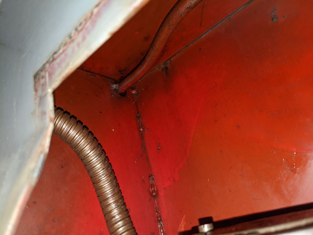

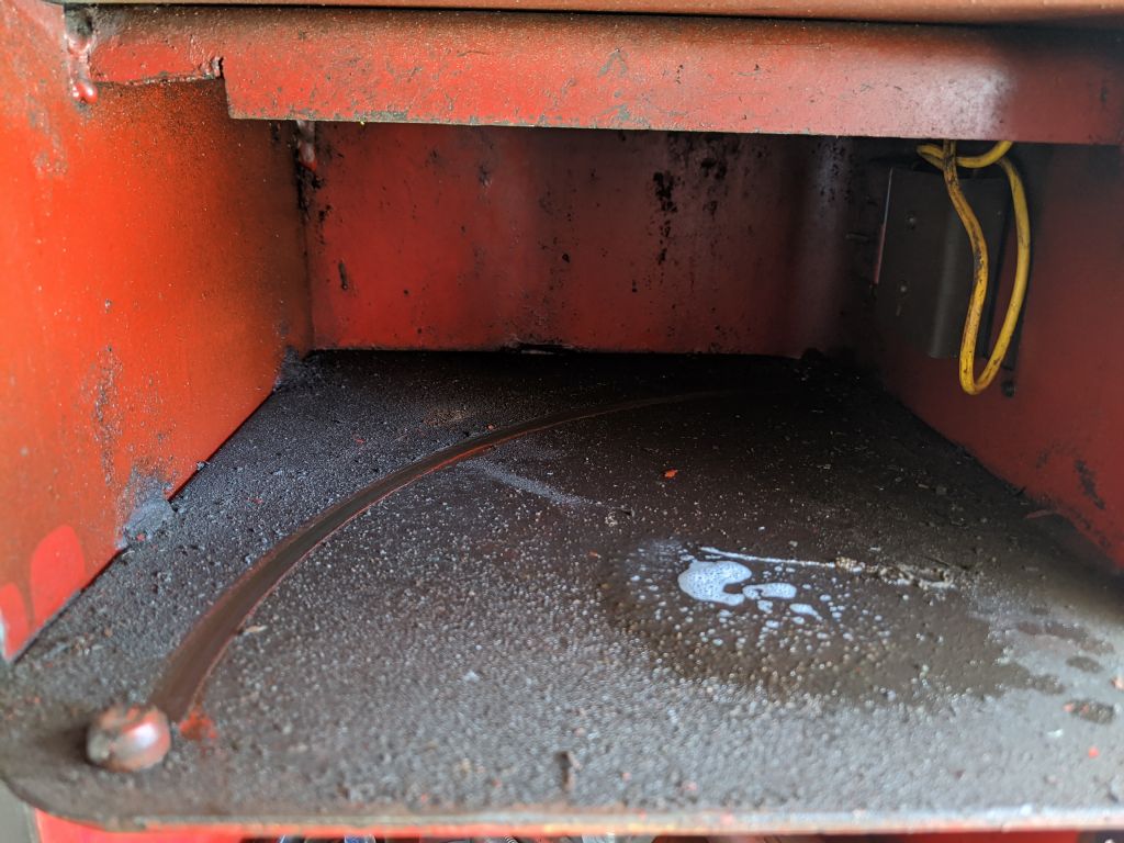

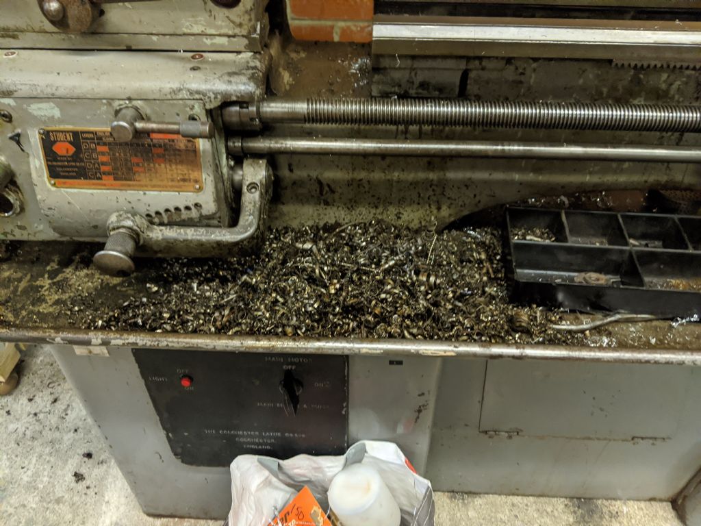

Couldn't really get enough access for a video
My wiring is exactly as Phil directed, so that diagram explains it all

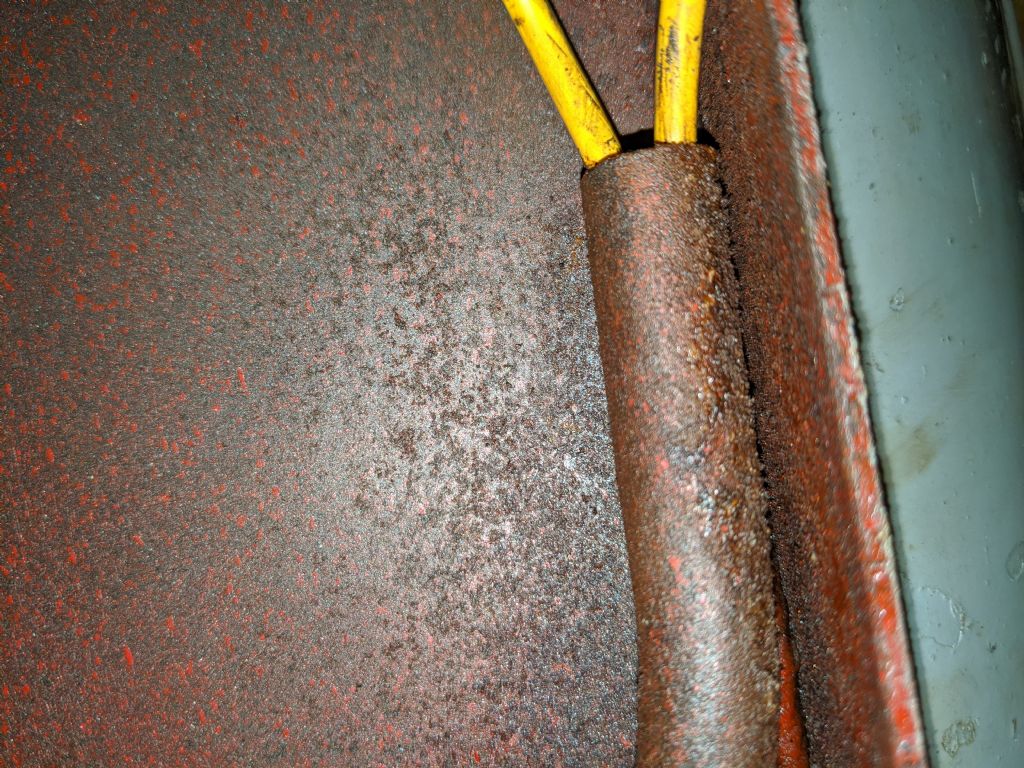

The red blue and yellow come from the contactor and overloads in their specified place, then all 3 wires head out the back and up to where the cover switch is. At this point, the yellow goes into and comes out of the cover safety switch
The yellow then goes out of the switch and down the tube going through the lathe body
Then it heads through into the coolant tank
Orientation might be messed up, but i'm sure you can figure it out
In the coolant tank

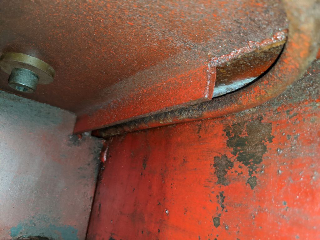

Then out into where the drawer is
So the wire coming from the cover switch comes into the key switch, then heads straight back up along the tube, then up and into the limit switch.
I hope that helps a bit, happy to answer any questions or get pictures for anything. Just ask. I'm very interested to see how you will wire yours up.
Also, while i was taking pictures of wiring I did a bit of cleaning, brightened up quite well

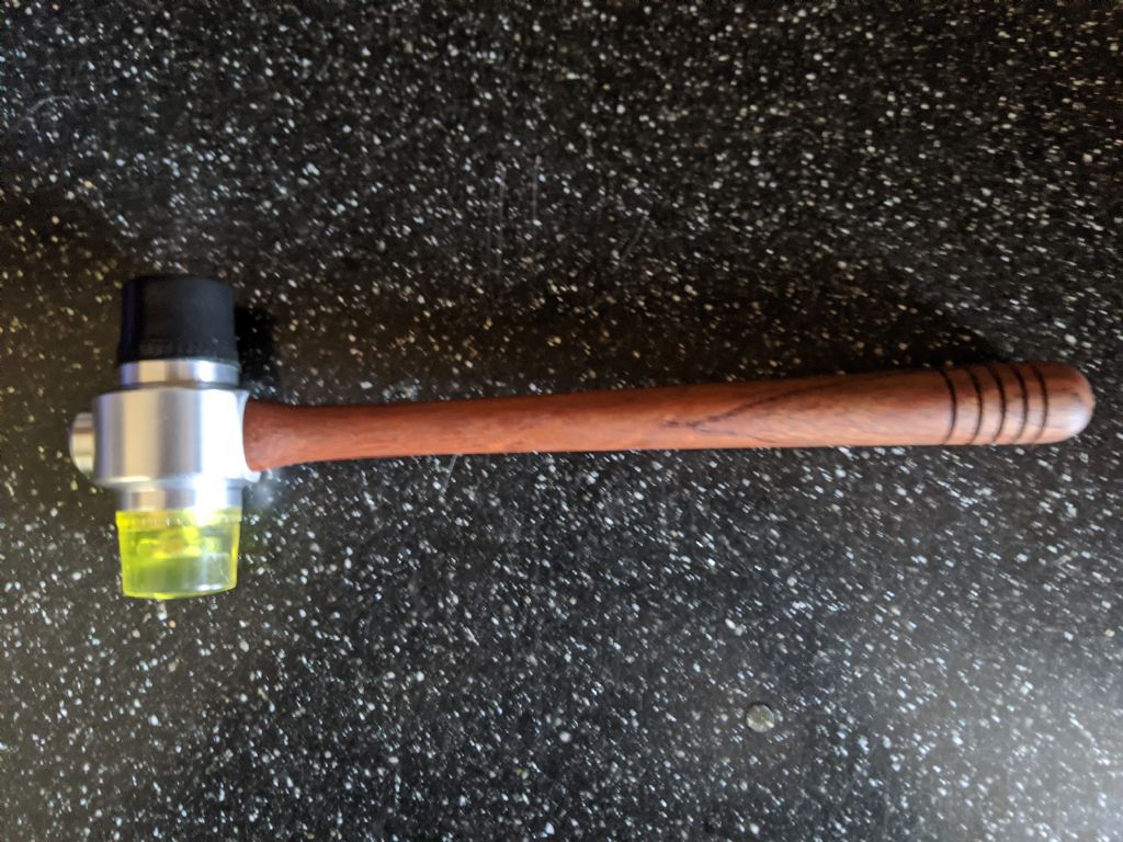

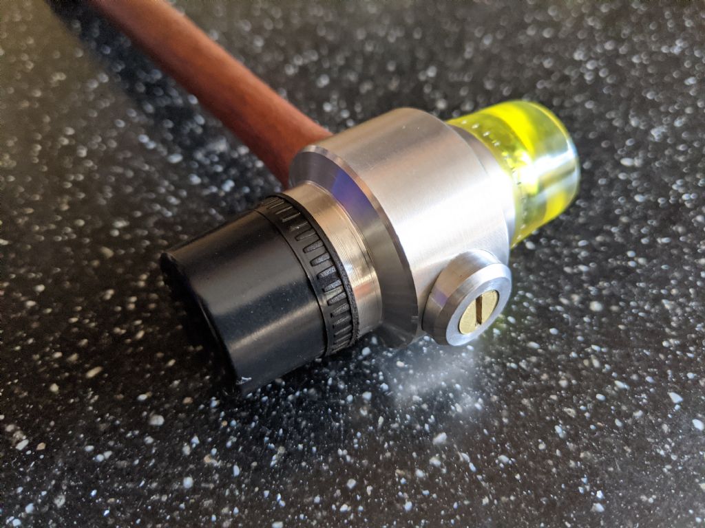

I had two hammer ends lying around, so I thought I would put them to use and make myself a small mallet from some scrap aluminium I had. I think It turned out quite nicely, even with a wood turned Bubinga handle. Not a typical mallet but interesting for me to try some setups.

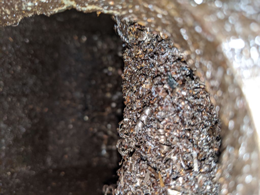

When I was tidying up the machine after, I decided to stick my hand in one of the holes under the headstock. Turned out it was absolutely full of old swarf and grime. It's made me really want to take the headstock off and clean in there, but it seems a bit excessive. Anyway, it's interesting to see all the old chips, completely steel, no aluminium, and some of the swarf must have been at least 10mm depth of cut on the radius. So more clues that the machine has been used plenty. Surprisingly I didn't find any bolts in the hole, but I did pull out loads of shavings, I can't quite reach the bottom, but the machine is probably 1kg lighterlaugh

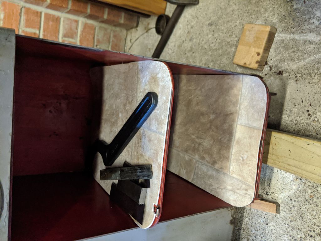

Didn't get much done yesterday, but still progress
I took the door and cupboard off to clean inside, then I cut some bits of lino to go in the drawer and shelves to make them a bit nicer to use. It works very well. I had some left over from putting it in my tool chest.
Then I played around smacking the door and drawer with mallet to try and get them to close properly (there was more finess than that, but it was just playing)
