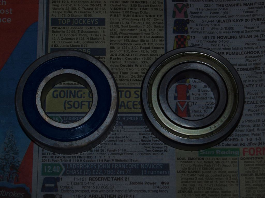

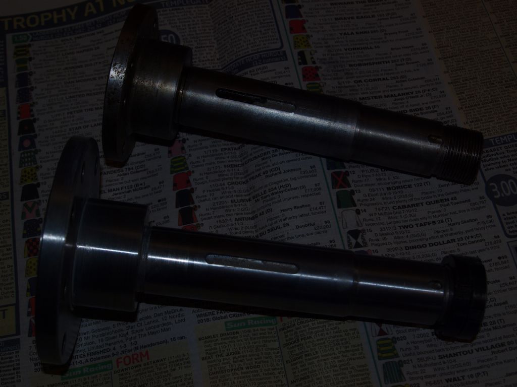

Right, as promised, here is the run-down on changing the spindle to a later type with the mounting for a 100mm chuck.
It is pretty simple; I removed the chuck, took off the cover at the gear end and unscrewed two allen screws that hold on a cast aluminium plate, giving access to the two ring nuts on the end of the shaft. By holding the chuck flange these can be uscrewed using a 'c' spanner and the drive gear and plastic spacer removed. A simple puller has to be devised, using a flat piece of bar with a centre hold drilled; with this held off the end of the chuck flange by two lengths of tubing against the headstock, a long bolt can be passed through the spindle and the nut on the end tightened, drawing out the spindle and end bearing. The remaining bearing is tapped out of its housing.
The top picture shows the new angular thrust bearing on the left, old ball race on right. The lower picture shows old spindle at the top, new at the bottom.
Fitting was simple - press new bearing onto shaft and then feed shaft through the plastic drive gears - although this presents the problem of how to get the bearing into its housing - I managed to tap it in by inserting a small rod through the chuck mounting holes and working around the bearing until it was snug. The bearings are a really tight fit upon the shaft, but because the angular thrust bearings need to be adjusted to remove any end-float, ideally the bearing at the other end should be a tight sliding fit upon the shaft, but after much use of emery cloth, I still was not able to get it as loose as I would have liked. I had to resort to tapping the bearing into the housing, while gently tapping the inner race onto the shaft. finally I tightened the end nuts to remove any end-float and all was well. one small problem is that the tiny parallel key in the end of the shaft is shorter on the new one, so I had to make one to fit. If anyone is ordering the new shaft, be sure to include a new small key.
