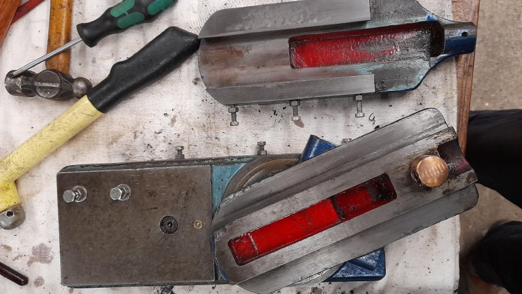

07/01/2021 20:38:54
I have a long-overdue job that needs to be done to restore this lathe. The feedshaft worm is badly worn and spares appear unavailable. I've been on the Denford Data website where there appears to be a number of knowledgeable and helpful guys and I'm hopeful that I can get the original drawings for the worm. With or without the drawings I would like to get a new worm sourced or made and I'm wondering if anyone can make a suitable recommendation. I'd expect to pay a fair rate but we have to be realistic as this is not a top-end lathe.
20210107-162006 20210107-162353 20210107-183545 20210107-202040 20210107-202056 20210107-202105 20210107-202126
Incidentally, by visual inspection it is my presumption the worn worm is the cause of partial engagement (and unwanted disengagement). The worm wheel looks to be in much better condition but it remains in the gearbox and taking a photo is tricky at present. However, I would have expected the worm wheel to wear at a faster rate than the worm but maybe I've got that wrong.
I'm based in Dorset.
Thanks for reading,
Brian

In my quest to semi-restore (not too interested in paint jobs) and improve the function of my Denford Viceroy lathe I am part-way through dismantling the cross slide, apron and compound slide.
Despite close inspection, I cannot see what stops me separating the swiveling compound slide from the cross slide. The three grub screws that are used to lock rotation are now fully removed. It swivels freely. The compound slide lifts away from the cross slide by a few mm but is clearly being retained by something. But what?
Apart from that, the dismantling is going well. I had to knock out a couple more pins (see my previous thread) but these were much easier and there were no substitute roll pins this time.
