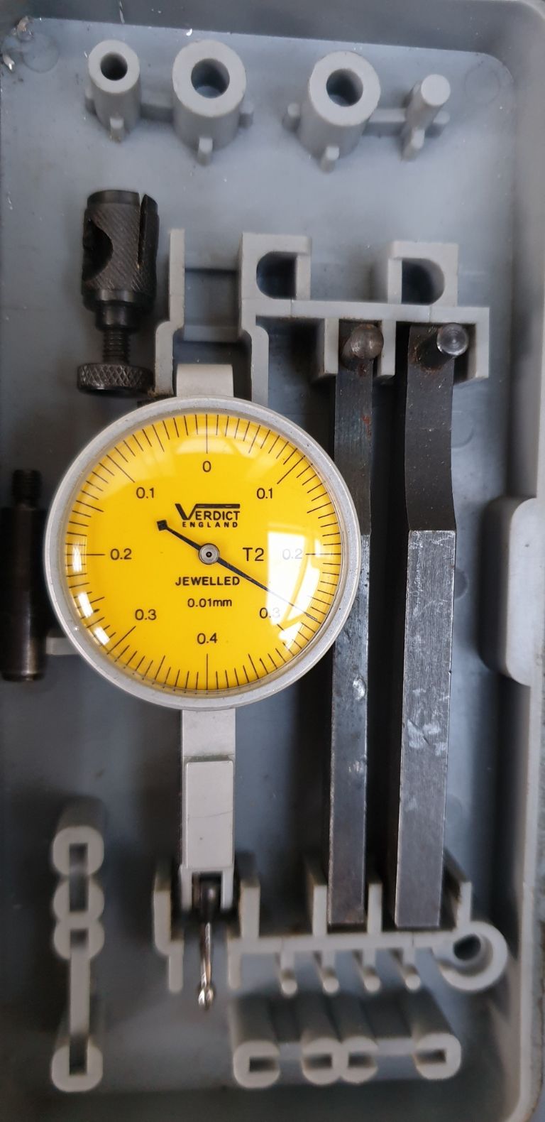

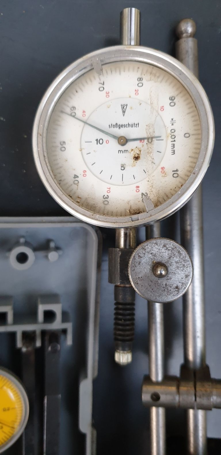

11/10/2020 10:22:26
Good morning David & Howard,
So attached are my two second hand indicators, the larger one is a bit sticky but if the plunger is part depressed then actually it seems ok. The Verdict one has a different tip?
Howard, thank you something like this was in the back of my mind. Its the small bore size creating the issue in my head at least, you would think there is a market for between centres test bars especially for those with smaller lathes but I cannot locate one online?? I was wondering if to make one if I got a larger dia ground bar say 1" or so, one end in the 3 or 4 jaw chuck and then centred the far end say 12" long accurately within a fixed steady, drill the centre and then reverse the bar and centre drill the other end. Does this seem a reasonable way to do it?
Chris.
