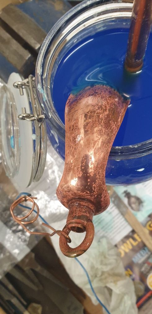

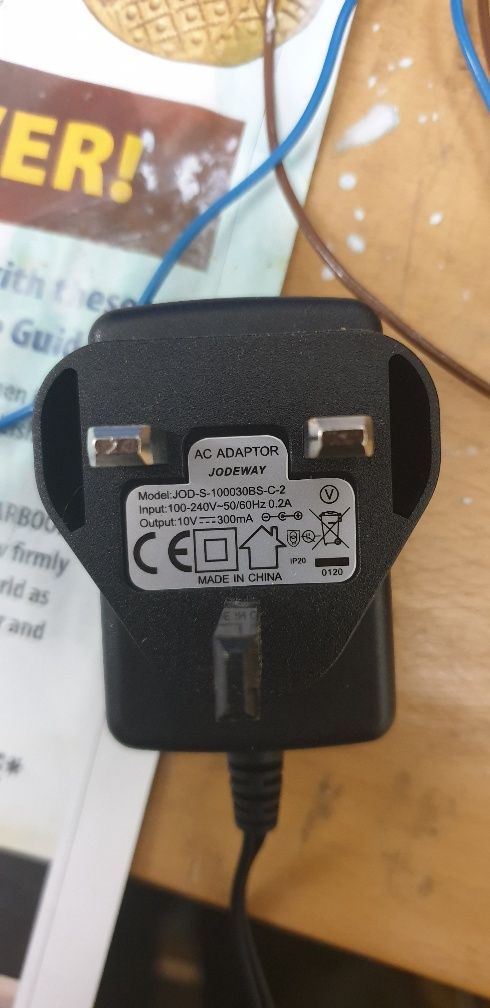

Yes I can confirm 240 volts hurts as i found out a couple of weeks ago. Hence my nervousness and asking the question! I will be happier and no doubt safer if I can get away with domestic batteries.

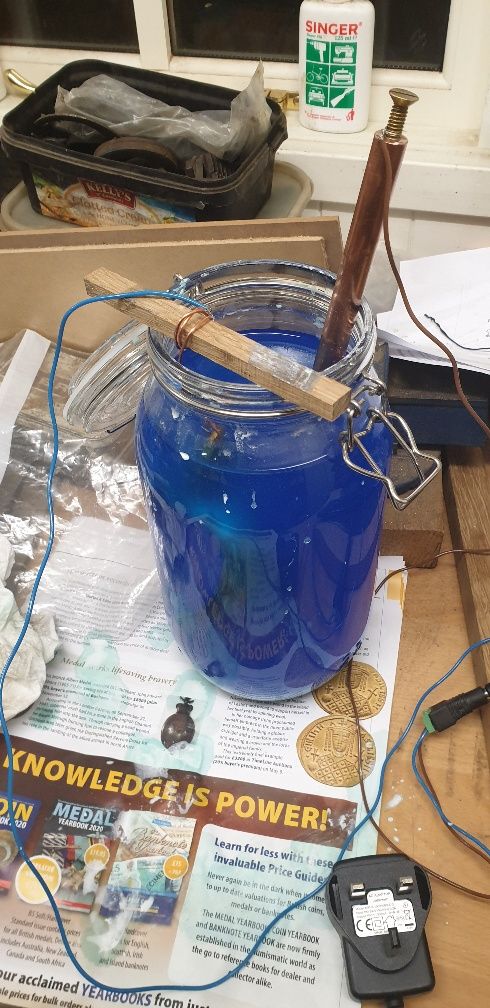

25/02/2020 17:07:58
Hi John,
Previously I had fumed (with ammonia) the copper I'm trying to plate to age it (they are parts for an antique light). Thinking this might hinder the plating process I stripped the fumed surface by submerging in clock cleaner,
a kind of diluted ammonia. After that I didn't touch with bare hands only with rubber gloves.
Do you think that might be the issue?
Last night I tried removing the crystals from one part finding it was relatively tough going, having to resort to Autosol.
Ive turned the power off now but left one submerged for overnight success (-;
Cheers
Chris.

25/02/2020 15:57:47
Ok I'm getting nowhere fast with the copper plating. I have a 2lt water filled pasta jar with 12oz of crystals dissolved and a 2 amp power source. The electrode is 12" long, thick wall copper tube, 1/2" dia with 3/16" centre hole.
+ connected onto the electrode, - onto the part to be plated.
Part is suspended in the solution via copper wire and not touching electrode. There is tiny progress in that the copper part I'm trying to overplate (to cover a soldered repair) has areas covered in what looks like copper filings but from the clips Ive seen on the web it should be plated by now? Its been in about 5 hours today, after an attempt yesterday with a weaker solution.
Any suggestions please?
