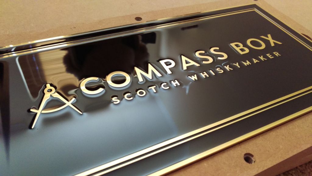

26/03/2022 09:43:40
Hello all.
I have a project on at the moment which involves having brass plates coated with resin - here's an example of one I made some time ago, the current project is the same kind of idea.
Compass Box
Before the resin stage I need to polish up the raised details which means that polishing compound packs in to the letterforms and creates a whole world of ball-ache to clean up. I've managed to refine the clean-up technique to something resembling 'tolerable' but I'm stuck for what to use for a final wipe down. In the past I've used fairy liquid, a toothbrush, numerous cocktail sticks, and then hot water to rinse - seems to work okay, but I'd like to know that I'm doing the job 'properly'.
Recently I read a self proclaimed de-facto explanation of how to prep brass for paint where the instruction was to use rubbing alcohol as a final wipe down. Okay, so surgical spirit (or isopropyl alcohol) then. But in many cases off the shelf stuff contains caster oil and will surely leave a residue and I'm not prepared to take that chance...
Am I over-complicating this? Once visually clean do I just paint in meths to all the nooks and crannies and then hot water rinse?
Many thanks.
Wal.

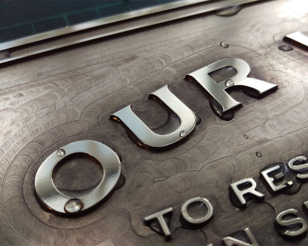

11/02/2022 11:22:12
Hello all,
Some good information here. Thanks for posting those images Noel - very helpful.
I did some tests a while back for a company who were after a bit of custom signage. That was CNC'd but I added a bit of patina to get a cast look (electrolysis and then acid) - it was in aluminium (pic below) - I get the impression that my customer's after crisp lettering for this job - perhaps I go with CNC-ing the brass and adding patina to the floor where the texture sits?

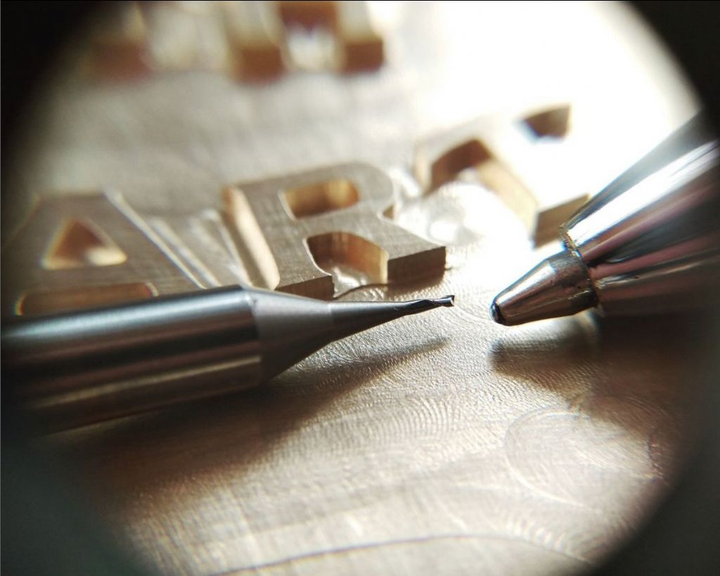

09/02/2022 16:24:14
Hi Jason,
I looked at PB102 - with a machinability rating of 20% (poor) and requiring copious flood (of which I have but a meagre trickle) I get the feeling that I'd be fighting a losing battle using the tiny end-mills.
Wal.
