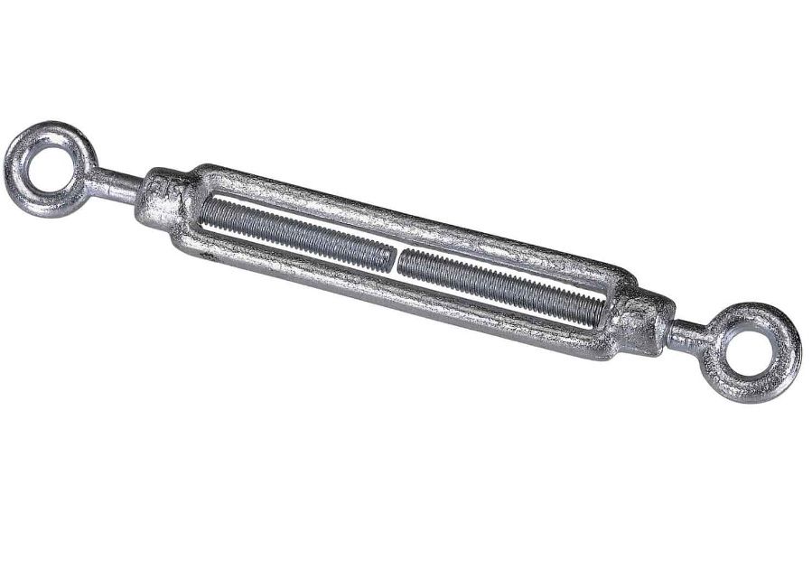

I've used a cable tensioner to good effect, I modified it to push against the back of the lathe and on to the motor countershaft and it can be tightened or loosened in a second to move the belt overtensioner.jpg
