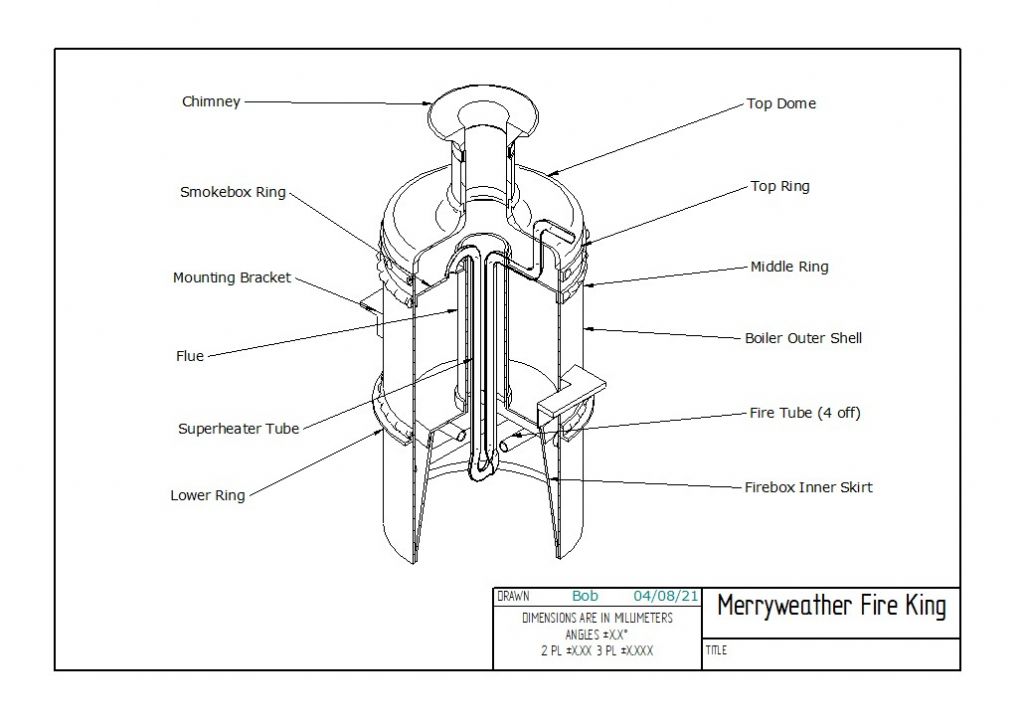

Here's a drawing of the modified boiler, taking account the various suggestions I've received. The changes are :
  1. I have done away with the outer conical section and extended the boiler outer shell to the bottom of the boiler.
  2. The twelve curved fire tubes have been replaced by 2 pairs of straight tubes fitted directly across the firebox, each pair being at 90 deg to the other.
  3. The firebox inner skirt now meets the outer shell so it may be soldered directly to it.
  4. All the rivets have been replaced by dome headed screws fastened to three new rings. These are labelled Top, Middle and Lower Ring. These new rings can be soldered directly to the outer shell, so there will be no holes into the boiler.
  5. Question: What about doing away with the top ring and screwing the Boiler Outer Shell and Top Dome directly? There is no water or steam in this region only the exhaust gases.
Any thoughts about these changes? One immediate benefit that I can see is that I only need one casting. Although the foundry I found quoted quite a reasonable price and fairly quick delivery. Apparently he gets quite a few similar requests from model locomotive builders. I am thinking that I may need to use different melting point solders and build it in stages. Any advice would be most appreciated.
By the way the boiler is 4in dia and overall height is 10 in.
