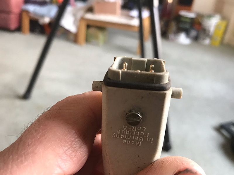

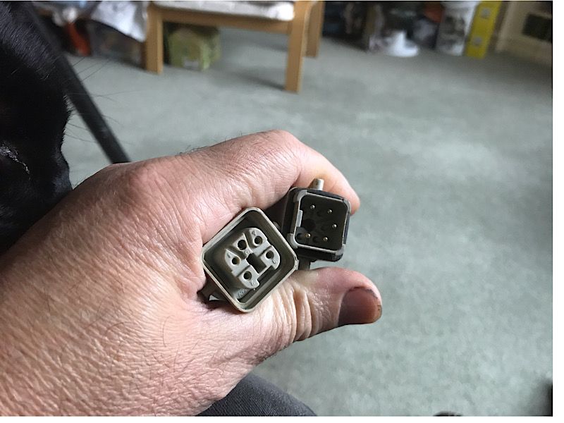

12/02/2020 17:57:53
Posted by Ian Parkin on 12/02/2020 13:19:42:
This one and all the others on the machine that these came off are all the same
As I said, not all HAN connetors are suitable, only the ones listed as having a protective earth connection. The first picture did look like it had a longer pin (actually placed firther forward, the actual pin is the same.
As has been noted they come with crimp or screw contacts. If using a screen you ideally need a metal shell version and cable clamp designed for screened cable. You could terminate the screen to a wire and use 4+PE connector.
12/02/2020 12:54:25
Posted by Ian Parkin on 12/02/2020 12:43:20:
Well those are harting brand and as you can see the earth doesn’t disconnect later than any other of the pins
Yes that one pictured does.
The 5th pin at the top is longer than the others.
Not ALL HAN connectors do, They have to be nPin + PE or similar description to be safe for external mains power connectors.
Robert G8RPI
Edited By Robert Atkinson 2 on 12/02/2020 12:55:56
12/02/2020 12:51:11
Posted by David Jupp on 12/02/2020 12:24:55:
There is a difference between what is required for connector 'within' a machine, compared to those that provide a separable connection to the external supply. The provision or otherwise of separate earth bonding may influence what is acceptable.
Correct, accessible connectors on voltages more than about 50V AC have to be "safe" which means earth making and breaking first (except for double insulated equipment) and touch proof power contacts on supply side. They also need to be correctly rated for voltage, current and environment. Typically this means a connector approved to some standard or another.
Connectors that are only accessible with a tool or key only have to correctly rated. This is because it's assumed only trained persons will have access.
Gene mentioned XLR connectors. while mains versions of these (mainly professional audio) connectors were (are?) available, they have not meet safety standards since the 1990's. This applies to many older designs like the "Bulgin" mains connectors. These can be used on existing equipment (or internally) but should not be used on new equipment and should be replaced with modern types if damaged.
Robert G8RPI.

12/02/2020 12:25:55
Posted by Ian Parkin on 12/02/2020 09:03:25:
What about these then Robert?
widely used on German printing machinery for 415v3p
ef642be2-91ee-4350-9440-85211821bdf2.jpegAre these illegal?
Yes, they are safe and legal as long as they are the +E (earth type. That is the HAN connector I referred to in my previous post.
Robert G8RPI
