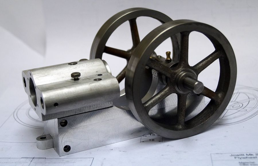

29/03/2020 09:57:08
Starting final assembly or at least to the testing stage prior to paint, first job is fill the frame ends and fixing holes to lose the made from bar stock look. Yes I know its wood filler but I have used it in the past on numerous materials, its good, quick drying, dosent shrink or crack and easy sand.
I also lapped in the exhaust valve this morning, the inlet valve seat is in the screw in brass inlet seating which is fine but the exhaust seat is machined into the cylinder body which in my case is aluminium. I noticed that there was some very slight chatter in the seat face so lapped it out.

I have hit a problem or at least I think I have, yesterday I honed the cylinder and managed a good finish from end to end. This morning I thought I would try the piston with the two O rings fitted to see how it was looking but it was way too tight. I checked the dimensions, the cylinder is 24mm at the crank end and 23.99 at the other, the piston is 23.95. The O ring grooves were spot on as per the drawing 19.4 dia and 2.6 wide and the O rings are to the size recommended.
I removed the lower ring just leaving the top one and it was a bit easier but still too tight. I bit the bullet and reduced the ring groove from 19.4 to 19.3 and it was a bit easier but still too tight so took the grove down to 19.2 and easier still and thats where I am now. Having no experience of this I dont quite know what fit I should be looking for with O rings. I can slide the piston back and forth but there is some resistance which I would expect but is it too much..?
I watched your video a while back where you showed a piston slowly creeping down the cylinder under its own weight, cant remember if that was an O ring piston but if it was mine will not do that.

A bit of an experiment that I hope will work, I have made a lap for honing the cylinder. I used a piece of wooden dowel on the little Muncaster cylinder which worked fine and I was going to do the same on the Jowitt but I have no suitable sized dowel or anything close other than metals.
So I have turned up a piece of 66 nylon to size and hope it will do the job, will let you know.
Well it worked fine, couldnt see why it wouldnt got a nice fit between the cylinder and piston I finished with 1200 grit so have a nice surface for the O rings to run on. I think I may well use nylon for any future cylinders.

The flywheels complete the parts list, now the fun begins or at least I hope it does..smiley
