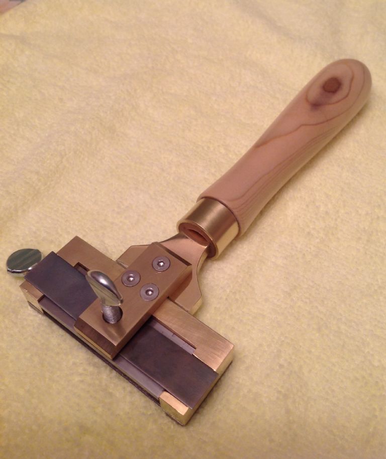

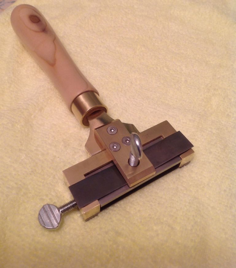

I've now completed this project. I ended up hand-filing the long edge flat. I'd have liked to be able to make knurled thumb screws, not use bought ones of the kind pictured, but I've no metal lathe to knurl with (or do anything else with) at present.
The tool handle is made from a Magnolia that I planted 22 years ago and lopped some branches off last year.
Perhaps the newest aspect of the project for me was hardening and tempering the spring steel (sold annealed). My technique seems to have worked in producing the desired elasticity, but I'm slightly unsure what the optimum tempering method is for spring steel, i.e. what colour to look for in the steel. Some say straw coloured; some say blue. I veered towards blue without managing to retain it exactly in the finished look.
Thanks again for everyone's advice.

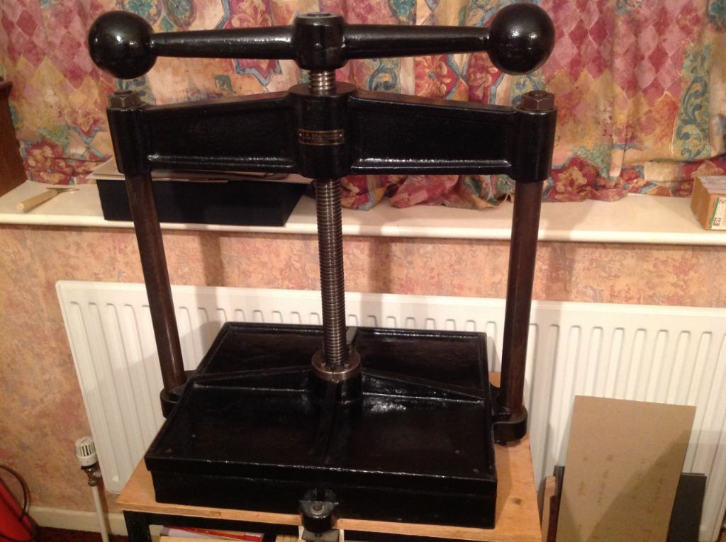

Just made these two large bolts for an antique book press that was fiitted with riser blocks so the bolts were too long.
This was my first attempt at a serious thread 7/8" by 9tpi, 36mm AF and it did not go without incident!
I decided to cut both threads using either end of a single bar; the first one went absolutely fine and I was very pleased at how easy it was!
Turned the bar around and did the scratch pass into the dykem and checked the pitch just to be sure. Started taking 5 thou cuts in back gear.
Halfway through the next cut or so I got distracted and turning round I must have caught the cross slide and accidentally wound on 15 more thou! Result was a big bang and my Tufnol tumbler gear disintegrated! Wrecked the HSS cutting tool also.
Got a new one a couple of days later and installed it. Everything else had been left exactly as it was so I carefully did a blank no cut run to see that the alignment was all OK.
At this point my brain deserted me as I reset the next cut at 2 thou to check alignment again TOTALLY FORGETTING that the disaster happened halfway along the work and I should have started the check cut at the high point to the left of the previous cut!
YUP, another bang and wrecked tool and tumbler gear!
Walked away in disgust for a day or two when someone on here very generously lent me a gear so I could finish the job while waitng for a new one. ( Thanks Brian! its on its way back to you!)
Some serious lessons learned and finally got it done.
I am now the owner of what must be the two most expensive bolts ever! blush
Cheers, Martin

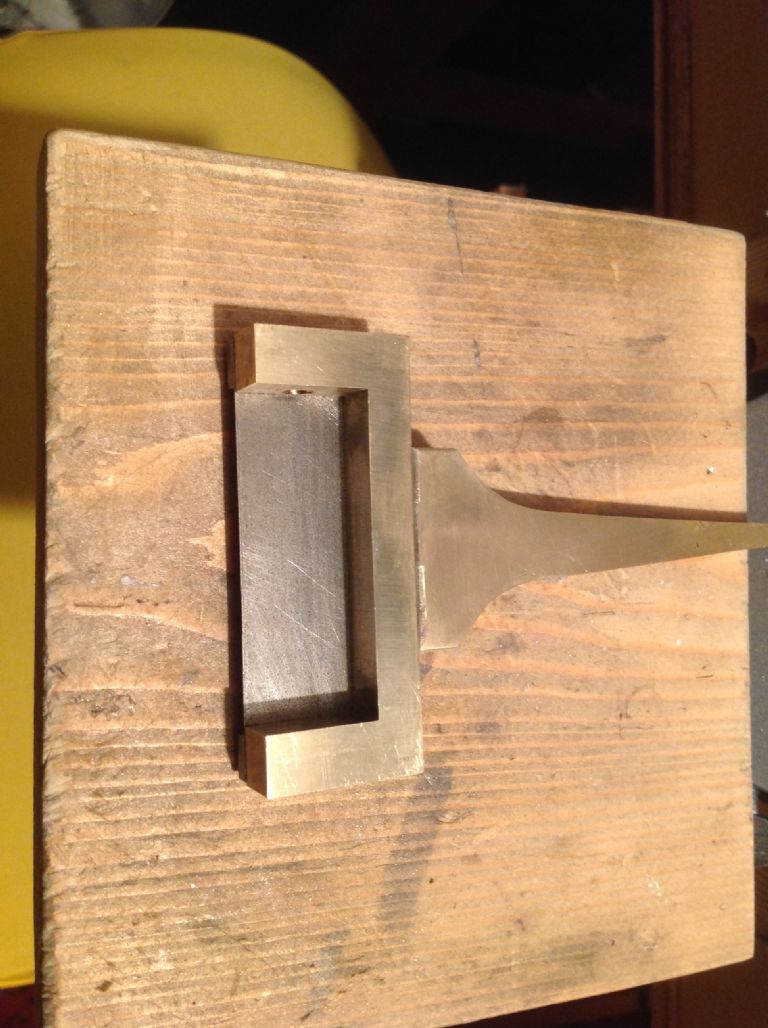

Many thanks to everyone for the replies.
Jason, I should have mentioned (my post was already a bit long, as this one is!) that the steel back plate is only mechanically fixed to the brass channel (with five CSK M3 screws into blind holes), and of course regardless of how small my mill is I can do this mechanical fixing after brazing. So your suggestion to file out the rounded corners after milling is even more practicable - provided I have the skill to file perfectly flat and square. There's the rub - almost literally.
Absolute flatness of the long internal edge is critical everywhere except, in practice, in the corner where the side screw comes in; here there is always at least some projection of this screw into the cavity, meaning that no type or spacer sits directly up against the vertical side at that end. However, at the other end, a finishing spacer is always placed after the last letter of the word right up to the stop to fill out the chamber, so things here need to be perfectly flat and square, no ifs or buts.
For brazing I used Easyflo flux and this solder.
Hence, using Keith's suggested "455" looks as if it would reduce the flow temperature slightly, so it might be worth a go.
Martin, your question is a crucial one. The temperature at which the type is worked on the book is probably no more than around 150-180 degrees C at any time. However, the tool has to be brought down to this temperature after it is taken off the stove by damping it on a moist pad, and in practice, in trade binderies particularly, so-called "finishing tools" such as typeholders are left on the gas or electric stove for long periods, even all day, so that they are ready for use almost instantly. This means that they can reach quite high temperatures. As a consequence, using a soft soldering process is fraught with risk, and using epoxies probably even more so.
This is one of the reasons why bookbinding type is brass not a lead/tin/antimony mix, which is what I believe most letterpress (i.e. printer's) type is. I do use letterpress type occasionally in a typeholder (it is much cheaper than brass type) but you do have to be careful not to leave it on the stove too long, or it will distort or worse. What tends to happen first of all is that the pieces that get too hot start to expand upwards (they can't expand sideways because they're trapped in), and they then become useless because they are permanently of a different height from the rest of the type. This brings us back to the reason why absolute flatness and squareness are necessary for the chamber of a typeholder.
I think this project has shown me the limitations of having such a small mill. Once I've got an idea where I can put it, a proper-sized machine beckons.
ETA: Martin, yes, these sorts of typeholders are always used by hand and usually across the spine of a book. If they are used on a flat board (i.e. on the cover of a book) you do have to exert considerable pressure to get a good impression - sometimes, for bigger font sizes, with all the strength you've got.

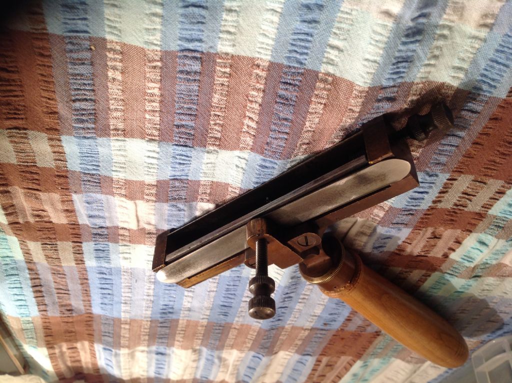

The images show two typeholders, one made commercially many years ago and one still in the process of being made by me.
As you might expect, typeholders like this are used for holding moveable type, but specifically bookbinding type, which is typically brass.
I milled the brass channel (about 2.5" long) out of brass bar, and would have liked to do this after brazing the shank on to it, not before, but since, in order to get square not rounded inner corners, this milling needs to be done with the open side facing upwards, and the tiny Proxxon milling machine I have doesn't allow me to stand everything upright once the shank is in situ, I had to mill the channel on its own before brazing.
The reason I'm posting this is that I noticed after I had brazed on the shank that the formerly perfectly flat, long internal edge of the channel was no longer perfectly flat, but was ever so slightly convex. I'm fairly sure this is a result of brazing with the open end facing downwards and the weight of the channel and shank being supported by the "arms" at each end. Essentially, I think the channel sagged slightly once it got to a very high temperature and stayed that way after it cooled.
My question is, if I do this project again but this time lie the channel down for brazing rather than standing on its arms bearing the weight of the shank above it, will the perfectly flat, milled long edge stay as flat as it was before brazing, or is there still a chance movement will occur?
