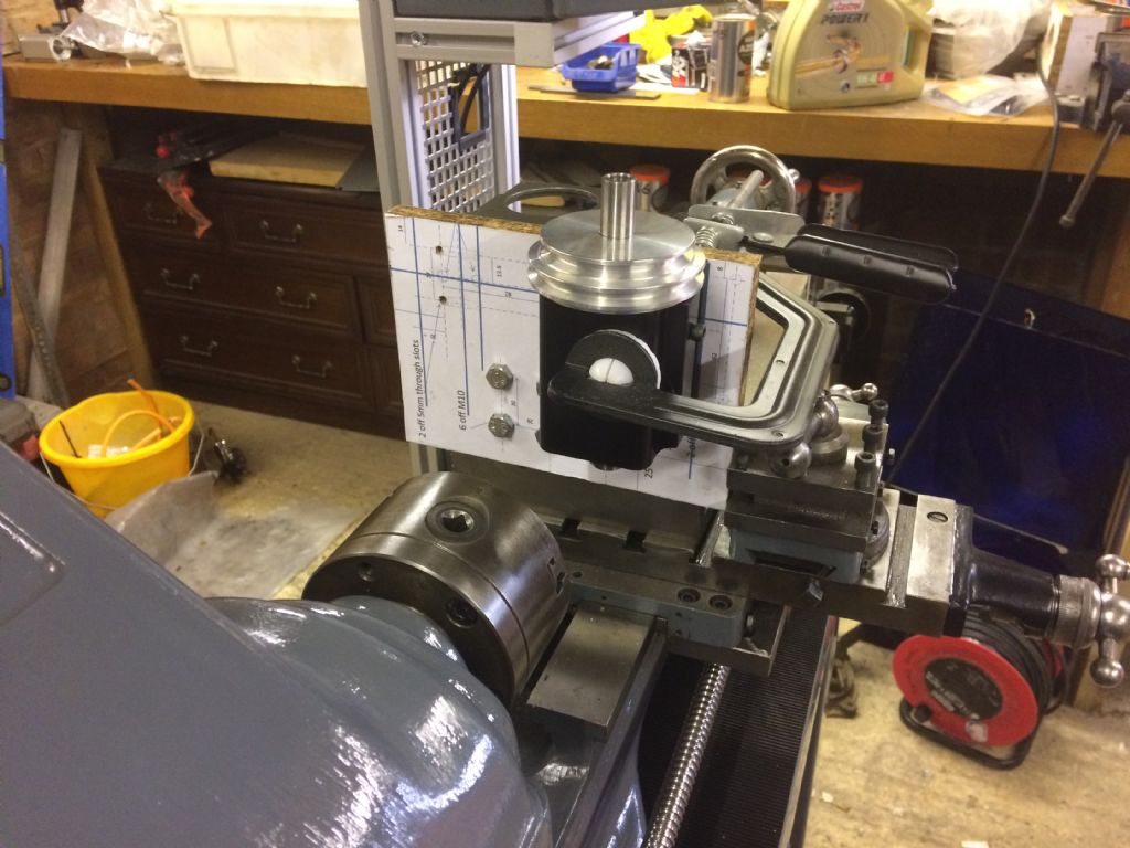

As you will see from the attached, I am an electrical engineer, but the drawings work. This is the main spindle cutter plate. I have also got a few other bits comming.
Still about 100 hours of work before I cut gears.
09/01/2019 22:42:49
Just sent drawings off to have spindle plate made. Made proto type in wood. Did not put slots in proto type as did not save the machine. Have to wait a week or so for the machine shop. 3 days design to make sure it was right!. Keeping fingers crossed. slots are for motor to tension belt.img_2238.jpg
