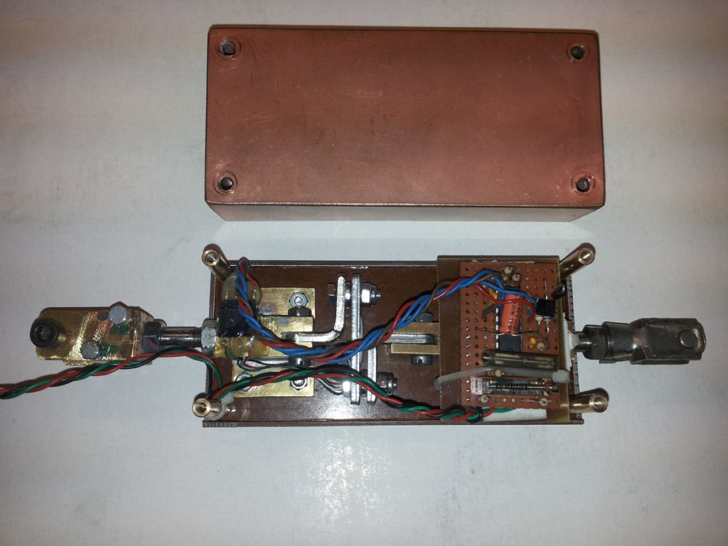

25/02/2018 12:46:45
Hallo Pete,
it is nice to see that I am not alone with my thoughts.smiley
Here are a few descriptions of my devices .
The data collection is based on a PIC 16F684 processor with 10 bit resolution. I have 7 analog channels and two digitals. 2 Channels are dedicated to Volt and Ampere the others are with flexibel input that mean 0 to 5 V input.With jumpers the Ampere channel could be equiped with a pre amplifier for a current clamp.
I want to have all modular ,because I want to build a test bench for my model aeroplane props and motors with the same unit. Temperature I can measure with a simple NTC resistor and with thermocouple amplifier type K.
The force measurement is based on a chinese luggage gauge. It spends the strain gage element. An instrumentation amplifier with faktor around 1000 amplifies it to the real calibration.
The pulse wheel is made with 12 magnets these give 6 Pulses at the hall sensor.
All is build on prototype boards and a 9 V accu can power it all for 1 hour as long as my android phone run in full power mode.
All is testet ,but I am waiting to make real measurement with better wheather conditions.
The pressure sensor is a cheap chinese sensor with 12 bar scale and integrated electronic. I will see how good a 10 € sensor could be when I have it.
At the moment the system can send 5 to 6 full data frames per second. For more static measurement it is good enough. And all is running on 9600 baud.
For an indicator I think the rate have to be increased. And a good contactles displacement sensor have to be used.
Here are some pictures for better understanding.
Data acquisition send via blue tooth to the android phone software
This is a graphic example
The force transducer
On the left side is the fixture to the waggon ,in the middle the luggage gauge and on the right side there is a mechanical guide to eliminate side forces. On top the amplifier.
By chance i killed one element .One wire in the middle was detached. So I was forced to order a new one
for 5 €.
The pulse wheel
The thermocouple amplifier with a cheap chinese element
I think it is a kind of overkill , but I hope I can find some room for further optimization.
with friendly regards
Werner
