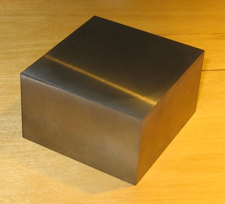

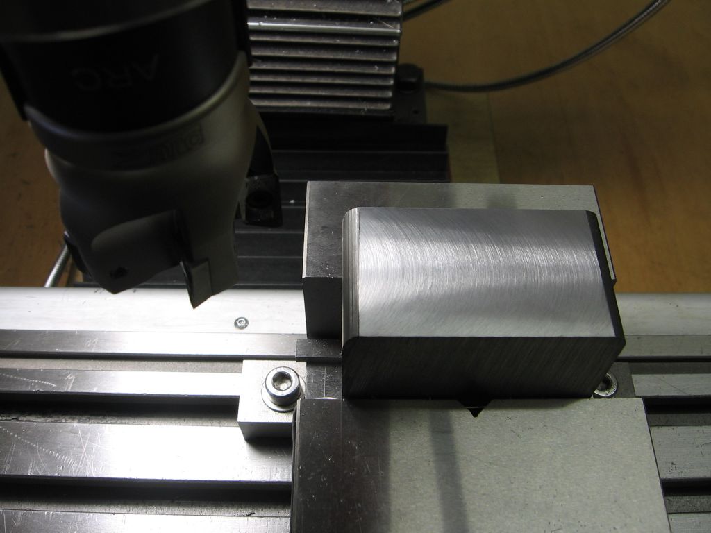

Well that went extremely well, no acrid smoke, no foundational tremors due to lack of rigidity, no rubbish surfaces due to insufficient power, and despite my trepidation as I entered the workshop this morning a rather enjoyable day all told. Starting with a 70mm sq by 40mm long piece of CI it has ended up 65mm by 69mm by 39mm high, which was by coincidence what I wanted. The 4 sides were done with a 5 insert 50mm cutter at 0.5mm DOC at 750rpm, the top and bottom with a 6 insert 80mm cutter at 0.3mm DOC at 700rpm. The swarf all came off as tight helical coils with very little dust which suggests the inserts were cutting well and absolutely no sign of stress on the machine.
It remains for me to extend my grateful thanks to everyone who contributed to the thread, especially Jason, the project moves forward a bit more. Now all I've left to do today is clear up the mess.

I'm after an opinion, I have a SX2.7 which swings a 50mm 4 insert face mill without any bother and gives a decent finish in steel and cast iron, so I think it's not stressing anything. Does the panel think it would take an 80mm 5 insert face mill comfortably? I believe Jason has one this size but thoughts are always useful. I know 63mm is available but I need to face a 70mm block and the finish invariably looks better if it can be done in one pass.
