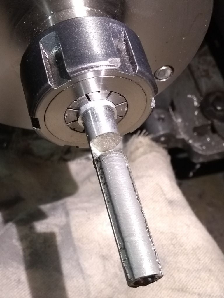

Have 3 plain nuts and one ball bearing type tightened as much as I can using standard spanner. Scenario 1 is when I make a holding 'jig' to lap a piston. I turn 1 end to usually 15mm perhaps in a 3 jaw, then that end into, usually 15mm collet/chuck, and turn to suit piston and finish for pull rod. Next time I use it perhaps using another chuck and nut there is a degree of run-out, not to much of a problem with a hand held lap. Scenario 2 today was with the liner for a Holly Buddy engine. Turned 1 end down to 16mm this time in 3 jaw then that into collet chuck and turned the diameters leaving extra length for parting off. Put that onto a ER25Stephenson square block held on an angle plate and drilled for transfer ports and cut the exhausts. Back to the lathe and run-out was 1 thou, not as bad as seen previously, so bored the liner at that, came to part off and the run-out clearly showed when blade presented to the liner. Think I'll do some tests as suggested then and keep 1 nut to each chuck which can sometimes be difficult if using mill to drill holes working way up the sizes on multiples of same item but the devil drives.

Clocked both types of my ER25 chucks in the lathe and they're all with 1/10th of a thou. ........But if I mix the closing nuts (I have 4) and use another nut to that I used to turn something then I have up to 2thou runout. Did think that they would be interchangeable. What's the general thought on this?

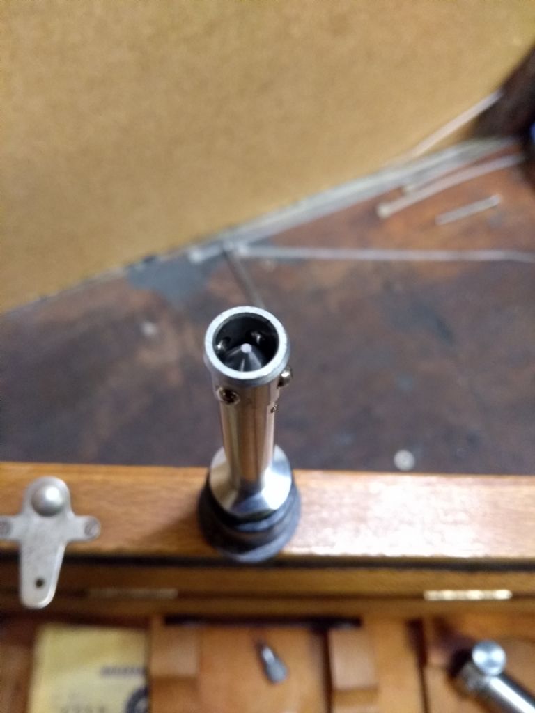

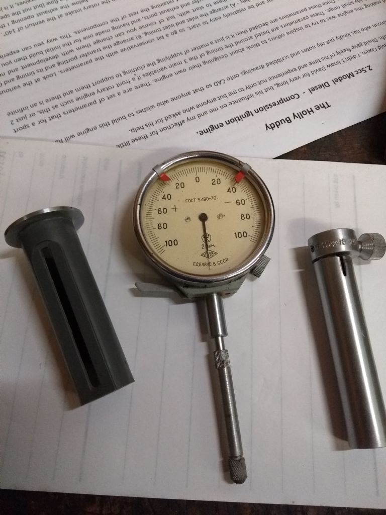

Hi Kiwi. I/we do use it basically as a comparator but it is capable of measurement, that is what it's designed to do.

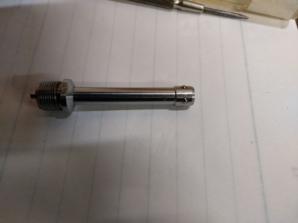

All 4 contact points (balls) move and are in contact with a central precision? made tapered spindle. I'll take pictures of a 'probe' and post later and perhaps you can tell me whether the design is superior or not to the 3 point type, which as you say are much more expensive and unless you have a no expense spared approach to model IC engine making putting them outside what is reasonable, in my opinion, to spend, Also I didn't want a micrometer (barrel) type as I wasn't confident in getting repeatable readings as all mikes, again in my opinion, depend a great deal on feel. For example measuring a liner with an ordinary inside mike I can get readings that differ by a thou maybe more taking one reading after another, heavy handed or what but it caused problems for me doing it that way. Also ball and telescopic gauges gave differing results so a decent dial bore gauge, economically priced with micron capability, looks good from here.

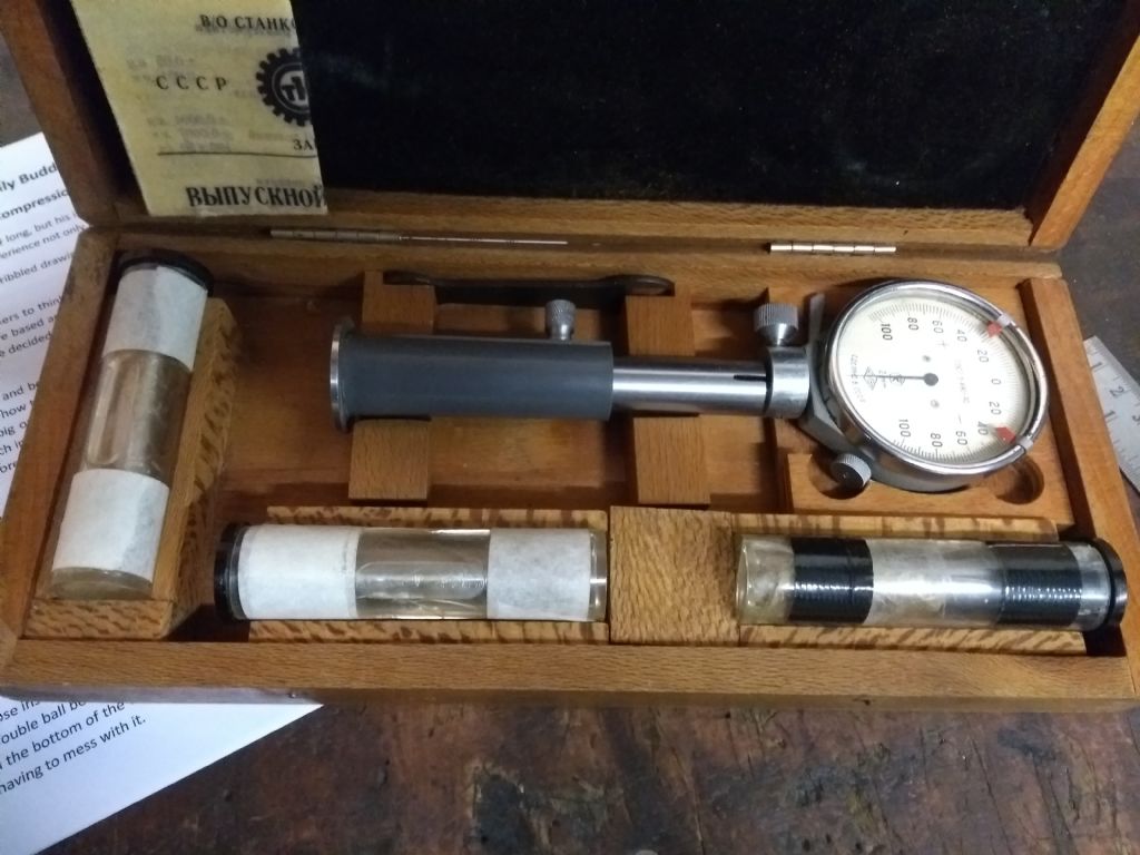

Don't need a setting ring as just trying to find the difference between top and bottom of any liner. Choose 1 of 3 'probes' to suit bore set reading at one end to zero and then measure other to show the difference + or - basically a comparator, if you need a setting ring the guy has all sizes though quite costly. Was told by one who knows that the 4 point was superior and used by all the top combat engine makers (Ukrainian/Russian)and easier to use and so far I've found it easy to use. Was only 100 dollars delivered, they do like dollars, he had others that were cheaper. Searched online after only finding ones that didn't have the required scale and they all looked well used, pricey and used a different system to measure which looked clumsy.

Chuffed today received a Russian 4 point Bore gauge, all the way from Bulgaria of all places, measure down to 2 microns in the range 10 - 18mm which covers all engines I'm likely to have an interest in. No guessing now as to how much pinch I've managed to get when lapping liners. Made a new liner for an AM 25 last few days, gauge saying 25microns pinch so well pleased

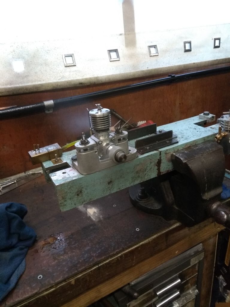

This is the cylinder lap that I used as recommended by John A, Piston lap is similar to that I used Tug but will try John's suggested method with an AM25 piston this time around. Needle valve jet hole was to deep, almost 0.090 past cross holes so will make another one tomorrow.. Wish my drgs looked that good Tug, foolscap and sometimes a ruler is the best I can do LoL

Hello John, was turned away from going the speedhone route as I was informed that it was impossible to get the required 'pinch' near TDC in the liner using one, do you not bother with trying to get that slight taper or is there a way of doing it using a Delapena type? I have something similar to your second photo, built from a kit supplied by a company near Long Eaton whose name eludes me but it doesn't go down small enough to do these small pistons. Up to now have made a circular hand held external hone to a design I found on the web for each piston which is time consuming, using an Alum split collet type would appear to be much quicker and so bought a mini lathe to do all the lapping on
