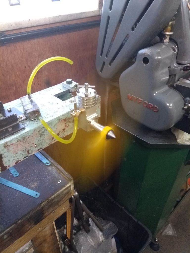

Hello Tug, did make a pair of Holly Buddys, one beam mount and one radial as per plan, got those running no trouble, quite taken with them as engines but now more focussed on my bikes for the moment, might go back to the Boll Aero at some point. Did read the link and it's somewhat surprising that many of us have trouble with a simple side port engine. Did experiment with the nva and choke size after some advice from Dynosaw but to no avail.

Hello Keith. Sort of lol. Got it to run once only a fuel tank full of fuel after flicking away for what seemed like hours, let it cool down then tried it again and couldn't get a squeak out of it. Walked away to have a think about it but got side-tracked with one of my Velocette motorbikes, Think the piston fit is still not good enough though I have made 3 pistons now, Will have another go when the mood takes me, haven't had this much trouble with any of the other engines I've made or refurbed. You haven't posted in a while have you, what you up to now?
