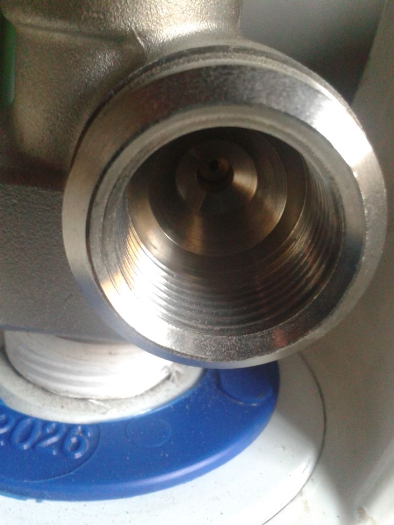

Measured the thread on the cylinder valve and took some pictures to explain better. The pitch for the internal thread is 14tpi similar to bsp, internal diameter (this is the minor diameter) 22.5mm
Now while googling for this thread I came across a CGA 580 which apparently is used for inert gas cylinders in the states, the pitch for the thread is 14tpi as well but could not find any dimensions.

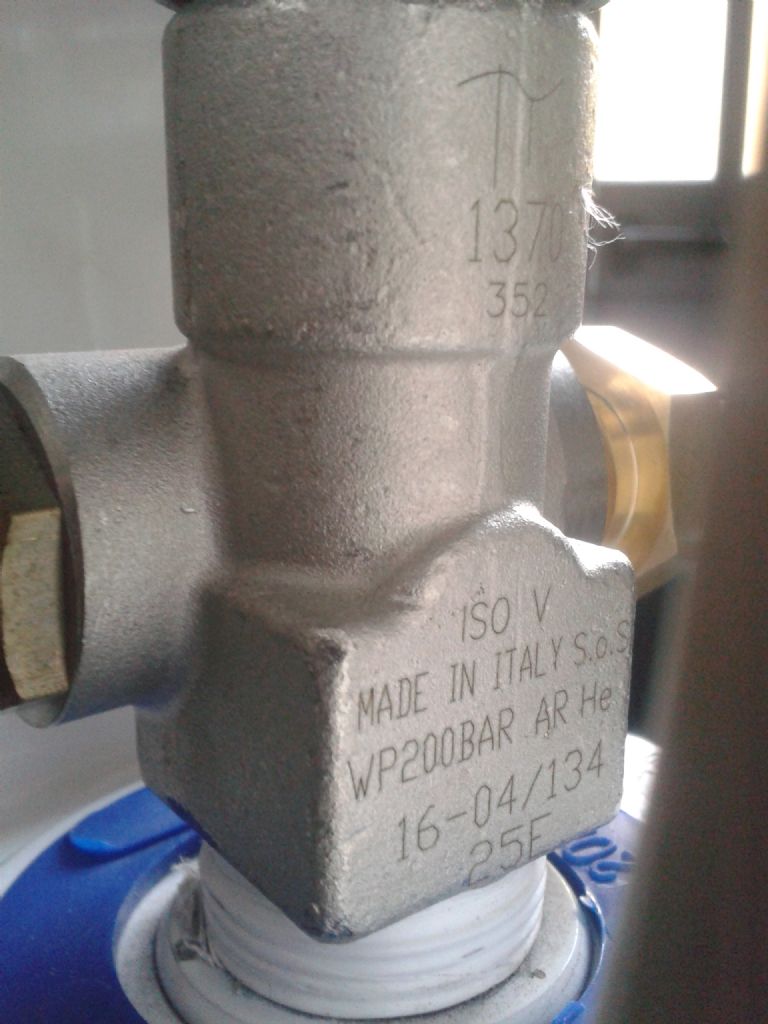

Markings on the cylinder valve

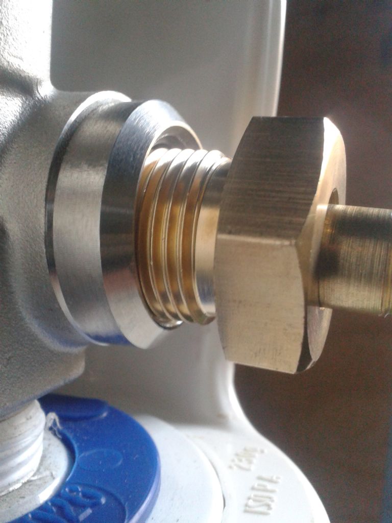

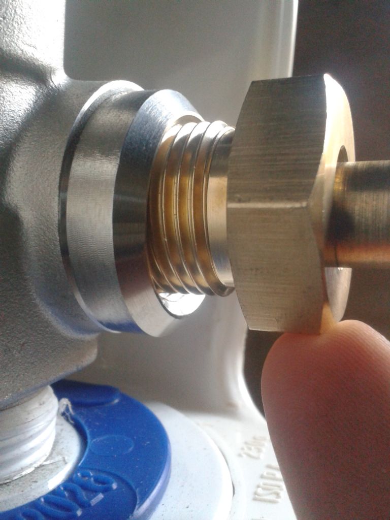

Internal thread and seat on the valve, as you mentioned Jason the regulator connector is rounded and does not seat properly.
Wobbly down
wobbly up

But isn't the BSP and G thread one and the same? The one on the cylinder valve was very close to 5/8bsp, infact the regulator 5/8 thread did engage but was too wobbly... it must be some thread which is very close, I'll try to measure it.

The problem is the thread on the cylinder valve, it's close to 5/8Bsp but slightly larger. On the valve there were some markings and number but googling them didn't yield any meaning ful results. This is what's on the valve:
ISO V
WP200BAR AR He
16-04/134
25E
1370
352
Made in Italy
As it's got made in Italy on it I'm assuming its built to a different standard? I need to identify the thread on the cylinder and try to find an adapter or a new regulatorangry
