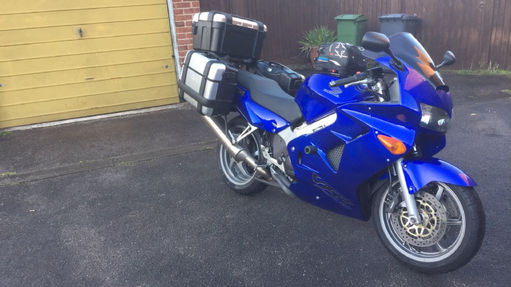

19/02/2017 21:47:06
This is my boringly reliable machine. Thing is, it's anything but boring!!! I'd just got back from a weekend in Germany. Love my old VFR.
