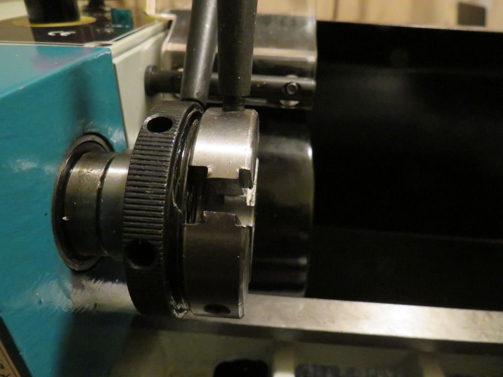

Dear All, Success at last. Only taken me 4 hours! You've all been legends.

07/11/2016 18:07:22
Posted by Neil Wyatt on 07/11/2016 17:52:19:
Are you pushing the jaws inwards to get them started? If not the end of the scroll will jam against them,. likely as not.
Thanks Neil. The scroll was indeed jamming the jaws. Now all jaws are doing up but 1 appears off centre to other 2 jaws. Swap jaws around maybe?
07/11/2016 17:53:22

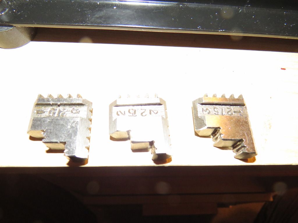

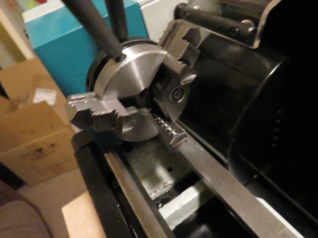

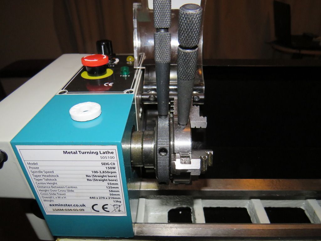

Pic1: As far as they go.
Pic2: Same. But showing the 2 levers for closing the chuck. Not knuckle friendly when adding a touch of grunt!
Pic3: Some signs of wear....and I've not turned it on yet!
Pic4: Numbers as clear as mud!
Yes I know I should of left well alone but I had a piece of ally tube to practice on and thought it safer to reverse the jaws and grip tube from inside. Best laid plans of mice....etc

07/11/2016 16:57:45
Thanks both.
Have found numbers on jaws but none that I can see on chuck to correspond.
Jaws have all gone in so far and stiffened up. No chuck key btw, this is operated by two punch shaped levers. One for the chuck and one for the scroll(?).
07/11/2016 16:12:27
Having took receipt of my first engineering lathe I have tried to reverse the reversible jaws supplied in the chuck and don't seem to be able to put them back in!
SWMBO is giving me discerning looks as she knows just how many shekels this has cost. Help please if there is a technique or order of process. I cannot even put them back in how they was! Nightmare!!
