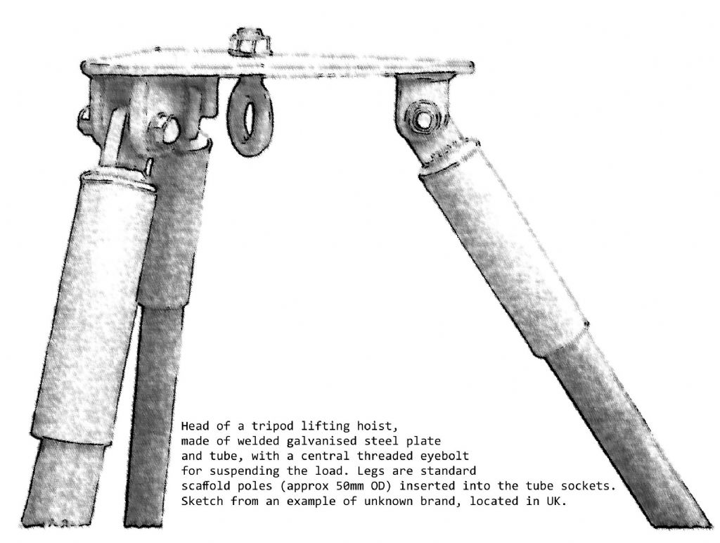

06/08/2018 08:35:23
Here is a sketch of the scaffold-pole tripod head that appeared in a second-hand advert, mentioned above.
06/08/2018 00:18:28
I had a google around for images of 'scaffold pole tripod', 'tripod hoist', 'tripod lifting crane' etc.
Here are just a few of what to me are the most interesting results, showing the tripod head in commercial products of about the same type we have been discussing:
Vestil:
https://www.vestil.com/products/mhequip/tripod_hoist_stands.htm
Cisco-Eagle:
http://www.cisco-eagle.com/catalog/product/166339/aluminum-tripod-gantry-crane-1-ton-cap-8-7-max-lifting-ht
Lifting Safety UK:
https://www.liftingsafety.co.uk/product/aluminium-tripod-crane-1000kg-3090.html
Unknown brand:
https://www.preloved.co.uk/adverts/show/114580540/lifting-tripod-head.html
To me the first two websites both from USA) show the most interesting design of tripod head. Two different brands (Cisco-Eagle and Vestil), but similar thinking. The Lifting Safety UK design looks for difficult to fabricate but this is a UK forum so I've linked it.
The last image is from a current UK second-hand advert, (the link will die fairly soon so take a screenshot while you can), but is possibly most like what various participants in this thread here might be thinking of, and is also very interesting.
All seem to use a threaded eyebolt for the suspension point. Note also the style of feet on the US designs, and the use of an anti-spreading safety chain or rope, either at mid-height or at the feet.
I think its great that MEW will take a second look at design of this handy type of equipment, and I'll be interested to see what Neil comes up with.
Although I suppose I've been contentious and offputting for a first-time poster, I won't be convinced that the bar for safety on lifting equipment is anything but high, and any diy construction or design discussion needs to reflect that.
Edited By Ian Austin on 06/08/2018 00:25:22
